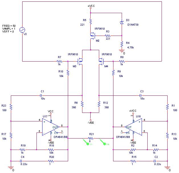

I'm working on OPA1632 and OPA541 amp. I've already made a PCB and in few days time I'm going to test it.
I need to listen the sound of design. Please write down in this thread when it's finished.
The input impedance seems to be 1k. This won't work well with the 10nF C4.

After a long hiatus from DIY'ing I finally got back to working on this project over the last couple of weekends. I built a new regulated power supply, hooked up the amplifier circuit leaving the inputs disconnected (i.e. floating) and turned on the power. There was between 1 an 2V of DC offest at the outputs, so I tried again after connecting the inputs, positive and negative, to ground. This time there was 10mV DC in the left channel ouputs and 25mV on the right. I only have my multimeter as a diagnostic tool, so I hooked up some old speakers and had a listen. There was hiss from both channels at the loudness of a quiet conversation, and the right channel had some hum that was just audible when standing a few feet away from the speaker.
Next I measured the voltages across various components in the circuit, and they were more or less the same as the spice model predicted. One strange thing happened while I was doing the measurements. If I measured the collector to base voltage on any one of the BJT's in the differential pairs, as soon as the probes were connected the hiss and hum dropped to very low levels in both channels, even though I was only measuring one BJT from the differential pair in one channel.
Obviously I have some stability issue that is causing oscillation in the circuit, but I am not entirely sure what to do about it. At this point my plan is to sleep on it overnight, and if no-one has any better suggestions I'll try adding a bit of capacitance between the collector and base of each BJT and see what happens. On the other hand, suggestions are most welcome.
One last thing, but I don't think this is the source of my troubles. I cheaped out and am using ZTX450's instead of MPSA18's. I know they are more noisy than the MPSA's but I thought for prototyping purposes they would be OK.

I expect that you would encounter stability issues with such
a topology due to the very high open loop gain of the chips.
I doubt that the choice of NPN bias transistor has much to do
with it.
I suggest you start by "throwing away" open loop gain in the
manner described by the first of the "Seven Easy Pieces" thread.

Really??? It's a good news for meLooks good enough to me.
Yesterday, I tried to simulate this schematic again and it's indicated a fair result. I'm wanderring why I got the different results from the same schematic Maybe I must check the simulated software (Pspice) again.
