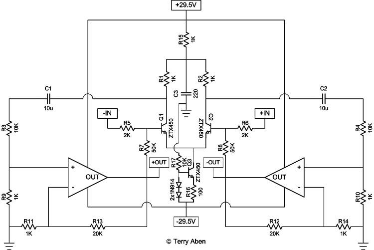

I attempted throwing away some gain this weekend, using voltage dividers after the differential pair to drop 6dB before the LM3875's. There is still a stability problem, although the amplitude and frequency of the oscillation seems to have decreased.
Nelson, any idea how much of a reduction in open loop gain will be required to stabilize these circuits? I need to place an order for resistors to continue and was wonderng if you had any insight as to a ballpark figure...

OK, tried my last set of suitable resistors before I have to order in more. Have thrown away 15.5db of gain, and things have improved again, but not there yet. With no signal at the inputs, the outputs (positive and negative speaker outputs) are reading about 1V above ground. I can play music, but it just doesn't quite sound right, very hard sounding. Lastly, when I switch the volume (using a stepped attenuator) I get a bloody big pop each time. I think my next attempt will be -21dB.

I have been quite surprised by how much gain I have had to "throw out", much more than I expected. But then again, I was warned.
originally posted by Nelson Pass
One of the key issues is the enormous open loop gain of the
chips, which can give rise to some difficulty.

Eureka! It's alive.
At last a working circuit with no apparent problems. No hot chips, no clicks, pops, strange voltages, nothing that I can tell is wrong. Plays music quite well too, although I have only tested it with my portable CD player and el-cheapo bookshelf speakers. Is this circuit optimal? I have no idea, but it does work.

Can I replace ZTX450 by MPS6602 or MPSW01A? ZTX450 is difficultly find out in my country. For current source, I will use MPSA18 as Mr. Pass diyopamp article.

Very much intersted in. If the top sound is too sharp, I'd have RC network from the output to the ground--e.g. 10ohms and 0.1-0.2uF. I really look forward to further hearing from you. Regards.

You will want those networks regardless.
