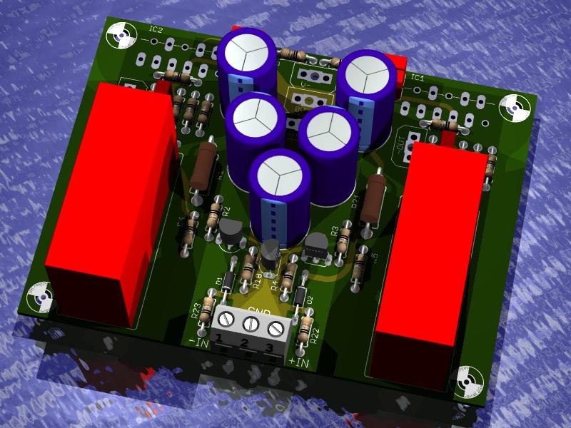

Here is what I have so far
I think this is pretty close to going to the PCB FAB. 🙂

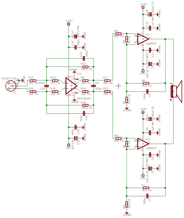

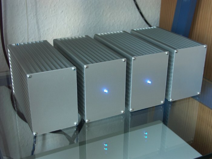

My HF stage of BiClone is finally finished 🙂 works better than I ever expected. It is good to have not big gain on LM3876 because of audible noise over 10x. So, I set 10x on OPA1632 and only 2x on LM3876 - this configuration produces any audible noise from speakers 🙂 there is not possible to hear if the amp is switched on or off even in 1mm hearing distance from tweeter to your ear. First two finished amps are only to drive tweeters) - bass amps comes when I will have short time to work on them.

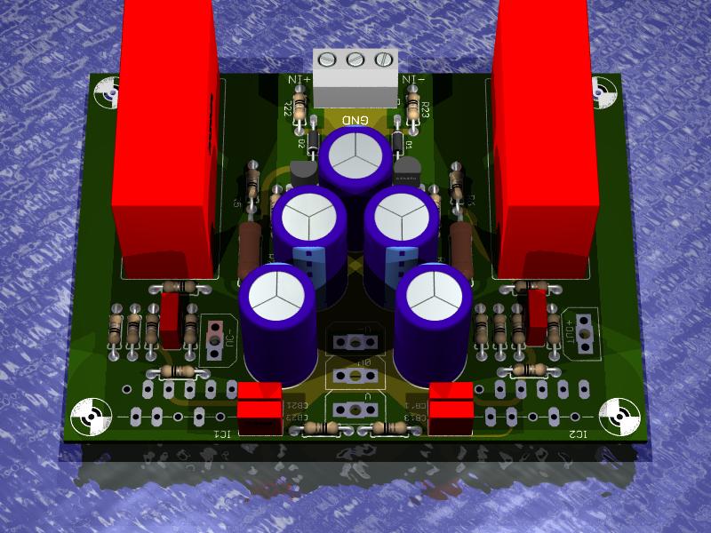

Well... got my PCB's.
I'll be able to try an X'd 3886 and an X'd 4780 (the latter being a pair of 4780's with the chip itself paralleled). Will also run stand-alone (chip boards are complete circuits).
Top left is a bridge board only so I can run two regs off one bridge. Bottom left is the 3886 board. Top middle is the bridge board. Lower middle is the regulated PS boards. Right side is the 4780.
Power boards are 3"x3" for size reference.
We'll see if I blow anything up now! 🙂

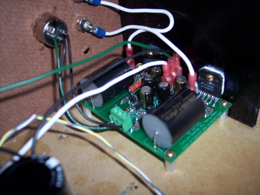

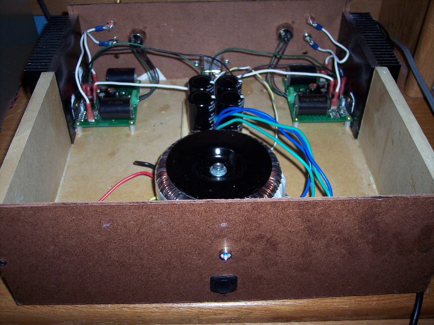

SuSy amp up and running
First stereo prototype in my ugly prototype case is up and running and sounding excellent. No DC offset and no bad habbits to be seen yet. The music sounds, well great!!! 🙂
Note, I did not use the zobel, partly because my speakers are an easy load, and partly because of a design oversite which would have made them hard to fit on the PCB. Good thing these are prototype PCBs. The final PCBs will have several enhancements based on things learned from the prototype.
The power supply is unregulated and powered by a 2 x 20V 500VA trafo.
A special thanks to Ed for the PCBs. And a toast to Terry for his excellent work and incredible support. Of couse thanks to Nelson Pass for sharing the idea with us.
I will post more details later, but for now here is a picture.
