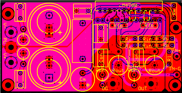

And, the LM4780 board.
one per side. Cap from the bridge board to signal input, wire from the ground out on the bridge board to IG. wire from OUT to the SL (same side as the signal to this amp board is taken) on the bridge board, and to one terminal of the speaker.
OG is ignored/unused, and R1 is not filled.
This board layout has also been revised, such that it can now take two discrete inputs and have separate outs, OR can have one input to both and the outputs joined back up to create a parallel setup.

:bawling: I can not figure out why mine is so quiet. I tried swapping leads into the X-BOSOZ and no change in output at all. I must have a resistor in the wrong place somewhere or something - at least I was consistent about it! 🙂 I tried swapping leads into the X-BOSOZ and no change in output at all.

Well, I've verified all the component values. So I am at a loss on why things are so quiet. On the parallel amp, I *am* finding that, of course, many resistor values are about half since they're all ultimately "shared" at the input - not sure if that makes much difference for the circuit stability. I've tested with the 3886 as well as the 4780 though, and both are quiet.

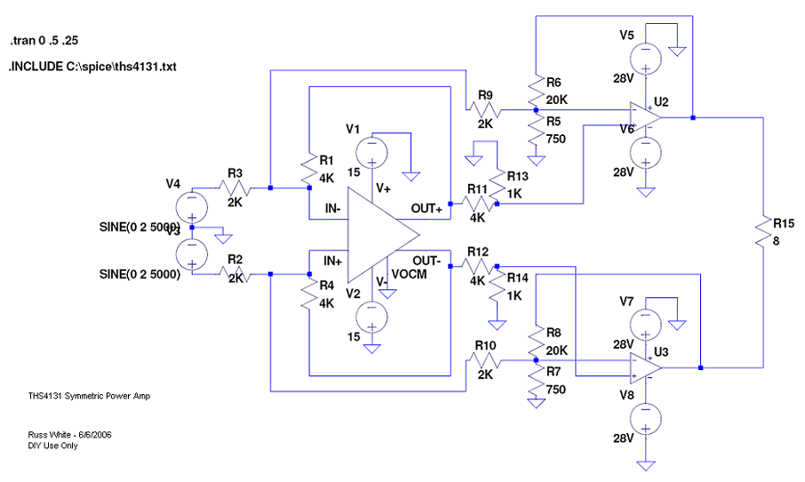

Some more musings
A while back it was proposed that the THS4131 and its family might work fine for this application, and Nelson seemed to agree that it should.
I am thinking this could be the answer to a couple of key questions I have.
Terry's circuit sounds absolutely fantastic, but I think it would sound even better without the feedback cap or an input cap. Unfortunately you seem to really need both.
So I did a little digging and came up with this, which is very similar to what I had seen earlier.
I have plugged in values for the resistors, but I am not at all sure they are sane. I would sure like some feedback from you all as to if they look like they will work, or if they could be better.
I am shooting for a voltage gain from the circuit of ~22X.
Areas of concern....
1) Are R7 and R8 values too high? Just seems like a high value for a current feedback opamp to me. Is it OK? Will CMRR suffer?
2) R3.,R4 and R5/R6 are there to isolate any parasitic capacitance from the THS4131 and give the non-inverting input of the LM3886 a GND reference. Am I on the right track including them, and are the values OK?
Here is the schematic as a PDF.
Thanks!
Russ
Russ,
First off, great to see you continue the initiative in this area, and a good start so far. I (finally) got a chance to look at your idea a little closer, and I agree with your thoughts that R1 through R8 will need some adjustment.
Let me start by commenting on R3 - R6. For the values you posted, I am pretty certain the circuit will be unstable.
In my (non-THS4131) circuit, I had about 150dB open loop gain, threw away about 25dB of gain with the voltage divider network, leaving approximately 94dB of feedback to produce 29dB gain closed loop. Any more feedback and the circuit stability went to H E double hockey sticks (a Canadian pun for the devil's abode).
The THS4131 has 90dB open loop gain, and the LM3886 has 115dB open loop gain, for a total of 205dB open loop gain for your circuit. Your closed loop gain is about 27dB, and you aren't throwing any gain away, so your feedback is 178dB. Because the THS4131 is an IC and is also unity gain stable, you can probably get away with more feedback than the 94dB limit of my circuit, but I doubt it will let you go that far. Also, the LM3886 likes a bit of impedance feeding its input, around 10k-20k. So, I would suggest a starting point for prototyping would involve throwing away around 20 dB of gain, with R3|R4 = 10K, and R5|R6 = 1K.
On the input side of things, the datasheet for the THS4131 tells two different stories. In one area they say the input capacitance is only 4pF and the input resistance is 34Mohms, which indicates that relatively high resistance values would work for R, R2, R7, and R8, but on page 19 there is a table that indicates R1 and R2 should be around 400R, and R7 and R8 should be around 4K, then on page 6, Figure 1 they show a value for R7,8 of 4K. A bit of a hodge podge going on.
Based on what I see in the datasheets, I think (if it were my decision) I might use R1|R2 = 500R, and R7|R8 = 10K. That should still leave the input impedance somewhere around 20-30K, and give the circuit good performance.
I'l wrap my suggestions up with the statement that when I was developing my circuit using the ZTX450 input transistors, it took me about 30 or so iterations of trial and error trying different resistor values to find workable values for the input, divider, and feedback resistors. So don't be discouraged if it takes some time to find the right combination. I think you are on the right track to finding the newer improved GC Supersymmetry circuit.
Terry

Trying to do my homework....
Ok So I have done some quick calculations lets see if I am way off...
Lets assume 1V input.
The input is attenuated to .1V(1K/10K) then amplified by a ratio of 23.1 to 2.31V by the LM3886 which is then applied to the opposing input of the THS4131 which should result in a total gain ratio of 2.31 x 20 (10K/500R) giving a total cct gain ratio of roughly 46.2V, or about 33.3db.
Did I figure that out correctly? Or am I totally missing it.
Now, that seems(assuming its correctly firgured) like a wicked huge amount of gain to me. I don't need anywhere near that much. So I was thinking more along the lines of 20db.
It sems to me the easiest way to get to around 20db is to reduce R7/R8 to 2.2K which should bring it completely inline with the datasheet for the THS4131.
All of that is assuming my calculations are correct, which is no safe bet. Any thoughts, or pointers?
Thanks.
Russ
Perhaps this?
Well here is my pre-breakfast crack at the circuit. I lowered some resistor values a bit, and I put notes on the schetatic to show my train of thought. Now hopefully people can see clearly how I am calulating things and let me know if I am right or wrong. 🙂
One big question I have is how did you figure input ideance Terry? 😀 I can't seem to figure it out. It seems to me the input impedance will be 402ohms in my circuit, but you see to think it will be much higher. Can you explain briefly describe the forumla for calculating Zin on this circuit? :scratch2:
