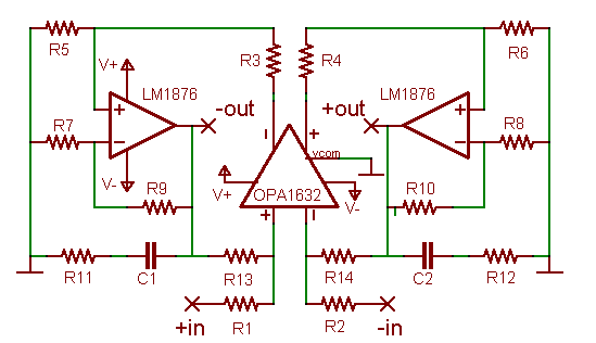

What about a full opamps amp ? We know the OPA1632 (and THS4130) is using a x-topology. It would add some (a little) complexity in the PS, since we would need to regulate the PS to +/-15V for the OPA1632.
