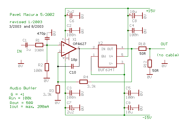

Gcollier said:Here is the basic schematic that I followed (this came from another post...and is not my design). I added a DS1802 on the input...the circut for this is very simple and should be obvious from the PCB. 😉 If you would like I can post the Eagle files.
BUF634T has a x2 on it is that mean they are stacked on top of each other ?
The opamp has X1 on it, it's just the naming, IC1=X1, IC2=X2

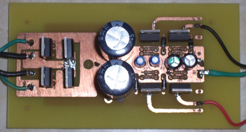

I'll work on adding the component names tonight then I'll post the file. I already have a regulated PSU for this board...but I'm sure it could be made better with a little help, I'll post that too. You can see a photo of it in one of the previous posts in this thread. My supply uses LM317/337 regulators that can supply anywhere from 1.25 to 37V. Looking at my design it could probably use a little bit better decoupling, so I may make a few mods here and there. I'm using ISLR860P2 diodes which are a 2 pin TO220 case and are pin compatible with MUR860's.
As for the preamp board I may move the outputs toward the center of the board to shorten the traces.
So until tonight...heres a shot of the PSU 😀

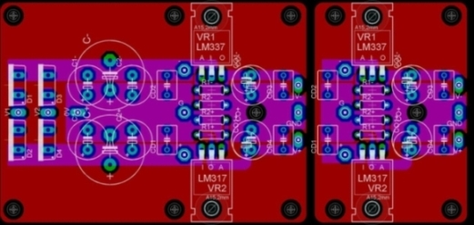

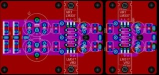

Steeno, that regulator board that I posted earlier used one set of regulators to provide voltage to the opamps, the second set is for the +/-2.5 V for the DS1802. I am certainly intrigued by the idea of using a discrete regulator for the second stage on the opamps. I wonder If I could adapt that to the newer PSU board that I have been working on. I attached a photo of it. The board to the left is the "lower section". This contains the rectifier and resevoir caps, while the board to the right is the "upper" board and contains only the regulators and necessary caps. The boards would attach together with mounting posts and screws through the four holes in the corners and possibly between the output caps as well. The three round pads just left of the resistors and regulators are used to feed the supply from the bottom layer to the top. You could use heavy guage wire for this, but I was thinking that machine screws or standoffs could also be used. This is actually only a single layer design, I was planning on using the top layer as a heatsink to cool the regulators...obviously with some conductive insulation between them.

I didn't see that on the pic. Mayby I should have payed more attention on the thread?? Nonetheless, Voltage regulators are noisy! I have made a few supplies and the best way I tried is the regulators followed by a discrete one. Here is Alcaids regulator:Steeno, that regulator board that I posted earlier used one set of regulators to provide voltage to the opamps, the second set is for the +/-2.5 V for the DS1802.
http://www.diyaudio.com/forums/showthread.php?s=&threadid=49619&perpage=10&pagenumber=8
Here is Nuuk's LED regulator:http://www.decdun.fsnet.co.uk/gainclonepre.html#gcprepsu2
And this is how Nuuks look like in life:http://www.diyaudio.com/forums/showthread.php?s=&threadid=49619&perpage=10&pagenumber=7 Go to post 68 and 69. A discret regulator really filters out any supply noise🙂 🙂 I have also made discrete regulators on poweramps and headphone amps running ClassA, It really takes care of the noise😉 But ofcourse, you can try your PSU as it is, mayby it will work🙂 Just making suggestions for better sound😎
Steen.
BTW. If you want to implement Alcaids reg. just cut out the sch. from after the big 2200 caps and attach it to the end of your LM's after the snuppers 🙂
