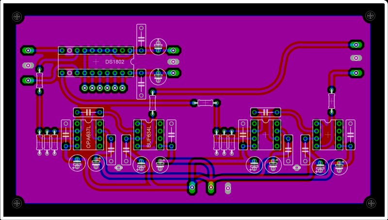

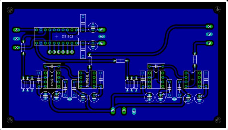

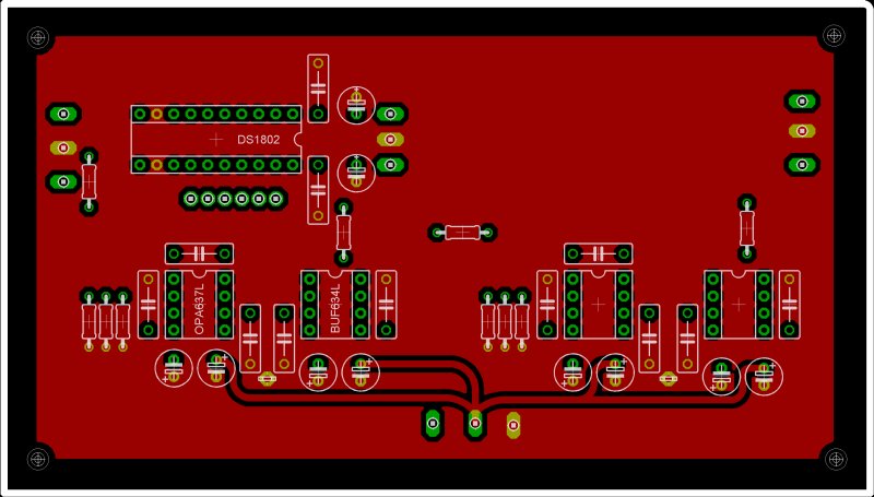

New Layout Plans
Ok,
So I haven't got around to actually etching the board that I posted at the start of this thread...but I do have a revised layout for two channels, with an integrated DS1802 volume control. Please take a look and offer any suggestions for improvements. I may just abandon my initial Class A thought, I'm not sure it would really improve the design any. So what you see here is nothing more than 2 channels of the Pavel Macura design, with a DS1802. The input is at the left and output at the right of the board. Power connection for the DS1802 near the top (+/- 2.5 V) and the rest is at the bottom (+/-12V).
Ok,
The Top
Here is the top
As you can see there is a groundplane on both sides, these are connected together with the vias near the decoupling caps. I had to do it this way since the ground on the bottom near these caps ended up being an "orphan".
Looking forward to any suggestions!
Here is the top
When you guys talk about the OPA637, you are referring to the AP or BP version. I assume AP. I saw L on the board layout, but there is no L version, according to TI.
It means Left, none of the chips for the right section have lables
I.e.:
OPA637L = Left channel opamp
OPA637R = Right channel opamp

I dont know, you can't tell, but AFAIK the BP version has better input voltage offset and the specs of both of the chips are quite different,.
Check out the data sheet
You will also notice that the BP version is usually priced higher, due to the better spec.
But you wont be able to HEAR the difference.
Hope this helps
Craig
Hope this helps
Craig
n00beR said:I dont know, you can't tell, but AFAIK the BP version has better input voltage offset and the specs of both of the chips are quite different,.
Hope this helps
Craig
As far as the circut goes the choice of chip is insignificant, although I am using the BP version. And Yes L is for Left, I got lazy and haven't labeled all the components yet. I will also be trying this same circut with some AD843's which also have a nice "clean" sound IMO. The choice of input voltage is entirely up to you. I plan on etching this design very soon I will let you know how it turns out. 🙂
