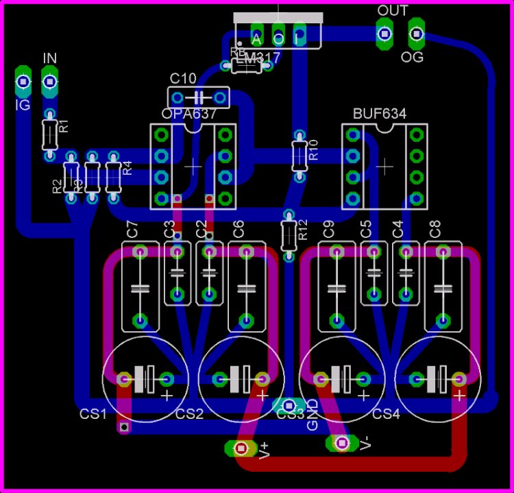

Anyway looking at the LM337 data sheet the current is actually going to the input of the LM337. Anyway, I have modified the layaout, and replaced the LM337 with an LM317. The output goes to the Vin on the LM317. If I use a 100 ohm R from out to adj on the LM317 I should get more or less 12.5 mA of bias current. As steeno suggested this may be a little high for the BUF634 DIP8 this is all I have to work with for now...so I'll just have to see if I can heatsink it 🙂
I had also looked at the CCS Table on the website noober and Alcaid mentioned, but was misinterpreting how to incorporate them. After looking back at Tangents site and refering to the CCS table I think I have it right now...please by all means correct me if I don't. :dead::smash:

Using a voltage regulator as a current bias is likely to induce a lot of noise. Common regs like the 317 are by no means 'quiet'. You may also find that their response to audio frequencies is very poor. They're really designed for the frequencies you get from rectified mains. You will be much better off with 1 or 2 transistors / JFETS in terms of the bandwidth of your CCS, and noise currents.

Honestly I won't know how much noise this introduces until I try it, but I don't think it will be all that bad. I have heard that it can add 0.003% noise from somwhere in the Headwize forum, which is sounds pretty low. Also the banwidth of the LM317 is something like 100kHz so I doubt it will have a problem with audio frequencies, in fact it can be used as an audio amplifier (see the datasheet). Anyway I'll give it a try and if it is too noisy I will go the JFET route...or maybe just a simple resistor.
I will likely etch a sample board and give it a listen over the weekend...I think I have all the parts sitting around.
It just struck me as odd that you would go to all the effort of biasing into class A, then do it with a poor component (compared to a BJT or FET ccs).
" 0.003% noise" : 0.003% of what? What is the actual rms noise current and noise voltage?
Incidently, instead of all that 'star-pointing' on your ground tracks, you'd be better simply to use a ground plane over the entire board.

I may in fact go the FET route in the end anyway, but I really just want to try and see if the LM317 functions well in this type of application. The output current should be very steady over a wide input range when using an LM317. Anyway I am likely going to redraw the board to include solder points for a number of different biasing options.
As for your comments regarding a groundplane..there is in fact one there, the large blue rectangle that surrounds the entire board is a groundplane on the underside of the board that I have "riped up" in Eagle, so that it is easier to see what is routed where. The topside will also have a copper pour but I dont intend on connecting it to anything...perhaps earth ground.

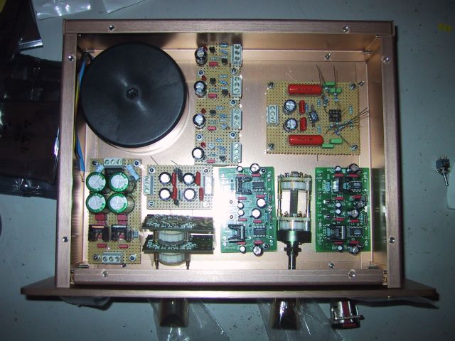

The Chip preamp is getting along. Have a look at the initial setup.
The boards are to the left 317/337 main psu witch feeds the LED regulator of Nuuk's next to the trafo. That will feed the linestage and the VSPS riaa. The main psu also feeds Alcaids CCS/Zener regulator that will feed the headphone amp in lower right corner.
After the great experience with CarlosFM's mods on PMA's schematic,I decided to implement Carlos's ideas on Pavels cute little PCB's. I managed to get 100uF on the OPA's bypass. And the 200pico Polyprop is soldered in, underneath the cute little boards. Elma attenuator with SMD decks and Elma input selector.
The headphone socket is Neutrik. Two boards not quite finished, the VSPS phonostage and Alcaids regulator, but that will be soon. Just received the J511 CCS's today. I want this to be a complete preamp so it can act as a stand-in when modding on the main system. R11 on PMA's boards are replaced by a jumper so the buf's will run in class A up til about 3volts peak. The Gain is set to about +2.47 volts. Hope this one will sound as good as the perfboards I made earlier🙂 Hope you can use some ideas Gcollier.

Im interested in some of the things you built into your chassis can you give me some explanation of what you have in there ? oh good job on the case looks great!!

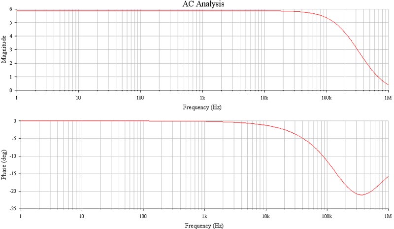

If I where you I would use a smaller value than 200pf. I don't know what value you use for the feedback resistor, but with a 3k3 resistor there, look what the 200pF cap does to the phase. Don't know if it's audible, but if your Rf is bigger, you have even more problems.
Hmmm, interresting curves, Alcaid. I see your point. CarlosFM was quite persisting on the value of 200p. Come to think of it, I remember Pavel recommended 18pF. I think I will lower the value as it quite easy at this point, thanks for the pointer🙂 Great to have you guys around
I will try! As for the psu it might seem to be a lot of fiddling with a simple thing.
But for a preamp I am convinced that it pays to have a good and stable supply. I was a bit concerned that Nuuks regulator wasn't able to deliver enough current to all the boards so I decided to try Alcaids beautifull CCS/Zener regulator to supply the headphone amp. I think that is the most current demanding circuit in there. It is the small board right above the attenuator.
Otherwise the mainsupply is a fairly regular LM317/337 regulated supply with 21 volts output. The two following regulators takes the voltage down to 16,5 volts, wich I was aiming for. The rest of the circuits in there is Pavels nice little pcb's, the green ones. One for the linestage and one for the headphone amp. The perfboard on the right upper is the VSPS phonostage. (Very Simple Phono Stage) (As simple as they come) I wanted the El-Cheapo but couldnt fit it in the small case. If you need more information or links to the particular circuits, let me know.

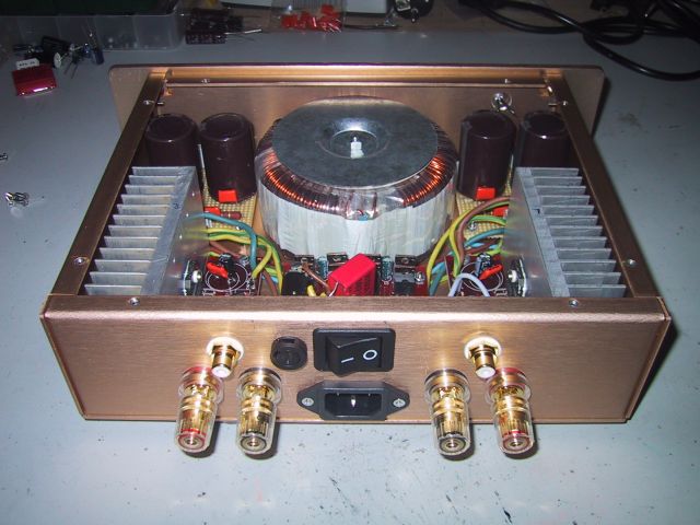

I bought the case here: http://www.thlaudio.com/
In fact I buy a lot of the hardware there. Mr. Vincent Chang is a reliable fellow and I have never experienced any problems, dealing with him. I will post a few more pics of some of the things from there.(Taiwan) Incredible prices 🙂 The chassis are very well made, like the rest of the hardware from there. First a pic of my OPA549 chipamp.
