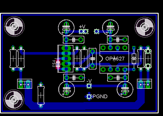

Hi N00ber,
I think you can safely ditch the BW resistor. I have been listening for a few days now, and do not miss it. Really as long the the buffer is heatsinked it is not necessary (I probably should not have mentioned it).
I wonder if you could turn that one decoupling cap on V+ at the buff 90 degrees do that it is oriented up and down. then move the electrolitic over to the right slightly. Viola, no more island (at least not one that matters), and no jumper.
It won't look quite as symmetrical, but who cares?
I was thinking of that myself but i just keep seeing carlos' suggestions and his :crying: gifs evertime i chaage the position of the caps, but is still leaves the resistor isolated.
But i do h8 jumpers more than this suggestion 😉
I may put the caps at an angle but I will sleep on it and see what comes tomorrow.
Here is the BW track with smd pads
EDIT: forgot to attach image
The caps are very important, yes.
You don't need the BW resistor, just use a direct connection.
Why limit bandwidth and output voltage swing?
With most modern op-amps you need to use the BUF634 in wide BW mode, no intermediate settings needed.

That makes me feel a whole lot better 😀
Especially from an experinced builder, such as yourself carlos :angel:
thanks

Looking at the board in post #663, it seems possible to lengthen the tracks going to E4, the SMD part, so there was room enough for a std. resistor for the BW. Then People can use it or not. I know the nice symmetry will suffer from this, though. If there actually is some advantage to it, just as well put it on the board.
Steen🙂
It is true that THD and current noise is LESS with some resistance such as 200ohm to BW. The noise floor is indeed lower than with straight wire, but I am not sure is performance is not somehow better in other ways (beside bandwidth) with it shorted. Still it is a confirmed fact that noise and distortion do go up with just wire there. Still, I am happy with my pre and it is shorted at BW.

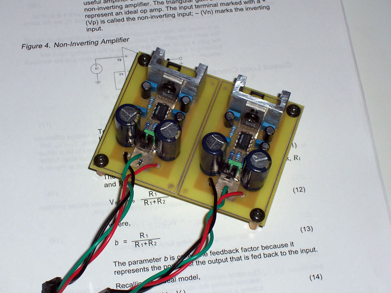

OK I made a few minor changes to the last PCB I posted, I removed the connections from signal ground to power ground on the bottom layer and instead moved the entire signal ground to the top layer. The only place these two meed is at the ground connection from the PSU. You can see that I put this little beauty together today from the photo, haven't listened to it yet. I was a bit short on mounting hardware, so I will eventually replace those monster screws going to the heatsinks. And no I didn't isolate the chips from the heatsink...and no the heatsink does not come in contact with the signal ground...I "engineered" them just for this board 😉 The in connection is between the two big caps...which are optional, the out is behing the heatsink. I used quick connect headers because I had them and they fit. Oh yeah...ther is also a 0.47uF MKT cap between those big caps on the input. The gain is set to 8....and there is a 120R resistor to set the bandwith mode of the BUF634. :smash:
Comments are welcome. 😀
Hi G, My only comments are that you could make the boards smaller by moving C1 and C2 (which appear as simple filter caps) off this board and onto the PS. Those with well filtered/regulated supplies will not need them. I really like how you did the ground plane, but then that forces you to use double sided boards, which may be of no consequence, but it will slightly increase the cost if we did a GB based on your design. The HUGE power traces are cool! 😎
