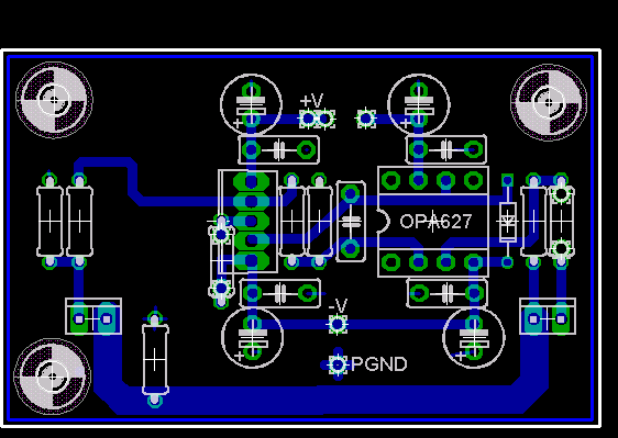

tobias_svensk said:Hello n00ber
First of all, i see a serious fault. Before, you and I had the BW and V- pins on the BUF tied together but now when you have added option for a BW-resistor it seems that you have forgotten that the V- is actual pin 3. So if someone is using the BW resistor they will power the BW pin with the supply and the V- pin with the supply+resistor and if a jumper is used then you will have a pretty long V- trace and loosing the "100nF cap close to the pins"
Second, don't know if it's a problem but it seems that the route for the V+ to PGND has to go around the whole card and thru a 1mm wide trace close to the output resistor.
Keep it up!
This damn bandwidth resistor/cap has had me head scratching all day. I would rather use a SMD component but I know this would not be ideal for all, so I have tried to aviod it, but as I said it would be the preferred option.
The location of the resistor could be either on top with the buffer sitting or floating on top of it, or the preffered location would be to have it on the under side of the board.
To get anything better would require a major overhaul and the board would loose a lot of simplicity that a lot of people seem to like.
As for the route for the V+ to PGND, Russ disconected one of the ground supply in my original design with the two connector blocks, and there was no adverse effects as far as I am aware.
The ground plane will not be carrying a lot of current so I think the gap that is there is sufficient, but it could be increased if required.
Anyway here is the board with the BW resistor location.
I will ammend the other traces this is just to give you an idea of the location.
Anyway back to page 59 of the thread so i can catch up

I think it would be a good idea to widen up the psu traces a bit, seems like there is room for it🙂
Steen😎
Hehe n00ber, that resistor is a p.i.t.*. 😀
I would say: skip it 🙂 if we were talking batterypowered headphoneamps..ok.
Oh and for that groundplane question n00ber i hope you didn't take it as a complaint. It was more like "i hope somebody can explain if it will work fine anyways" 🙂 because grounplanes isn't my cup of booze 🙂

Ok heres my thoughts about the BW components.
I think the people that would be interested in swaping buffers, or tweaking the layout will obviously be more experinced, and there for would have no problems with smd components, and tbh they are not as much of a problem as people imagine, but we do not want to put people off.
Here is what I propose, I will revert back to he no resistor configuration, however I will add SMD pads.
This will allow the trace below the pads to be cut and a cap or resistor added or in the majority of cases totally ingnored.
I agree tobias that resistor is a MAJOR p.i.t.a 😉
I never took your comment about the GP as a complaint, im not entirley sure my self on this point, but when thinking of the currents involved I dont think it is an issue.
Fatter power traces comming up steen 😉
Hi N00ber,
I think you can safely ditch the BW resistor. I have been listening for a few days now, and do not miss it. Really as long the the buffer is heatsinked it is not necessary (I probably should not have mentioned it).
I wonder if you could turn that one decoupling cap on V+ at the buff 90 degrees do that it is oriented up and down. then move the electrolitic over to the right slightly. Viola, no more island (at least not one that matters), and no jumper.
It won't look quite as symmetrical, but who cares?
