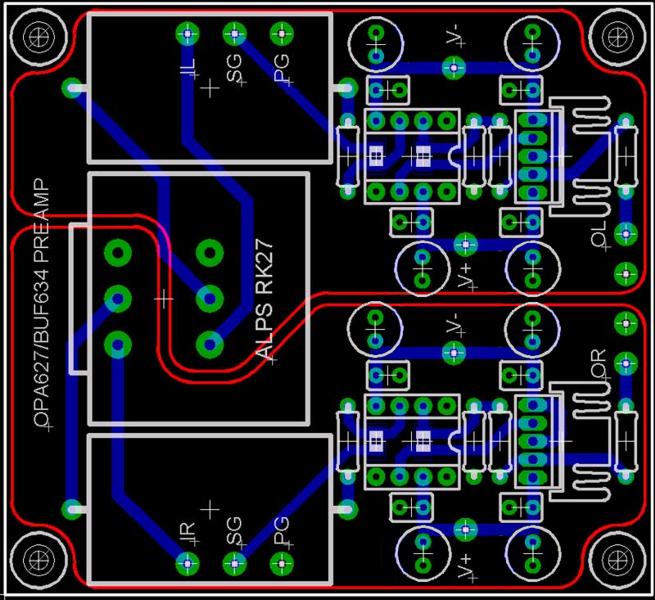

Ok, I felled the pressure 😉 to have the elcaps closer so i did another board. Now it also fits a 16x26mm inputcap like Mundorf M-Cap 2.2uF or simular.
I also skipped the terminals, because i'll just solder them directly anyways (from under).
Havn't decided yet if i'm going for a CRD/Resistor or cascade biasing.
with gp
without gp
3d
Thinking about using this PSU
psu schematic
top
3d

tobias_svensk said:Ok, I felled the pressure 😉 to have the elcaps closer so i did another board.
That's a good pressure.
It's better.
tobias_svensk said:Now it also fits a 16x26mm inputcap like Mundorf M-Cap 2.2uF or simular.
Unnecessary.
I prefer to use that in the end: the power amp.
carlosfm said:Unnecessary.
Yeah i now, but they fit there right now when the alps is there so hm.. well i don't know 😀
tobias_svensk said:Yeah i now, but they fit there right now when the alps is there so hm.. well i don't know 😀
Let it be, it's optional.
You can use a wire.
But in that case you should allow for different cap sizes, not only one.
tobias_svensk said:
In my opinion, you should put two caps before the regulator and 4 caps after the regulator. It's the inverse that you have there.
In my case, I add better results this way.

Tobais,
That is a fairly nice power supply design. It is actually very similar to what I am using right now on my OPA627/Buf634 pre that I posted here earlier, with the exception that I used larger filter caps up front. I can say that I am very happy with both the pre an the PSU, you likely should be too. 😀

Layout comments?

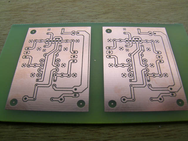

n00beR-
I sent you mail last week, I guess you didn't get it.
I etched a few of your boards, though I only have single-sided handy at the moment, to a added a groundplane to the trace side.
Send me mail with your address so I can mail you a pair.
I don't have the components to build them yet 🙁 but I shoudl be ordering this week (some double sided boards too).
WorkingAtHome said:n00beR-
Do you mean you have added a ground plane to the other sideof the board. (I.e. power ground on one side, signal ground on the other?)
No i never got your message i will go check it now and get back to you 🙂.
I have been too busy enjoying my new senn 600's this week
Thks again
n00b
GeWa said:Hi guys
Just for the fun of it I made a small mod on the board.
I rotated all the caps 90° so they are all a bit closer to the op-amps.
A kind of a "carlosfm" touch
Cheers
tobias_svensk said:GeWa, it was ment that Carlos should have comment that 🙂
I did it just for him 😀
Geez... that looks good.😎

If someone wants to make some feel free to do so, please give me some more idees (like if someone really want that output resistor to ground etc)
One thing that can be done easy is to skip the input caps and rotate the ALPS 90 degrees (that way the motorized ALPS RK27 can be used)

PCB=2500x2500mil
ALPS RK27
El.Caps 6,3mm / RM=2,5mm (as big as possible)
100nF Caps = Wima MKS2 2,5x7,2mm RM=5mm
Resistors = RM 7,5mm
No input caps.
That's whats fits the board.
