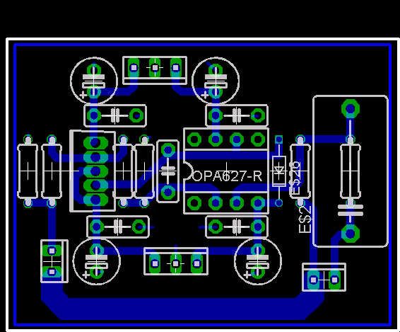

In my PCB i skipped the rail-to-rail cap. because it would't fit 100% good on the PCB anyway i think. That cap. could be soldered directly to the socketpins from under (Wima MKS3, RM=7.5mm fits very good there) or perhaps a SMD cap. inside the socket in some way.

Question: With the diff pics of PCB
I may be wrong but:
I do not see a trace going to signal ground from the input to pot.
In other words there is not a voltage divider setup on the input
just a variable series resistance from In to to +input of Opamp.
It looks like only 2 connections to each pot.
It's connected to the groundplane.
Maybe an idea to split up the power- and signal groundplanes?
Cheers
Thats what has been done on my board, however I lack the "onboard pot" that seems to be popular 😉

signal ground
I am a real beginner so please excuse my simple question.
I notice on a couple of these cool PCB designs that the signal ground is seperate on the circuit from power ground.
My question is do the SG and PG currents ever come together at any point?
If they do come together is it off the PCB at some star ground say at the PS?
