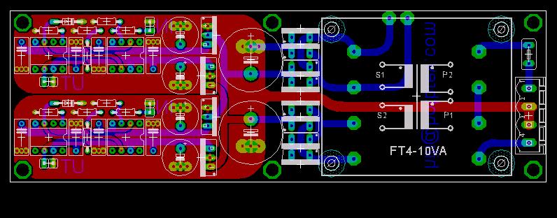

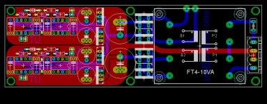

Here is another layout based on the same setup. I made it for a friend and i have placed some extra vias here and there to ease conecting components (wich cover up their pad)s to the groundplane.
It is as of today untetched and untested so...be aware 🙂
The diode is used, if necesary to bias the opamp into class A and the cap shorting the opa627 feedback path is best mounted directly ontop of the chip in question.
/ Micke

From an initial quick look, thats a nice layout you have there, it reminds me of PD's TDA1543 dac 😉

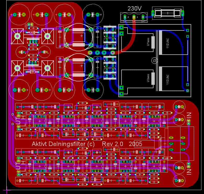

Yes it kinda does doesnt it? Peters dac was however not the primary source of inspiration. It was just fitted to a piece of left over laminat (50x150mm).
The previous art I based the outlining on is a crossover I drawed earlier this year. The smililarities should show.
It also features two discrete bridges. : o )
/m

However my preamp is based on Pavel's design and his schematic can be seen here
