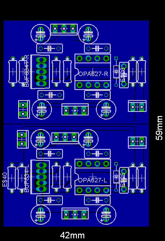

Open up BUF634 in library and open device TO220-G5, the pins are 67 mil apart i think. I change that to 75-80 mil i think.
After that open up DRC in "BOARD" and "RESTRING" tab, edit the three "PADS" to something like: "min"=6mil "%"=16%
Then "LIBRARY" -> Update all
Just a suggestion
I know that everyone has an idea what is "best" but if you are planning to make a board that will eventually be a group buy it would be nice to have pads for optional components
ideas for optional components.
Output resistor to ground (after series out resistor)
Pads between OPA output and - IN (used for a stabilizing cap or "sub" feedback resistor )
according to Ti data sheet with OPA 627, a 200pf cap must be there
OPA out to -Vs for CRD (a la n00ber)
neutron7 said:
Just a suggestion
Some thing like this neutron7?
Right, time I got to bed :moon:
Thanks again for input
Craig.

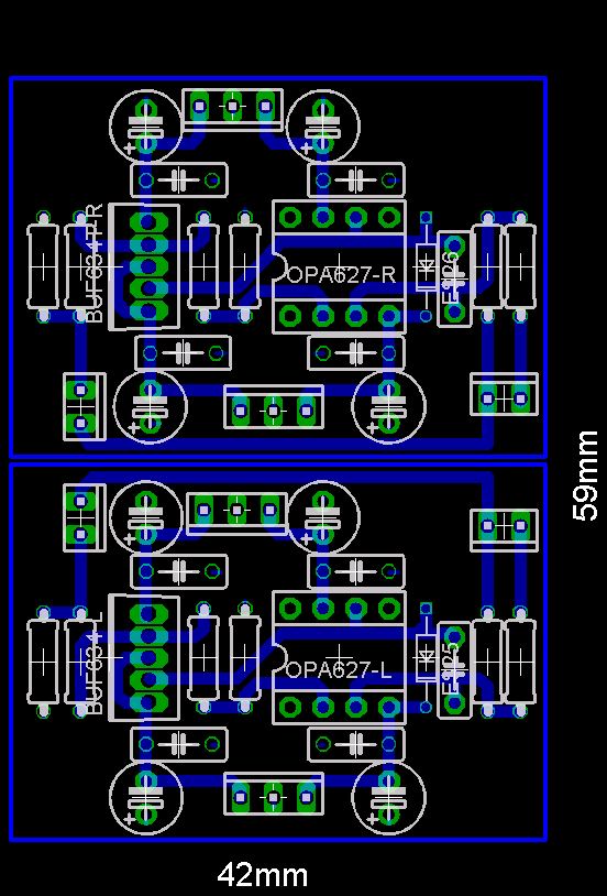

neutron7 said:
n00b, icant really see, but it looks like you have the "extra component"
between output of OPA and -supply in parrallel with ur CRD thingy
i meant between output of
OPA and - IN
sorry for confusion.
BTW great job at the out resistors.
Oops! yes you are right, I have updatd my layout, thanks for that
:hphones:
Not your fault neutron7, it will teach me to go to bed on time 😛
I have left out the ground plane to make things easier to see😀
Thanks for the responses guy, much appreciated :angel:
