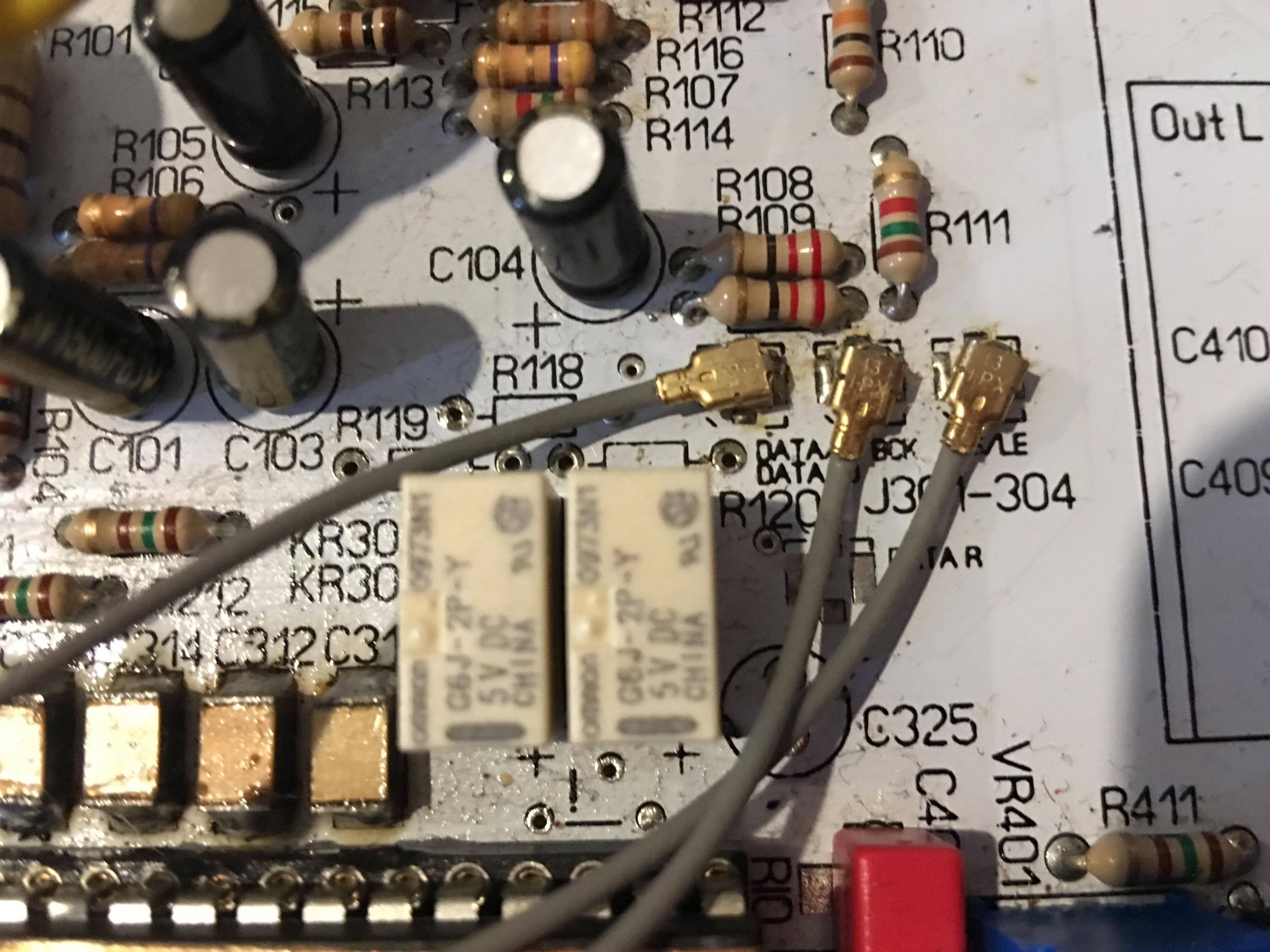

SDTrans connection to AYA DAC
Hi there all,All well i hope,, whilst waiting to find class 4 SD cards i now have in my procession a New AYA DAC and a new SDTrans 384 (firmware 3.16)
So what the best way to join them up in 12s mode?- I seen Sumotans picky, but its not to clear to me (wires crosses) and my PCB is differently laid out to his.
I have the BNC/SPDIF option fitted so when the input relays are energized it seen SPDIF (tested it , it works very well)- with relays (KR301/KR302)
de-energized, Ufl inputs J304/J305/J305/J307 are available for 12s input from the SDTrans.
On the AYA DAC Inputs available are:
j304= Data Left
J304= Data Right
J305= Bck
J307= LE/WS
On the SD TRANS when configured for 12s O/P the 8 pin header is labeled:
1= Lck 2=gnd 3 SDAT 4 Gnd 5=DCLK 6=Gan 7=MCLK 8=Gnd
I have an idea what to connect (but every one uses slightly different designations)...so can anyone be kind enough to advise me as exactly what to connect from the 8 pin header on the SDTrans to the AYA DAC inputs?
(I ask as i only want to connect the UFL once)
Thank you gents
Regards
Johnny
(I also have Ian Canada's PCM/12S PCB also, I assume that could be coaxed to work if Sim mode invoked on the AYA DAC??)...but first thing first eh!!

There is a resistor that needs to be removed to get it working buy since
you mentioned that your Aya ds is different then pls check with Pedja.
Do note once you head this way you no longer can use the USB port ya.
Notsure if Pedja has made easier to retain the USB for your AyA
Cheers
Cheers

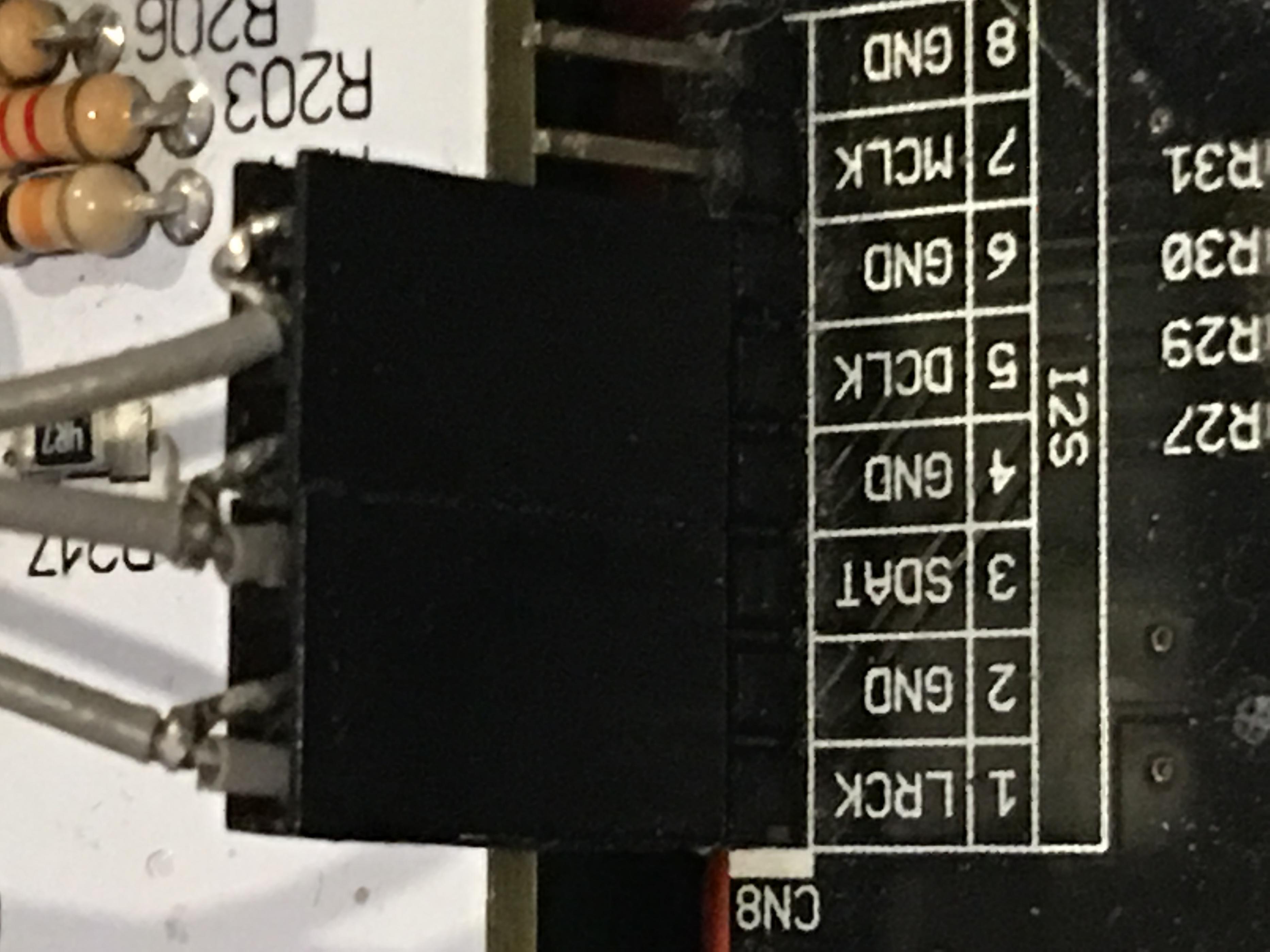

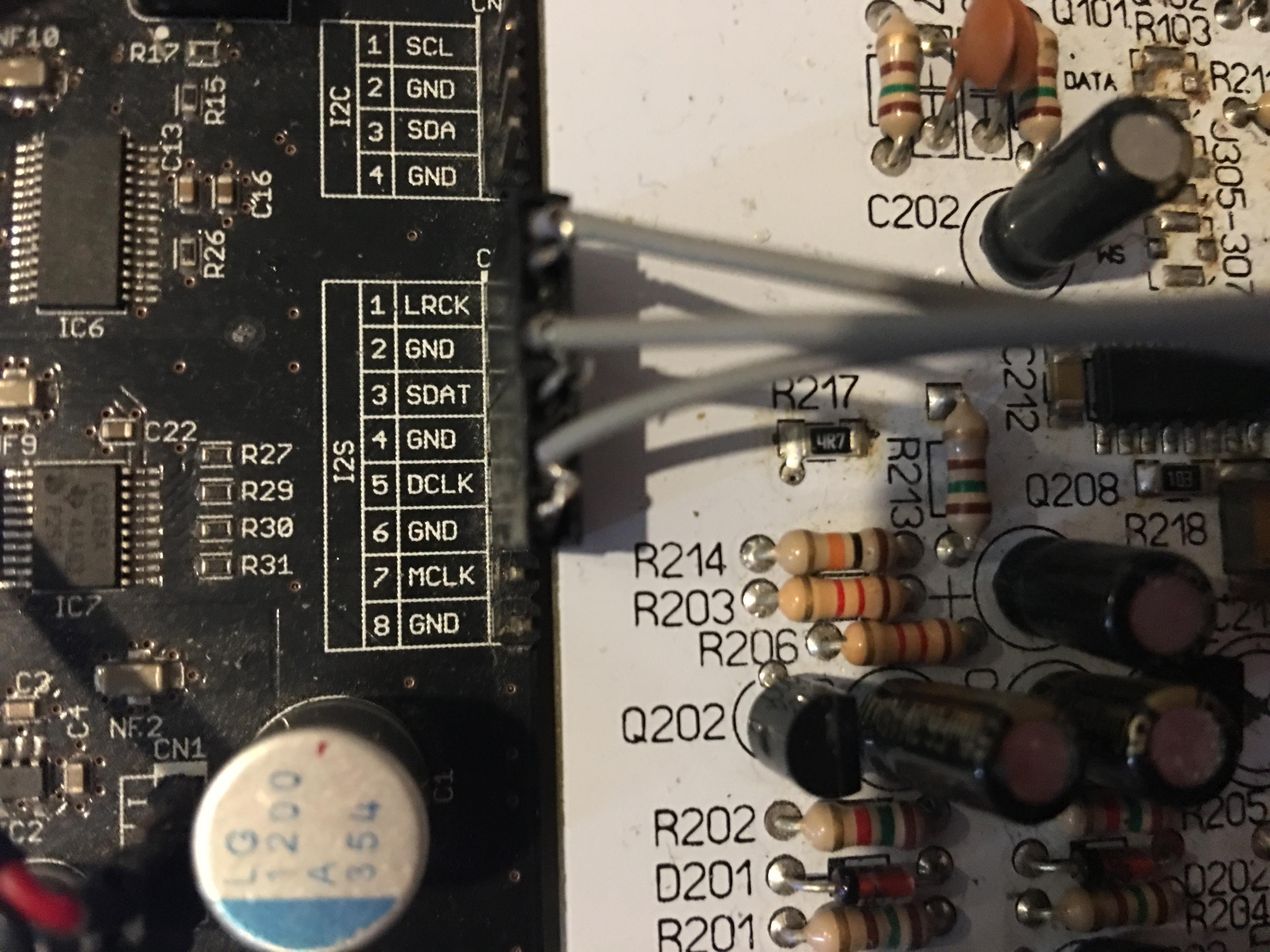

Hi Again Sumotan,
Thanks for the reply, I am a bit confused by the photo showing the Molex connector CN8 connector-- its seems that LRCK/Ground seems to overlap to empty space? or is it me??
I think it would be:SD Trans CN8 LRCK to AYA LE/WS
CN8 SDAT to AYA DL/DATA IN
CN8 DCLK to AYA BCK IN
Cant try now (at work) but i think that would to it😀
Thanks to Sumotan for helping me!..ill read up about the resistor, but as i have no USB option fitted it may be OK as is in my case?
regards
John

AH.... got it now, thank you, blooming shame everyone cant agree on Ufl connectors-and terms, but it all makes sense when the penny drops..i will post when (if?) i get it all working, thank you Sumotan.
Best regards
Johnny
