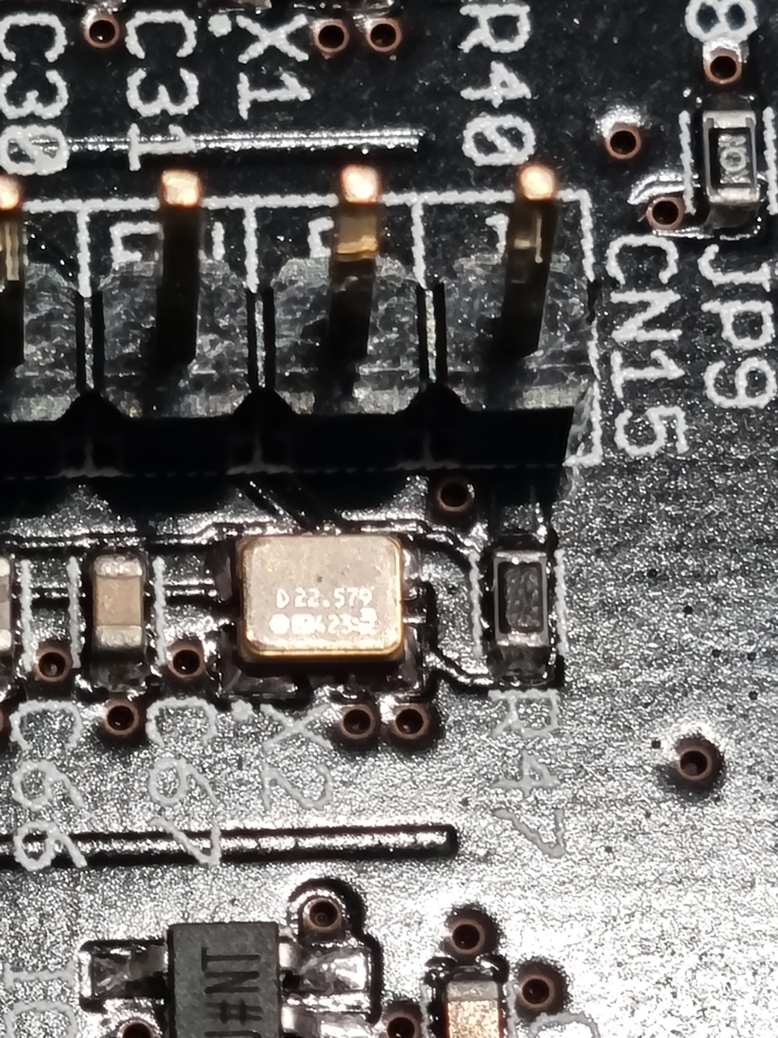

Hello, and thank you all for the help regarding this old topic. Greg I have read what you have done to your Sdtrans384 (and some other your posts) and I am really impressed with your work and how you present an explain it to others. Thank you for that.
Regarding my system - I use upgraded (as most of my gear) Mark Levinson 360S DAC (PCM1704 R2R chip), connection is through SPDIF of AES (I already saw I can implement AES output out of SDTRANS spdif CS8806 transceiver, but that is in plans later). I got SDTRANS from a member of this forum. He said he had used it successfully with HDMI (i2S) and probably SPDIF connection, but that was long time ago. But he provided me with english version of manual and japanese and translated to english manual of additional daughter card - sdtrans384-sync-SDT, as his sdtrans was with it equiped. Sdtrans-sync is one of the additional cards made for sdtrans to be able to connect it to sabre dac and to get clocks signal from the dac as a master. I got the sdtrans first and got manuals a couple of days later.
As I first got sdtrans I connected to it 5V LPS, it read the wav files on the card, but as play was pressed it gave me "timeout 1267" error. I removed sdtrans-sync daughter card, shortened pins for CN7, CN1 for power supplies (sdtrans-sync connects to these, so they were not shorted on sdtrans main card) and CN11 and CN15 pins for the clock signal. What I got was files on the card started playing, but spdif connection gave no signal to the dac. What I mean - when I power up the sdtrans first, connected to my dac by spdif, it shows 44(khz), but then I press play, sdtrans starts playing wav file, but my dac switches to no signal. I have handheld oscillograph to measure the signal and both times I can see some signal coming out of sdtrans spdif connector, but after starting playing wav file, signal does not change its voltage or anything, probably playback information was not sent to it. Next day, when I got sdtrans384 and sdtrans-sync manuals (japanese and translated to english), I went backwards what is written in sdtrans-sync manual how to install it: most things I have done already, had just relocate the very small (2-3mm) jumper from jp4 to jp3. What I got now was that after sdtrans turns on my dac shows 88, but after pressing play, dac changes to 44, but music plays at 1/2 speed (very slow).
The only thing I could not revert back was sdtrans ROM. In sdtrans-sync-sdt manual (I have attached it here) it is written that simple ROM and sdtrans-sync enabled ROM are not compatible. Maybe sdtrans-sync compatable ROM is responsable for this slower playback? Clocks seem to be original 22 and 24, I will attach the picture, can anybody confirm if its SA or SDA series?
As for possible better new version of sdtrans or upgrades to mine (if I can manage to get it working), there are many options. One possibility is to change spdif signal chip to wm8804 as that is a lot better chip than CS8806. And of course 5 separate power supplies. I have tinkered with power supplies to my dac Mark Levinson 360 (later got 360s analog boards with Levinsons discreate power supplies), preamp 38, Cd player - arcam delta 170. I have tried different 78xx 79xx regulators and found out that even same company, but different manufacturing location and time regulators sound different, tried lt3045, some discrete regulators like Jung-Diden shunt regulator. Still need to find time to sort out and try Salas shunt regulator (got some assembled boards). What I found out is that newest regulators like lt3045 usually give big wow factor with a bit artificially increased highs and detail, but there's less natural flow to the music and everything sounds more "digital". I really liked the power supply with tl431 and my friend is trying TL431+transistor for increased power output in his projects with very positive outcomes. Of course there is also differences in what kind capacitor you use before and after regulator. So there is many options to keep exploring.

What is causing your problem is that you have the Sync Mode ROM installed. The ROM is is loaded onto the EPCS4N chip in the 8-pin DIP adapter near the center of the SDTrans384 board (IC9). AND unless the seller sent you the original stock SDTrans384 ROM (or still has it and can send it to you), you will need to contact Tachyon/Mr. Yamazaki or Bunpei to get one. You should try to contact Tachyon/Mr. Yamazaki via the contact information in this thread AND Bunpei via PM both here and on Audiophile Style (I have communicated with him on both forums that way).
More on your other comments later, but I am pretty getting a standard, non-Sync mode ROM to install at position IC9 must be done to get your SDTrans384 to work correctly. AND once you get it and it still doesn't work, we can further assist you in troubleshooting it then. BUT getting the right ROM installed is a prerequisite.
Greg in Mississippi
P.S. That does look like one of the original stock NDK SA series clocks. As long as the clocks on your board are a 22/24 pair, once you get a non-Sync-mode ROM installed (and assuming all the other changes are correct), it should work ok.
I don't believe that there is any indication on those NDK clocks as to whether they are SD (sorry, my bad, I said SA, I should have said SD) or SDA.
