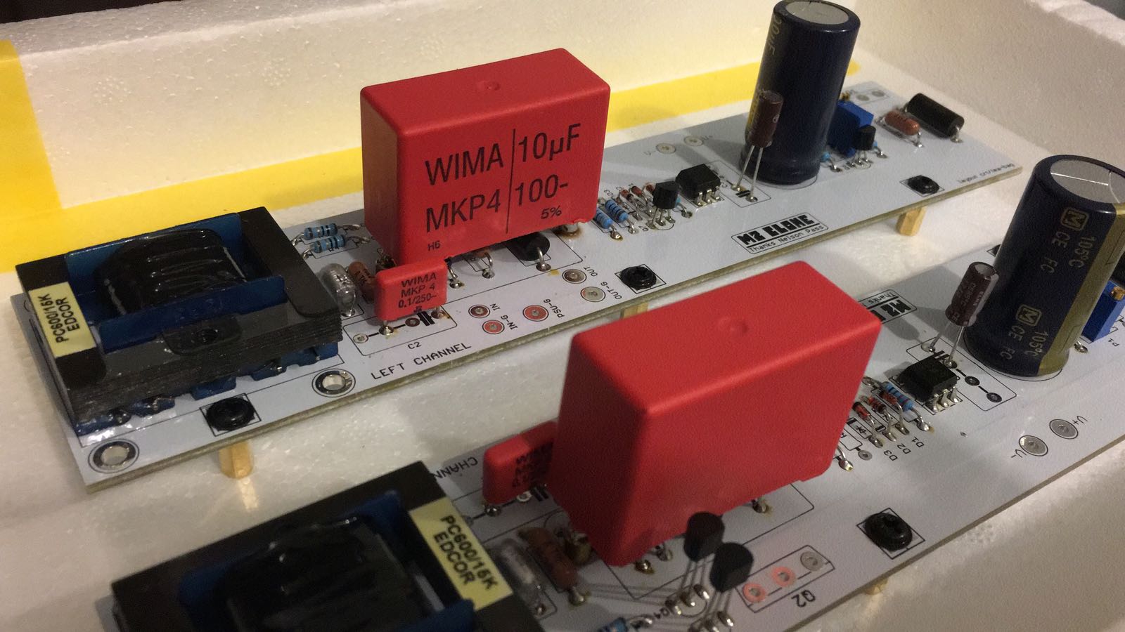

Just a quick update for my build:
I keep forgetting to order the right amount or always missed some parts. Thus...no testing yet.
I reused my humongous 10uF red Wima from the other project. (almost as big as the Edcor transformer)
I am tempted to try Gold/silver oil for 0.1uF and 1uF bypass caps after listening to my friend's Whammy headphone amp which was equipped with 2 expensive Gold/Silver oil caps.
That really shocked me: extreme clarity, 3D feel, romantically beautiful; only that the bass is a bit too much for my age.
The boards are very nice; my solder gun might be too hot and made some brownish burn marks around.
That's it! more to come later.

I don't want to discourage anyone from tweaking. It took me some tweaking to come up with the recommended components I listed.
I did not find changing the input caps around in the M2 to alter the sound too much. I am not certain why. I assume the Edcor dominates the signature sound. Changing the Mosfets was big, signal resistors a little. The Wima bypass I used over the Elna 10uf may have brought a little more air to it. It may be that the Elna and Edcor are both a little lush, so kind of adds to the smoothness, but may harm resolution ??
I know this. Because of hot weather, I took the M2 out of office system (which I use a yamaha 9.1 receiver on currently.) and went to use the speaker outputs off the Yamaha....Such a loss of sound quality, its sterile tone deaf and generally uninvolving. It does however keep the M2 from overheating my office space when it is 30c outside.
Thanks for helping us save money! It is good that you have tried so that we won't have to. ;-)I don't want to discourage anyone from tweaking. It took me some tweaking to come up with the recommended components I listed.

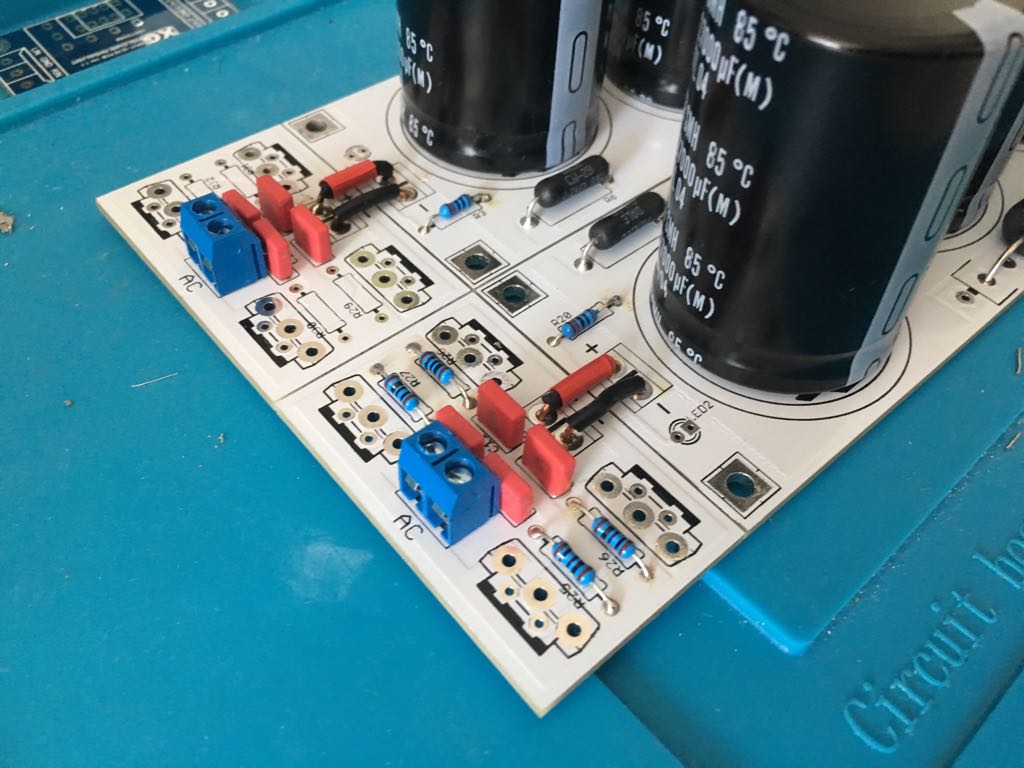

I’m going to use a DIYA power supply that I have with this amp. I want to know if I can use an AnTek 400VA 20V transformer and want to know if I can use it or do I need an 18V transformer?
Eleven percent greater supply voltage means eleven percent greater power dissipation(*) that the heatsinks must radiate into the air. Do you plan to increase the heatsink area by eleven percent?
(*) since the optocoupler bias circuit used in the M2, guarantees the amplifier's DC bias current remains rock solid and constant. Voltage rises 11% but current remains the same --> power dissipation rises 11%
I was going to use the Dissipante 4U 300mm chassis, but it sound like I would need the 5U. I don’t want to go deeper.
completed the M2 build with 1530/201 mosfets
Thanks Tea-Bag and all the other members for their contributions to making these builds the pleasure it is. Your boards were great to work with. Had the Toshibas around and was glad to use them. Geez! the slam and drive. I am using the M2 for the low end and an Aleph J for the highs. Lowther/emminence on a OB. Just fantastic sound. Want to shift them to hear the M2 on top. Thanks again for all your effort.
