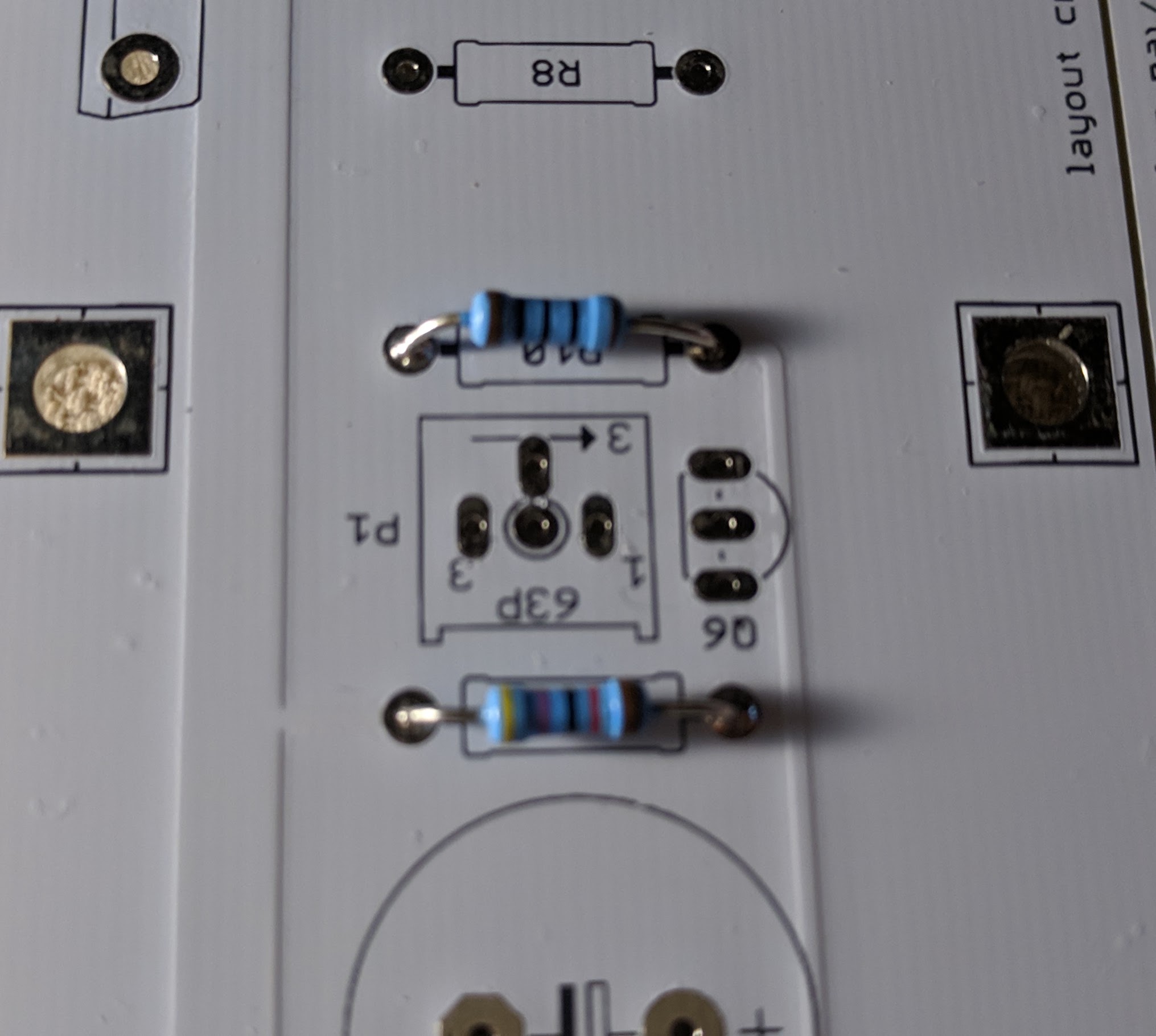

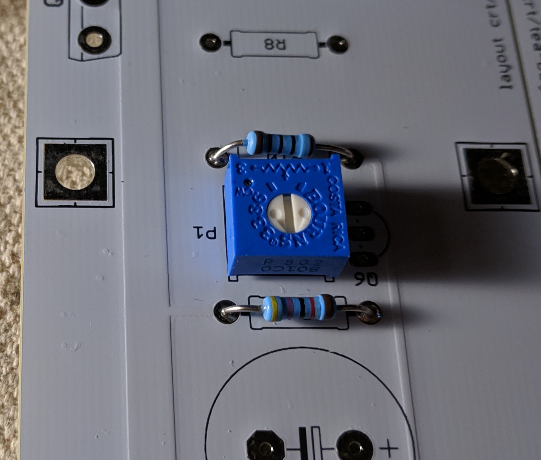

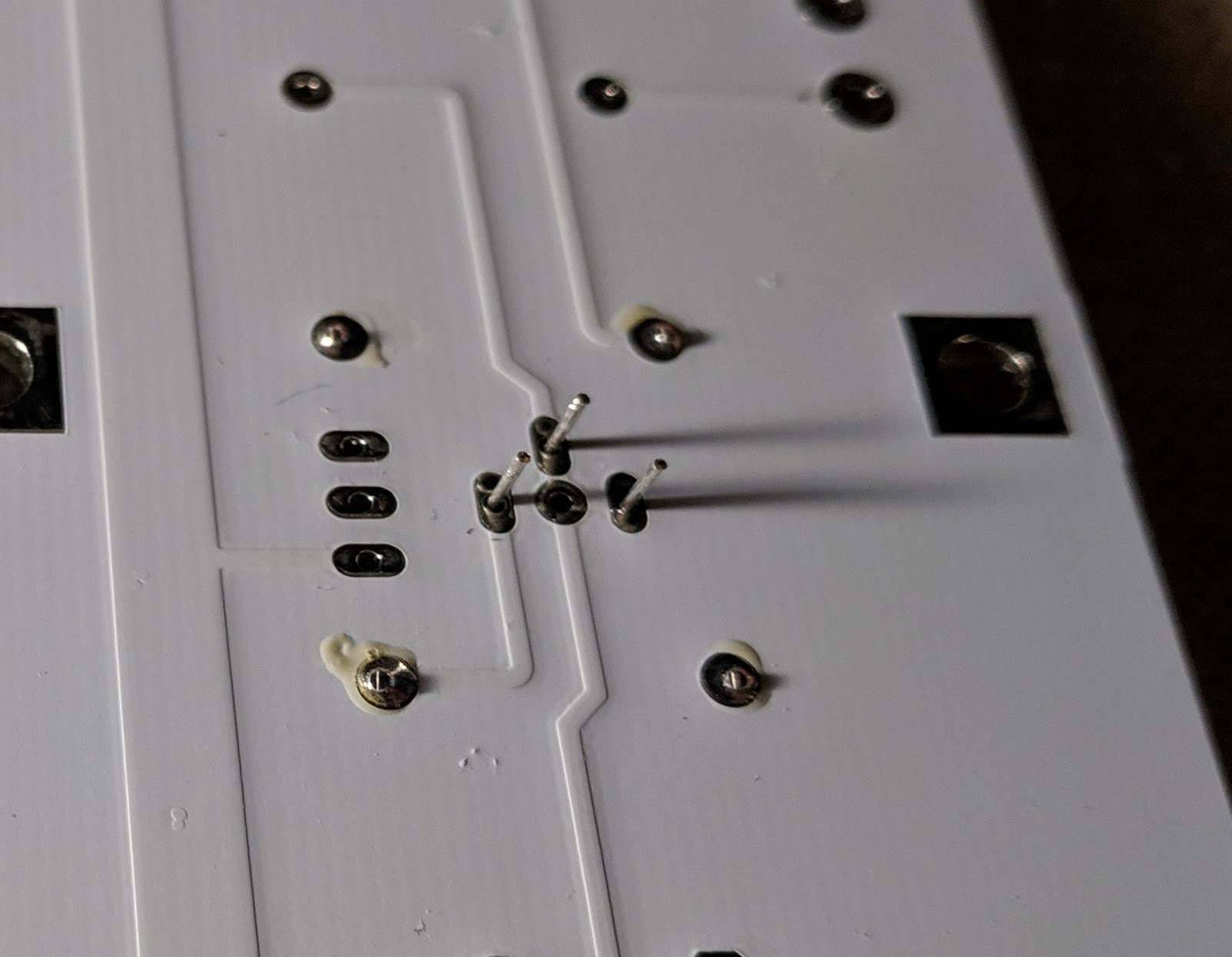

I didn't have much luck searching the thread so... I'm building up these boards, and the bournes potentiometer I sourced (from the BOM's recommendation) does not seem to correspond to the connections on the board.
- The pot has three connections. One of them lines up with a pad that is not connected, and one of the pads that is connected lines up with a missing connection on the pot.
- When you line up the pot with the pads, it appears to be a mirror image of the markings on the board.
Any clues as to what's going on?
