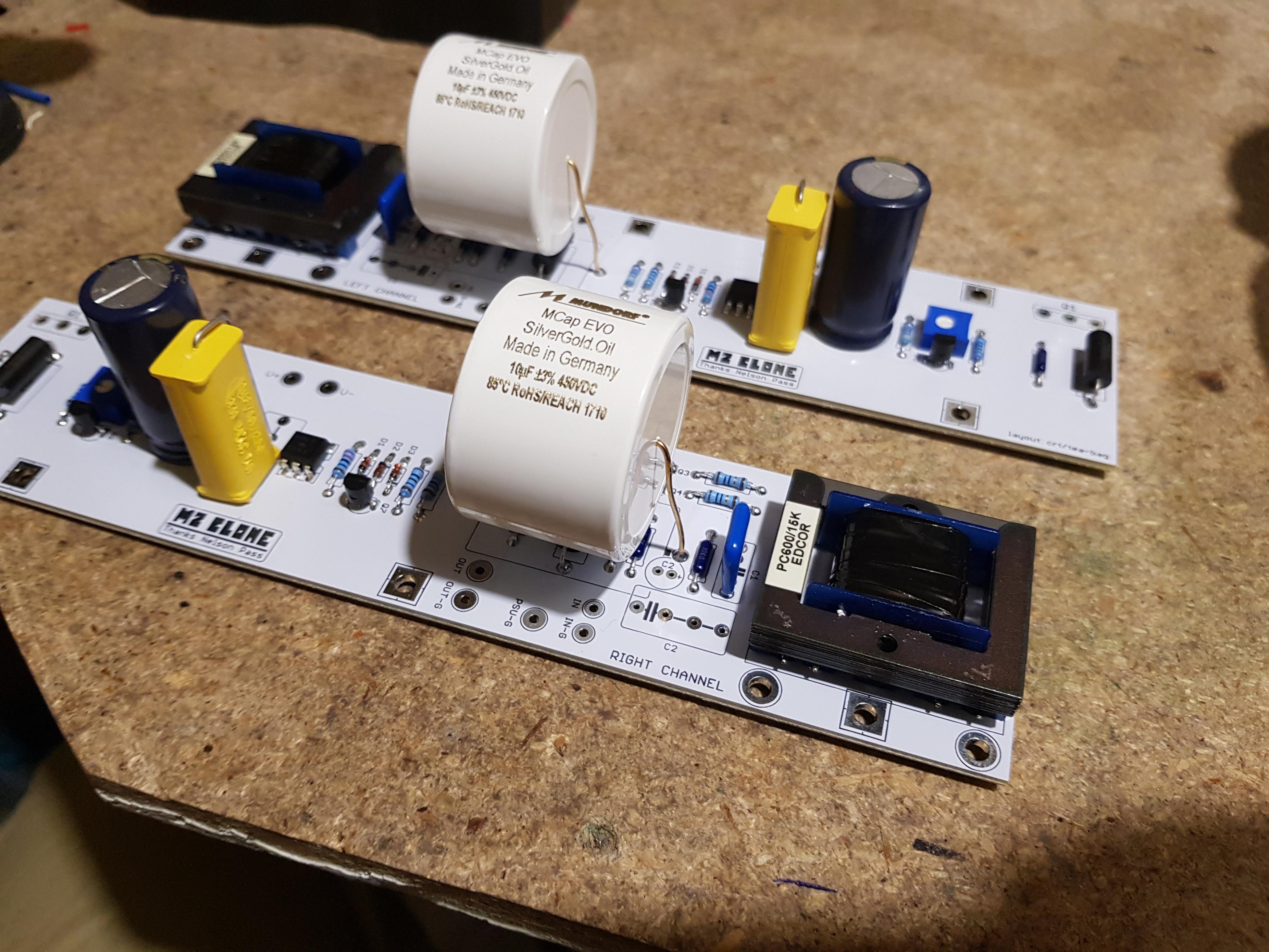

I have recieved in plenty more M2C boards, Power supply boards and Edcor transformers.
So nobody should be on wait list at this point. Private message me if you need these parts

Just picked mine up from the post office this afternoon, looking good! I can feel the amp building itch coming on...
