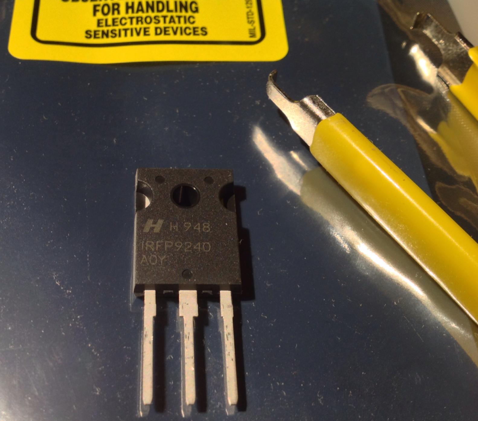

I went for Harris instead of IRFP9240 described by Tea-bag(http://www.diyaudio.com/forums/blogs/tea-bag/203-m2clone-boards-120mm-ums-spacing.html).

Tea bag, I have a question (some confusion on another thread) do you have Harris pairs? I understood they were Harris/Vishay combo, right?
Thanks,
Russellc
Thanks,
Russellc
Yes, I did not want to use IRFP9240 from Vishay, It did not sound as good as the Harris part.
I was not able to source any Harris IRFP240 parts.
Nelson I beleived use use Fairchild parts, but those are REALLY hard to get now Lots of fakes. Toshiba parts I believe are easier to find, but takes more tweaking (which I have not bothered with).
