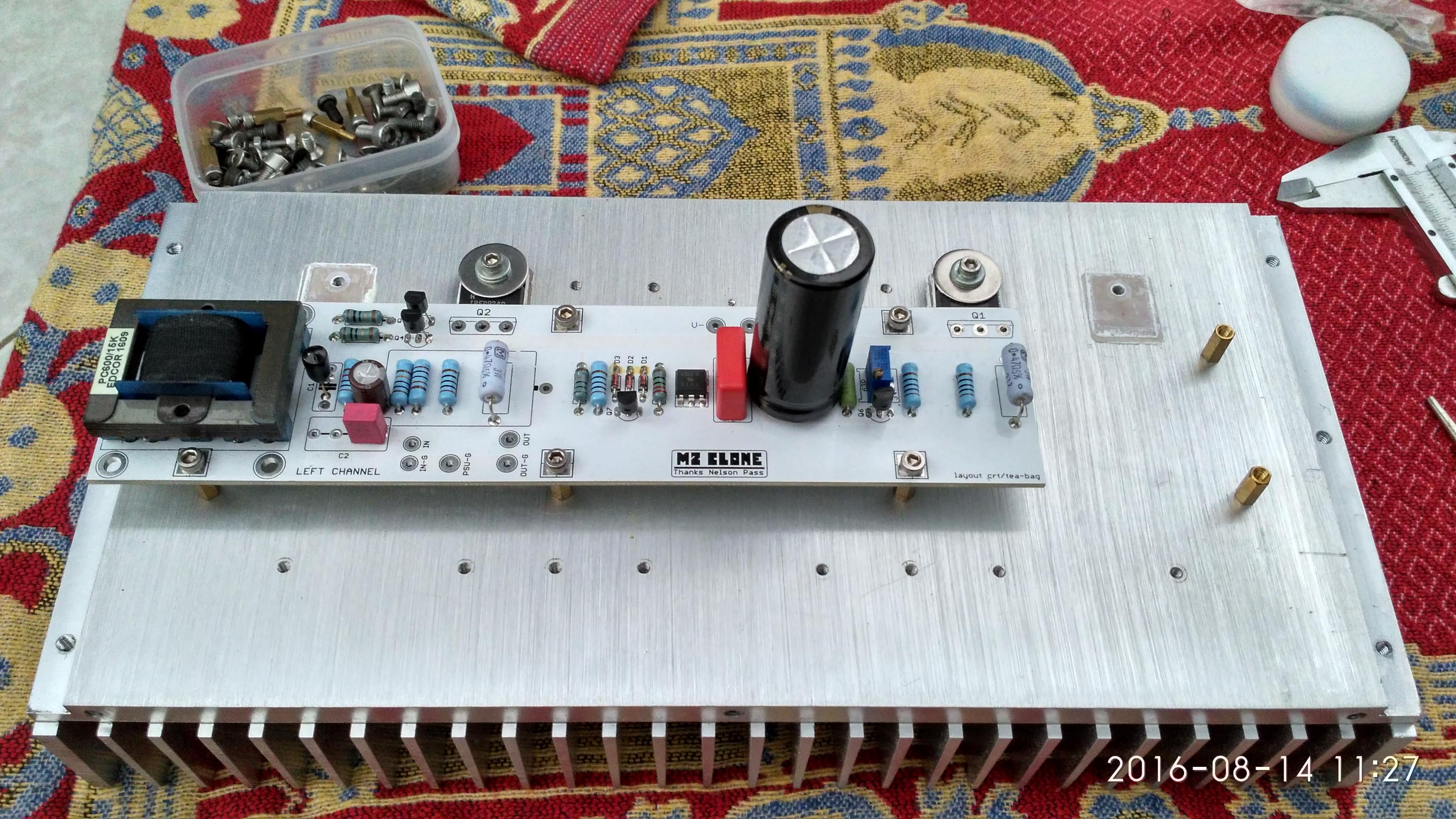

On C2 the BOM recommends Elna Silmic II
On C3 the BOM recommends Panasonic FC and that is what I used
I see that on C3 that you have fitted a larger 3300uf X 50V Elna Silmic II
Did not think it would fit due to size
Now I'm considering because I can see from your photo that it fits, to swap the Panasonic FC to the larger size Elna Silmic II
FR
FR
C3 recomended size is 16mm, while my C3 is nichicon super 4700uF 16V with 18mm diameter still can be used there. But silmic 3300uF 50V will not fit in since it's 30mm, I have silmic ars 1000uF 50V with 16mm diameter but not sure for it's smaller capacitance.

I have used a 1000uf Silimic part on C3, it takes less time to bias up, which is probably not a good thing, but it fit okay.
I think C2 is more important cap than any others, being in direct signal path.

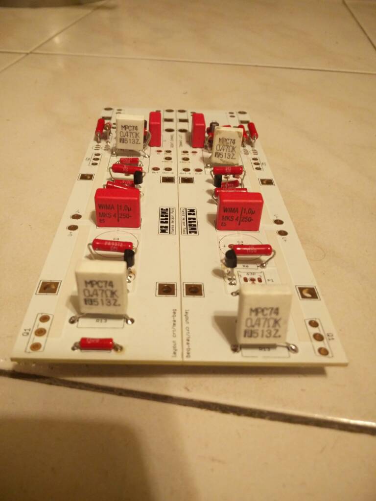

Contemplating some of the pics. I kept my boards connected for stuffing and broke them apart afterwards. In retrospect I would have preferred breaking them before stuffing. Many slices with a blade to avoid undue stress during the "break"...
http://www.diyaudio.com/forums/grou...120mm-ums-spacing-tea-bag-18.html#post4696417
Hey, no solder shaming on this thread. People work with the skills and parts they have.
Thank you both for the clarification
