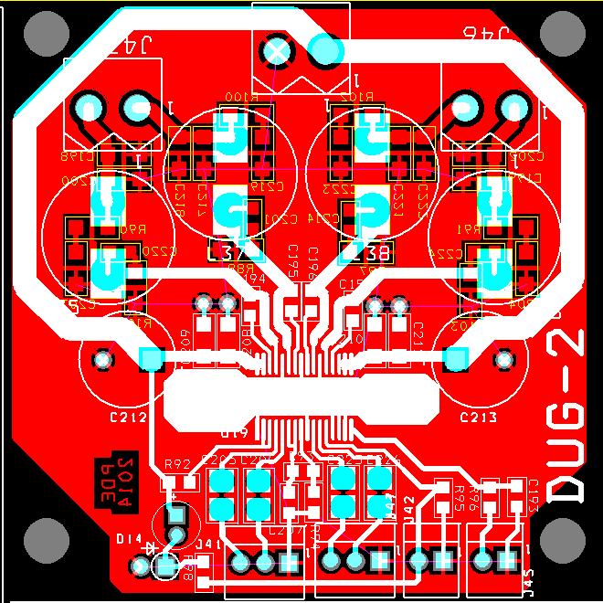

Do you have pictures of the stereo BTL board? Sizes? Same things added to evm like turnon pop reduction and ??? Room for 1206 decoupling close to chip? etc etcFirst: most people are using these for an 8R speaker alone...the options for most of the parts are its' features.
I have four stereo BTL boards coming next week...one is spoken for...a kit for that one is also requested.
Not as many options for the inductors, Avcc is not separate.
AVCC shouldn't be separate 😀 Through hole inductors with prefilter snubber under them on other side, single snubber design? Hiamp has even no groundplane under inductors, Sagami has an article/explanation on their website that may tell why. Not certain it is relevant, but Sagami thinks it is, and technicians measuring their and Icepower inductors seem to like them. Nice compact output, big powerinductors prevent that on dug1.
A ground plane under "bobbin" or "unshielded" inductors could act as a shorted turn in the magnetic field...significantly changing equivalent inductance.
In the RF world an "open" coil should be clear of ground planes by 2.5 times diameter.
Try to use shielded inductors or at least ones where the core gap is in the middle of the assembly.
🙂 Yeah Sagami/Ice have raised coils inside packages. Pcb side not shielded most inductors I saw, some have coil horizontally too.

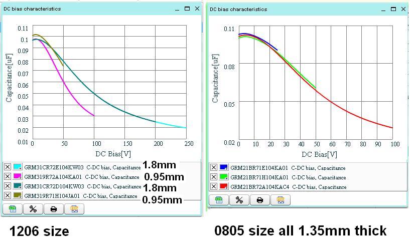

I've been able to find most of the parts on mouser.fr with the refs of Dugs BOM in post #180
For few other I've had found alternative parts, see below.
Could someone, check they are OK ?
Original part number -> Alternative part number
C8,C11 - 0.1UF 50V x7r 1206 - CC1206KRX7R9BB104 -> C1206C104K5RACTU - SM/C_1206 - power supply bypass
C9,C10 - 1000PF 50V cog 1206 - CC1206JRNPO9BN102 -> C1206C102J5GACTU - SM/C_1206 - supplybypass
C18,C21 - 1000PF 50V cog 1206 - CC1206JRNPO9BN102 -> C1206C102J5GACTU - SM/C_1206 - output filter ccts
C19,C20 - 0.68UF 50V x7r 1206 - CGA5L2X7R1H684M160AA -> C1206C684K5RACTU - SM/C_1206 output filter cct
R8,R9 - 10R 1206 - CRM1206-FX-10R0ELF -> CRCW120610R0FKEA - SM/R_1206 - direct output snubber cct

The first one is a good choice as it is thicker than the original.
The 1000pF and 0.68uF would not be a good sub IMHO as they are thinner than the original.
There was some discussion (somewhere on diyaudio) about capacitance changes vs DC bias voltage of non-COG(NPO) ceramic caps.
A Murata site was listed as a place to go to compare caps vs DC bias.
It was interesting.
I used to think that the higher voltage rating reduced the effect that DC bias had on the capacitance change.
I was w-w-w-wrong. 🙂
I have changed my thoughts to the thickness as the important factor.
Investigate yourself but this is what I think now.
Doug

1206 0.1uF--> search for cog/npo and pick one 50V you like, Murata helps people with simtool so i Always pick them if possible 🙂
1206 1nF/1000pF ---> cog/npo plenty available pick a 50V you like
1206 0.68uF ---> pick a good one LOL 100V could also be adviced in this position, it will see highest voltage when amp is oscillating 🙂
NPO/COG: no voltage change, no distortion smeared all over like classII (xr7 etc) ceramics, might even be better than many fullsize filmcapacitors. Size or voltage don't matter with COG for distortion, nor does temperature. ESR lower than all others that could fit in same spot, distortion lower than all others that could fit in same spot, you get the picture 🙂
