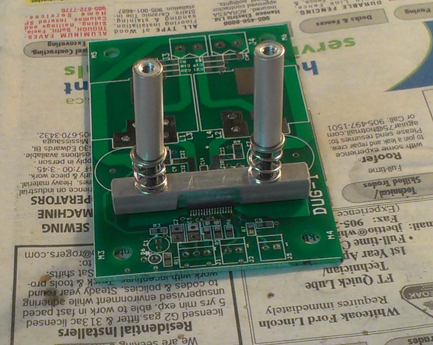

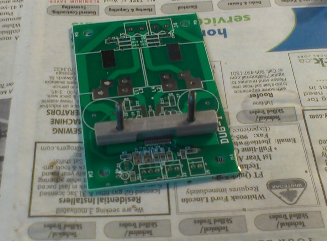

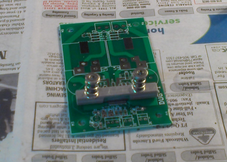

What down-force can be maximally applied on the heathsink?

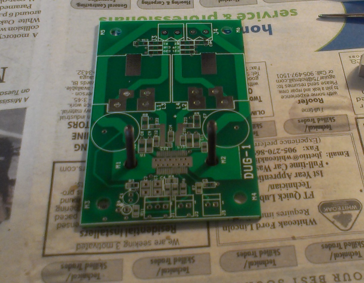

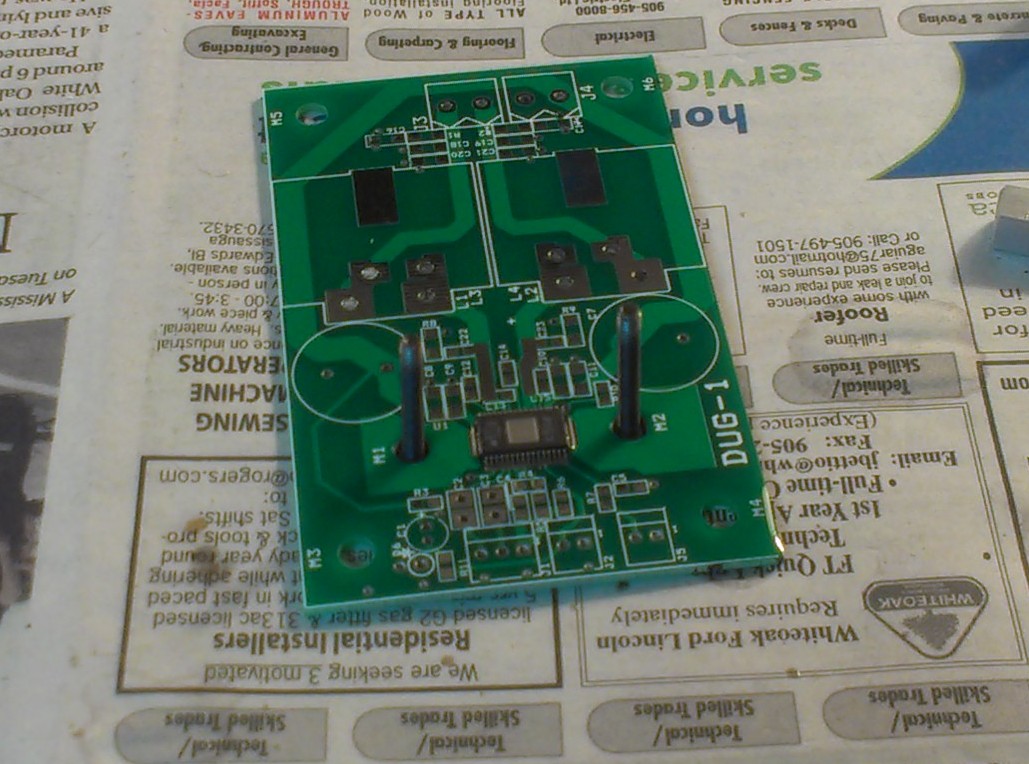

Here is how I install the IC's.
I've skipped the fluxing and soldering parts.
They are clamped in place. This allows me to position them right where they need to be.
I can pick up the board and look at the position without disturbing the IC's placement. Short of dropping the board the IC does not move.
There is approximately 350gms of force on each spring.
The IC's are spec'd at 1mm in height.
The tricky part is getting a heatsink that does not connect to other SMT parts that are thicker than that.
The heatsink mounting holes are 1.080" apart.
So to answer your question I can only say that 700gms should be OK.
