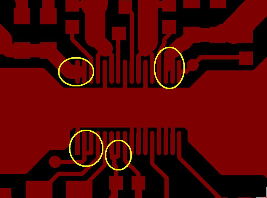

One of my fellow DIYers has observed that there is three solder bridges on the IC's that have been installed on the boards that I have supplied.
There are actually four places that a solder bridge can take place and not be a bad thing.
See also post 171 on page 18. You can see 3 of them in the right photo.
This is why I have tested all of the IC installed boards with a test setup that runs music through to a speaker through both inverting and non-inverting inputs. (Test setup in post 203 on page 21)

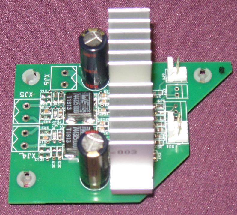

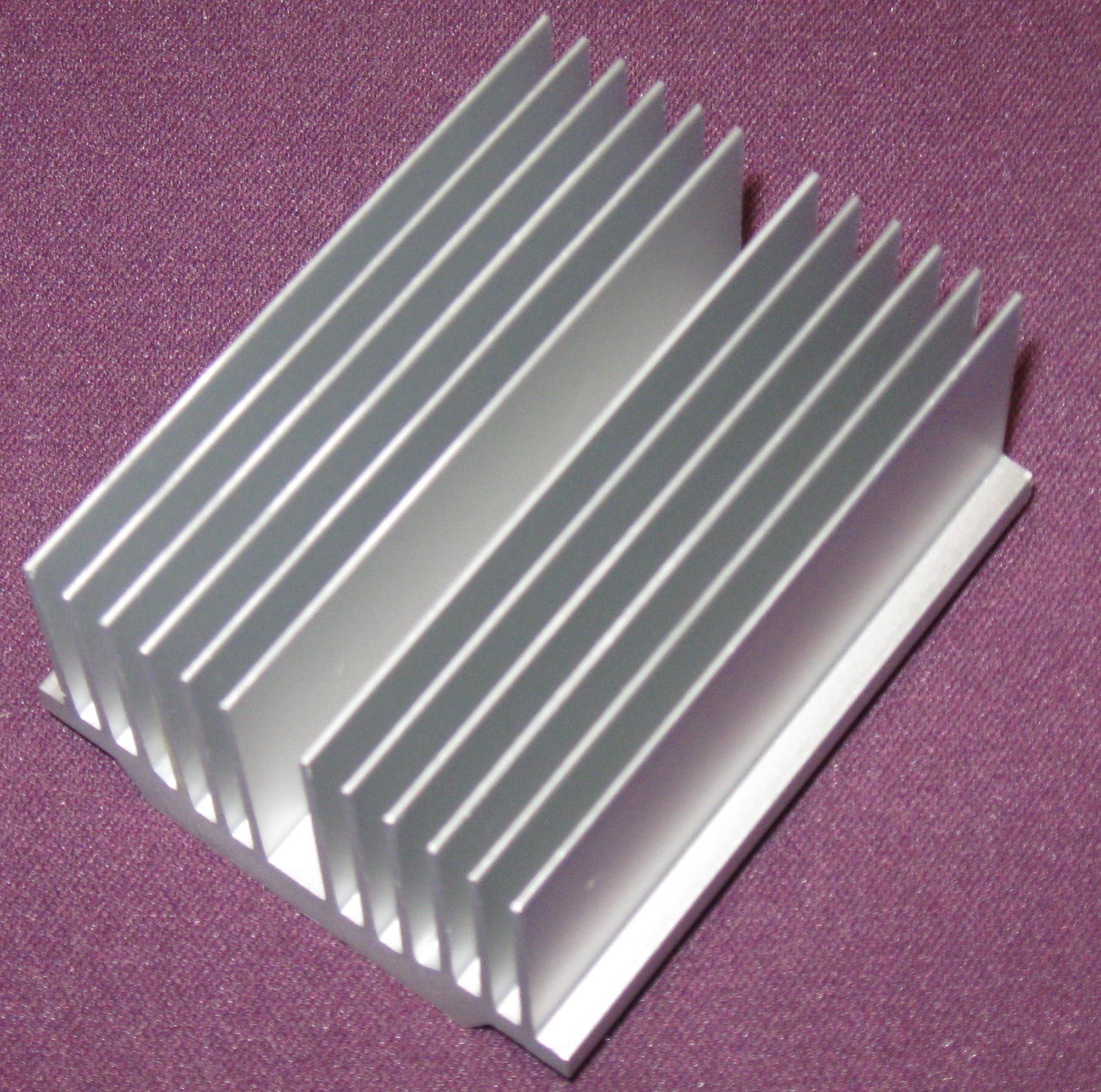

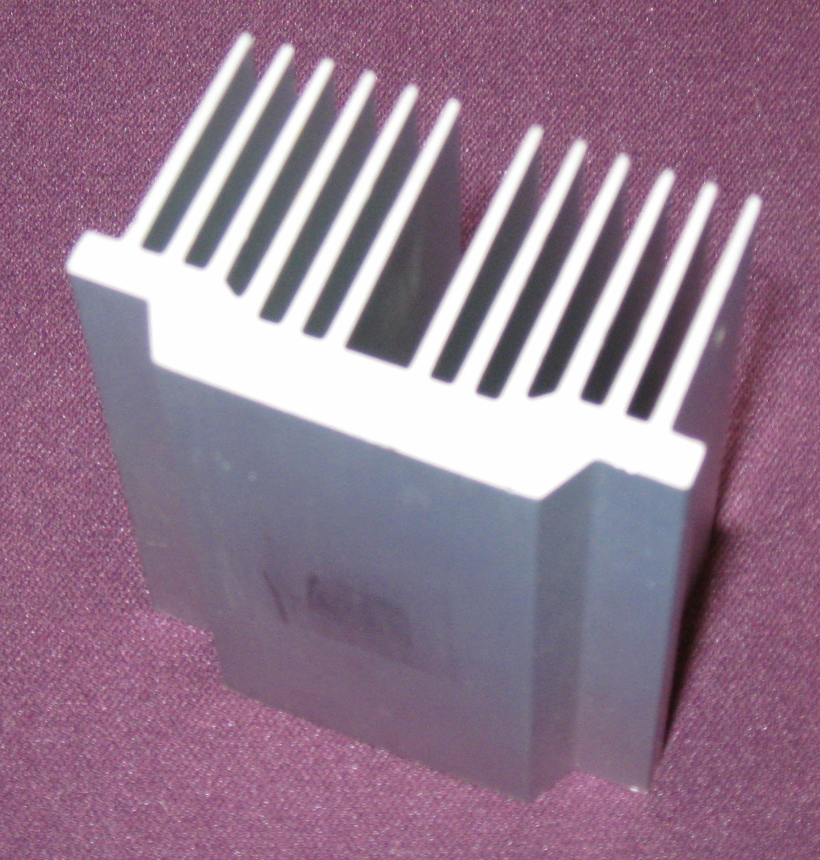

What's a good heatsink to use on the chip? I know some run without one. BTW, I got a quote for the heatsink TI suggests and it's $35/ea with min. 10 units. Hoping for something way cheaper.
BK
BK
Well, you could try something like these for a little bit of dissipation:
Thermal - Heat Sinks | Fans, Thermal Management | DigiKey
I used a large band saw to slice a computer heatsink.
Some have not used a heat sink, some have soldered some copper pipe to the top. (adventurous)
Doug
Doug
