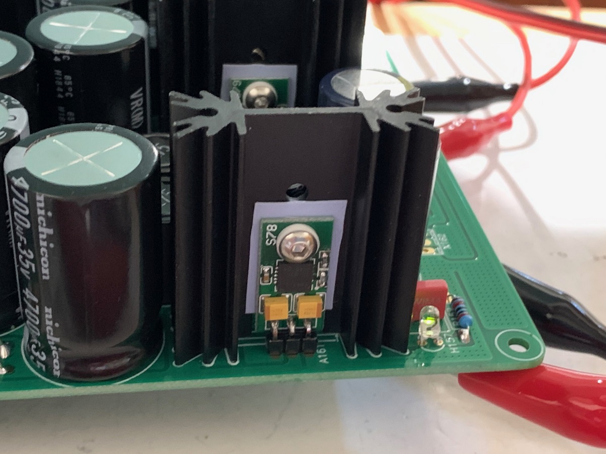

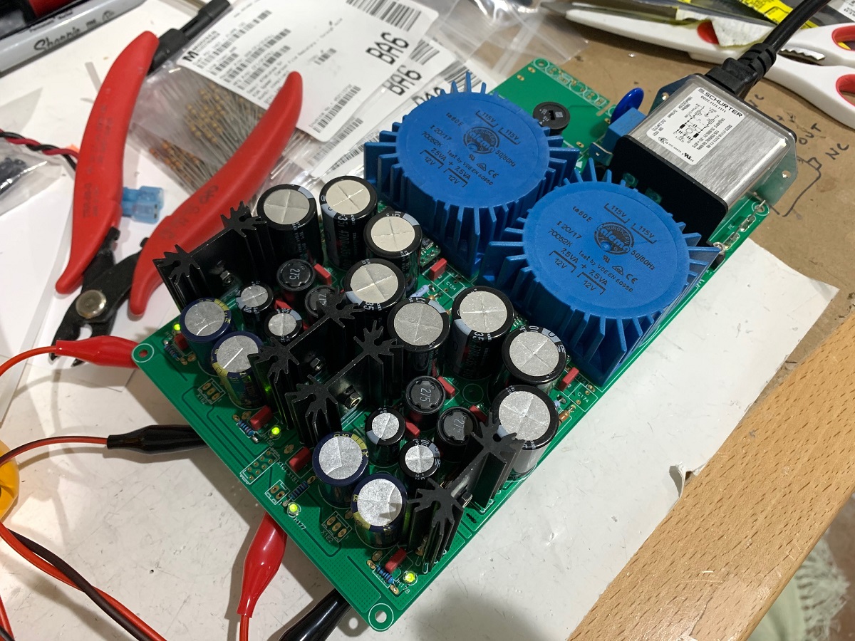

Alternatively, you can get the Yarra preamp main board and PSU. It is dual monoblock with +/- output that has linear trafos, diodes, to CRC, cap multiplier.
Or gen 2 is trafo to active bridges to CRCLC filter then to 78XX/79xx format regulators or TPS7A4XXX LDOs.
832436d1586493725-yarra-preamplifier-hpa-melbourne-db-buy-yarra-ldo-psu-test-02-jpg
https://www.diyaudio.com/forums/gro...ier-hpa-melbourne-db-buy-127.html#post6155523
IMO, this is the finest preamp/headphone amp dual monoblock regulated PSU one can have for projects requiring the best of the best power supplies.
Miniature active bridges eliminate diode switch noise:
832434d1586493725-yarra-preamplifier-hpa-melbourne-db-buy-yarra-ldo-psu-test-0-jpg

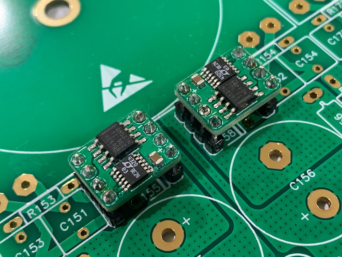

TPS7A4XXX LDO’s have 4uV rms noise:
832438d1586493725-yarra-preamplifier-hpa-melbourne-db-buy-yarra-ldo-psu-test-04-jpg

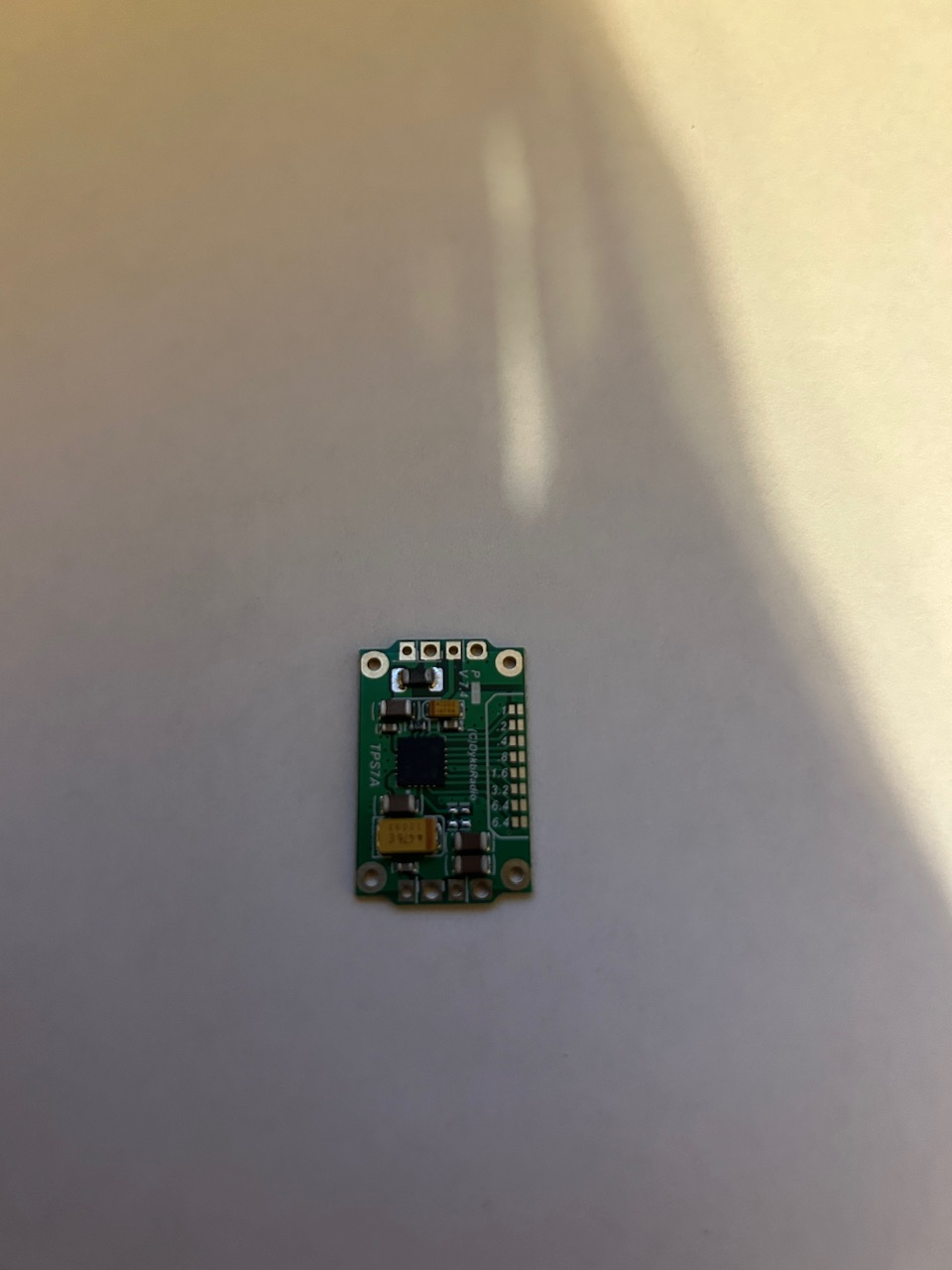

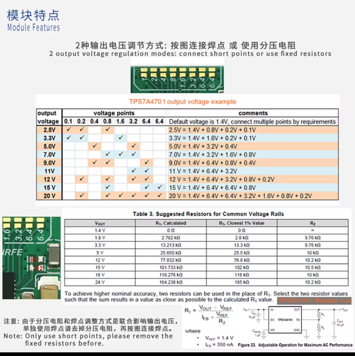

I wanted some more of those Aliexpress tps7a4701 3 pin regs in various voltages but they are NLA at the moment atleast.

Edit Feb 25, 2019: Member Twocents was a beta tester for v1 and he installed an eBay 5v TPS7A4xx LDO board on it - nice work!
738916d1551120241-5v-smps-xrk-psu-low-current-ultralow-noise-5v-jpg

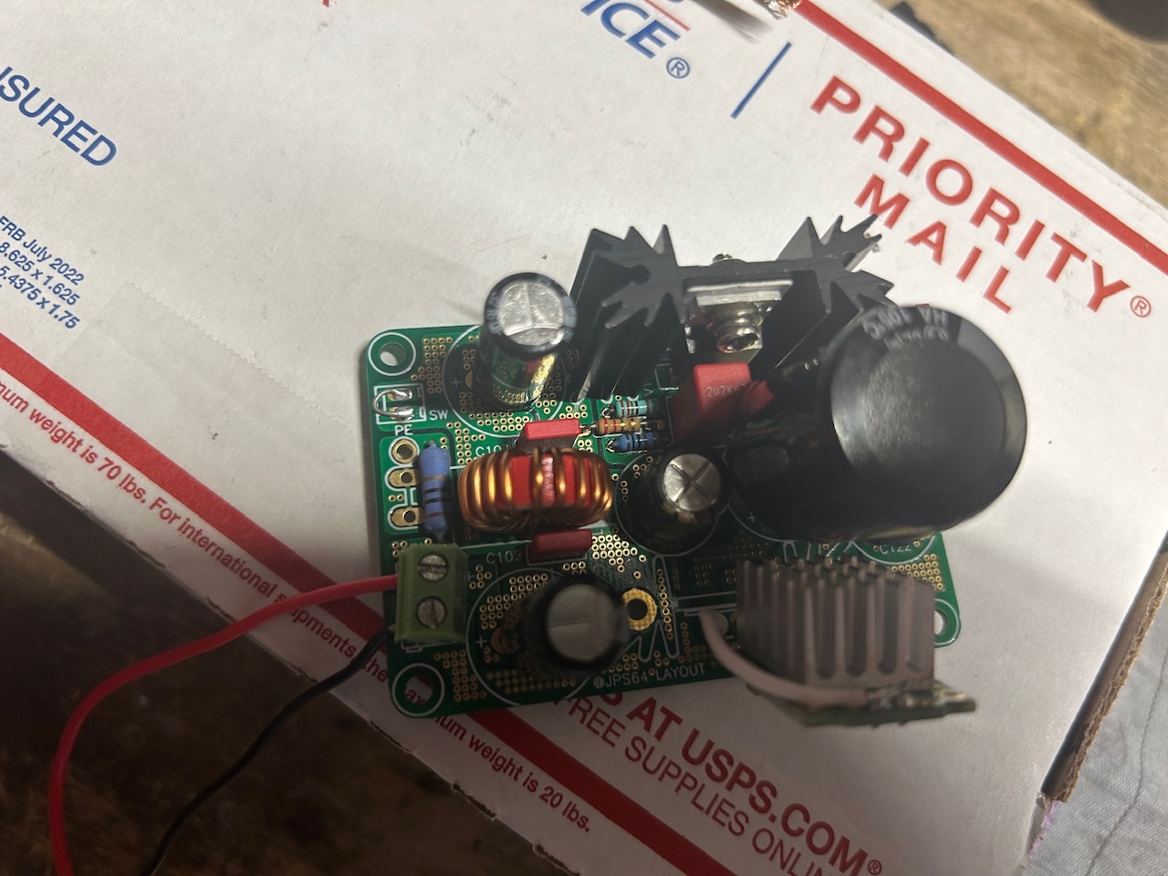

I just bought a couple of these to experiment with and I am going to add one to my ACP+ Preamp with Academy Audio Muses volume control.
I want to use a Wall Wart into the Capmx board but realize a 24V DC will not be big enough. Should i get a DC-DC step up for the desired voltage or find a 30VDC Wall wart to try instead (understanding the voltage will drop)?
The ACP would take 24V off the Capmx but the Academy Audio has to operate from 12-15V and requires a 15V regulator mentioned in the APP Notes from Academy Audio.

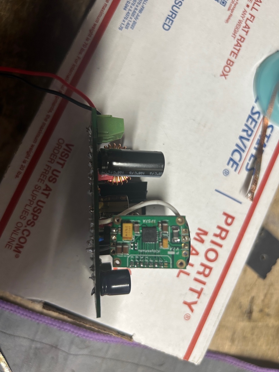

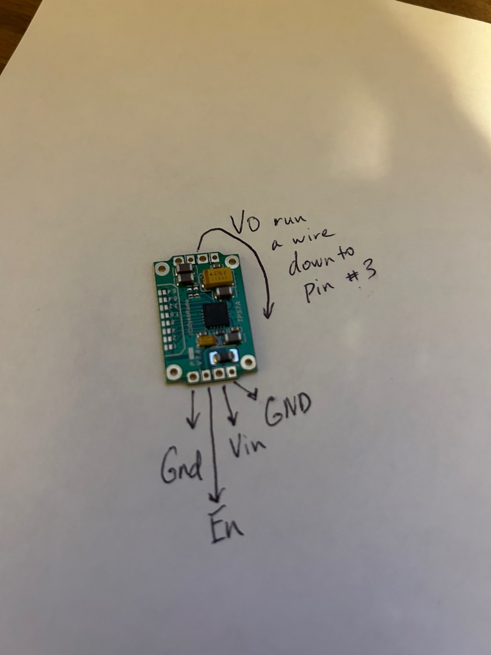

recently stuffed my Capmx board and it works nice at 12V and 5V.
I’m trying to find the easiest way to change it to 24V. Couldn’t find a 32V meanwell psu.
I’ll probably build a 32VAC basic PSU. But need to find a way to add the resistors. I don’t think I can solder ones that small.
