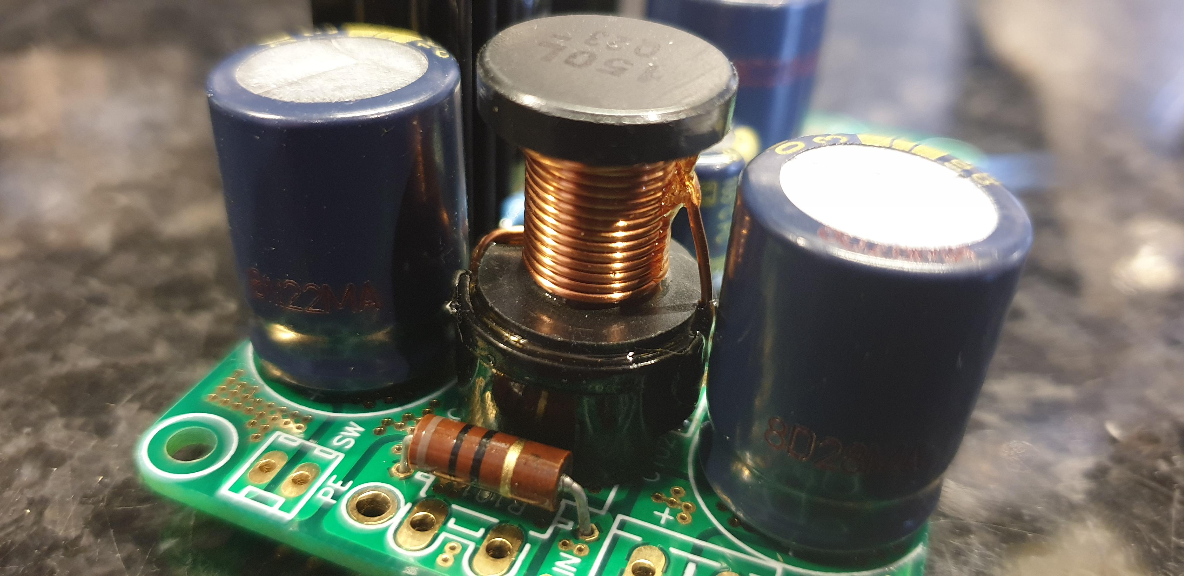

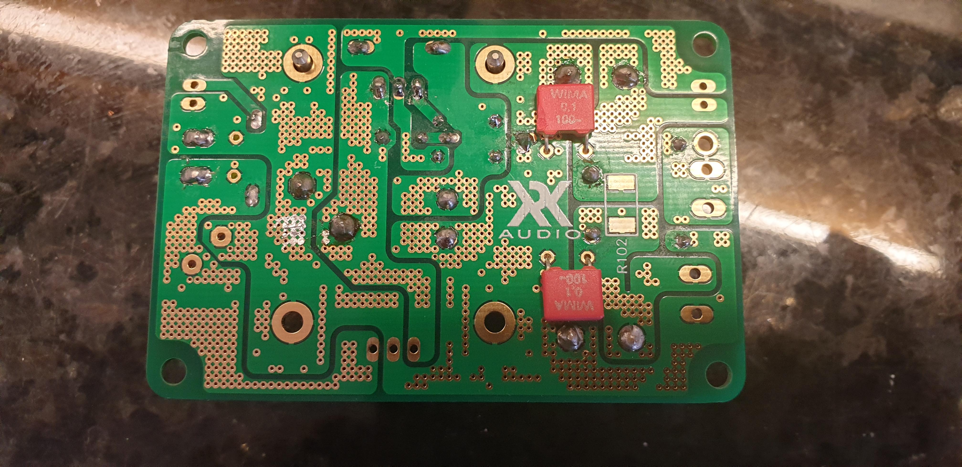

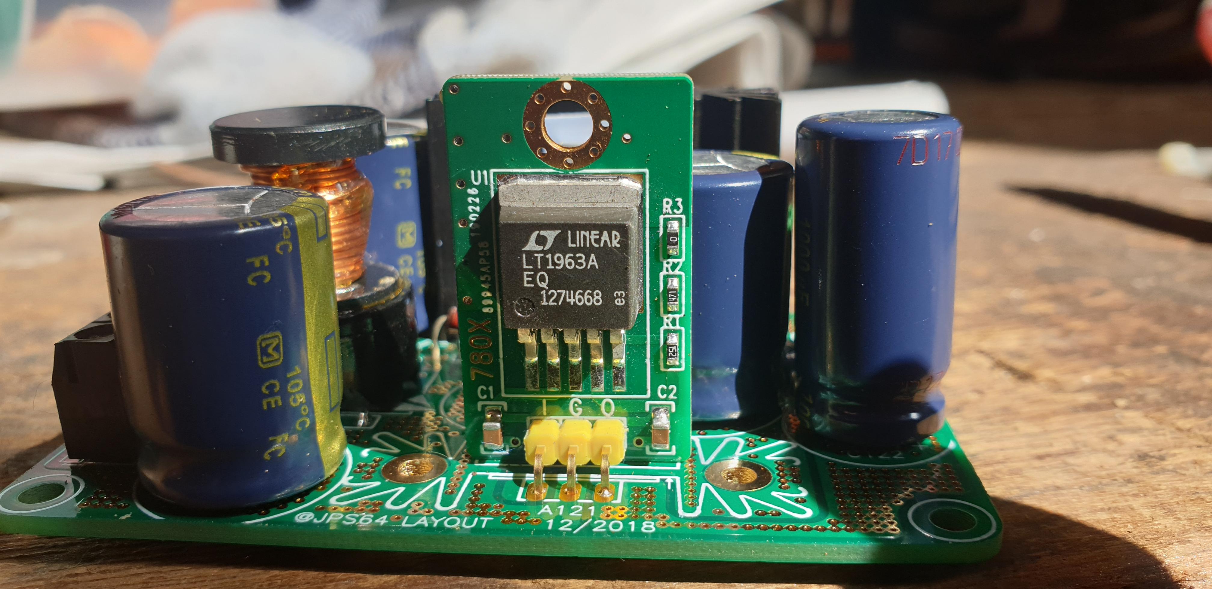

Finally. Built one up....well nearly. Waiting for some Ebay lt1963 3 pin regs.

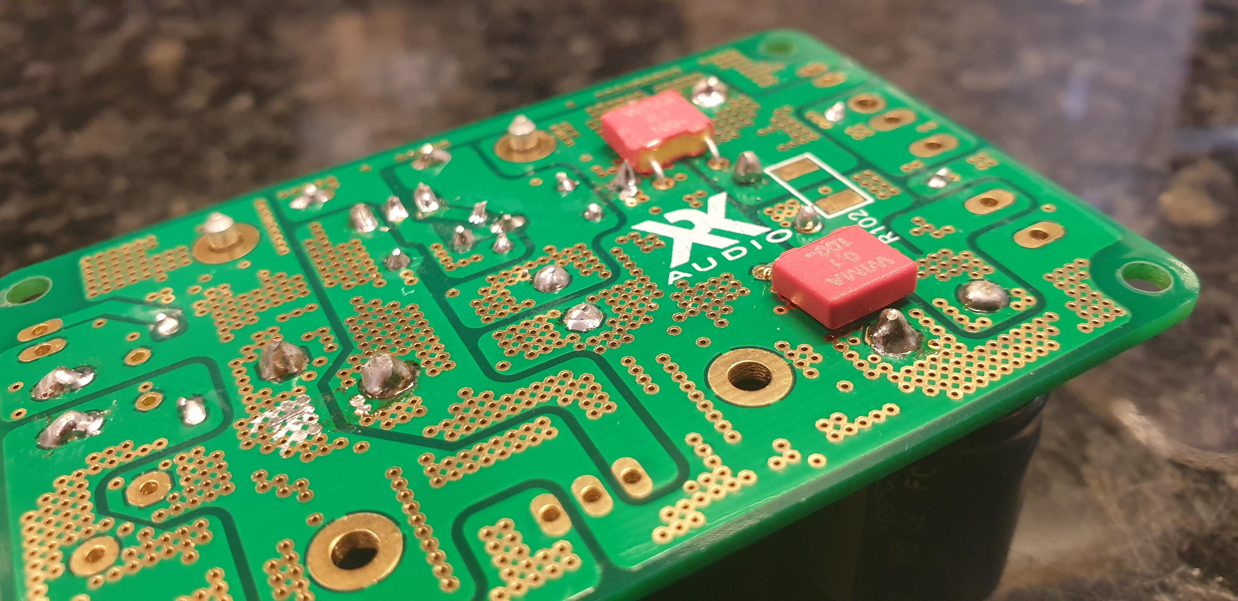

I had to mount the film caps near the L under the board as the inductor is a bit big.

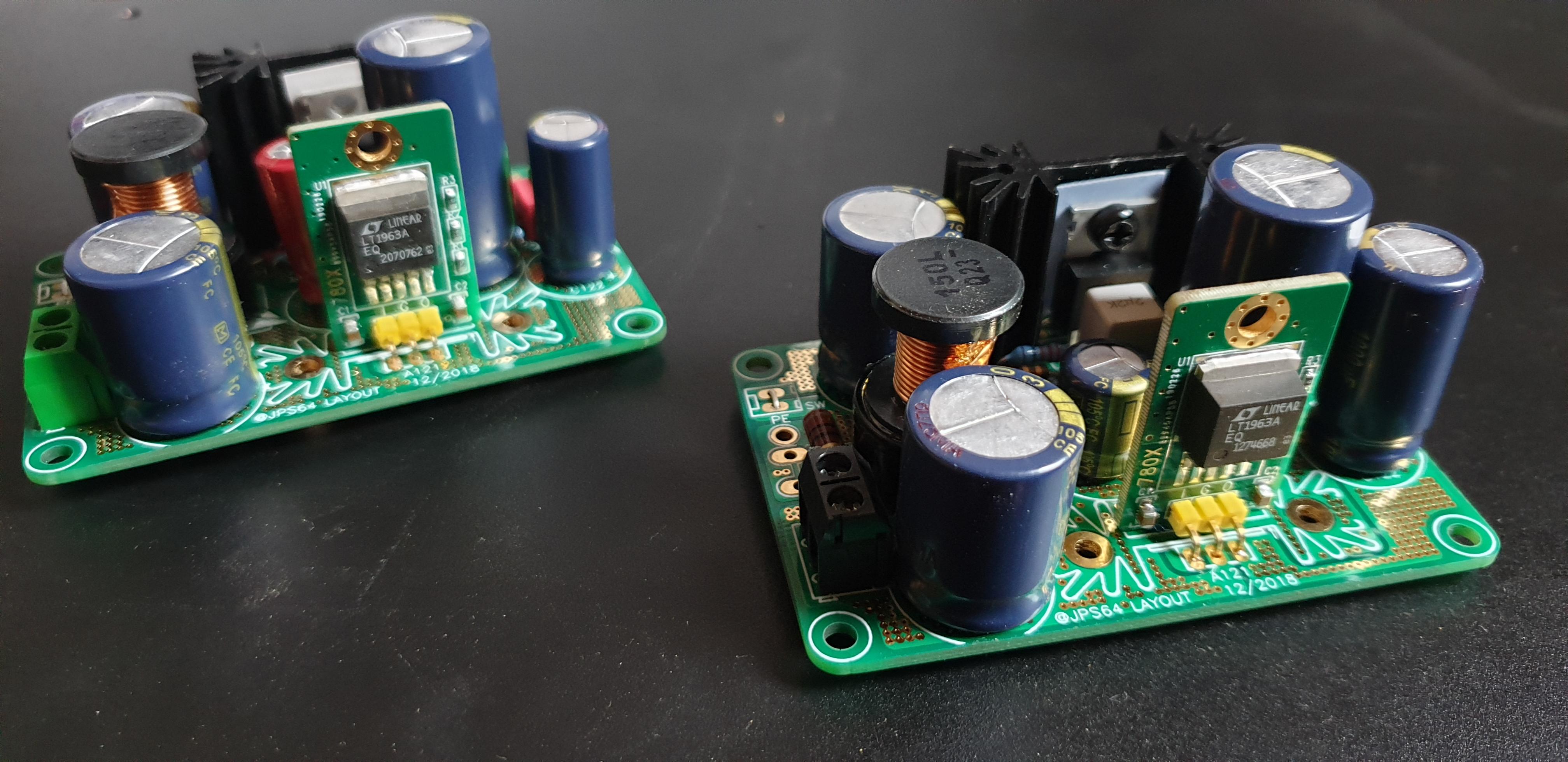

So both of then finished with the Ebay LT1963 set at 5v.
Both are 5.00v. Maybe I could have done with 5.2v for some headroom, I may look at altering the R values but they are tiny.
I made an error on the first build and had 1000uf instead of 2200, so that is remedied. Only had 1 220uf Pana FC for some reason so one has an Elna Silmic 2 in there.
Look forward to rigging them up to some gear!

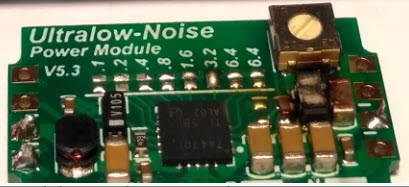

Do you have a link to the following..?
Thx.
X, I was just looking for that particular one with the 'Ultralow-Noise text/logo. on it. I realize there are others. Seems I had seen that one before in another DAC thread I follow and been recommended. Thanks for the links though.

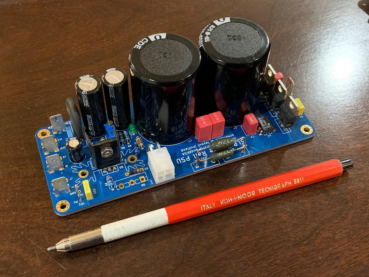

I'd like to use this board to supply both the o/p mosfet in a MOFO at 2A and use a regulated output for the front end gain stage. So, could I use something like a IRF630 in place of the IRF610 and pull a 2A output from across C121 and then take ~200mA of regulated output from the board's DC output?
cheers
Beardy
Hi Beardywan,
Vunce is correct. This particular PSU is really meant for smaller devices under 1A like headphone amps and preamps. For the MOFO, you want the SLB single rail. It has superb low ripple and will give you some nice silent black background.

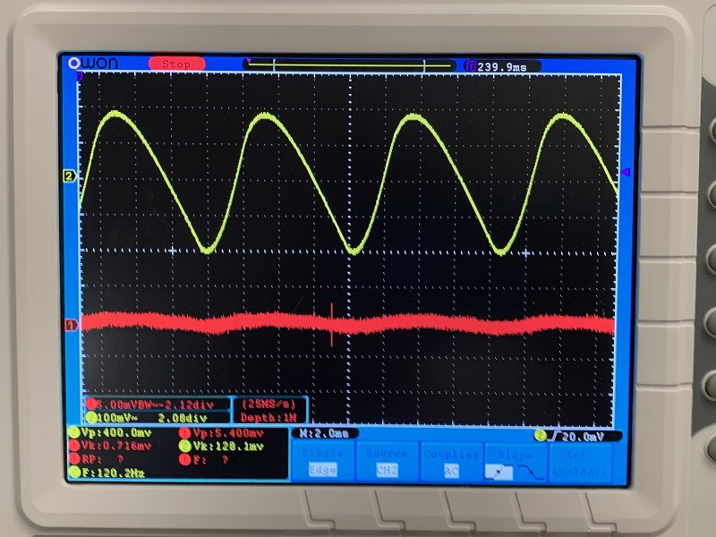

Here is a scope shot showing upstream ripple vs downstream after the cap Mx for 3.75A (30v into 8ohm dummy load) showing 0.71mV rms ripple:
