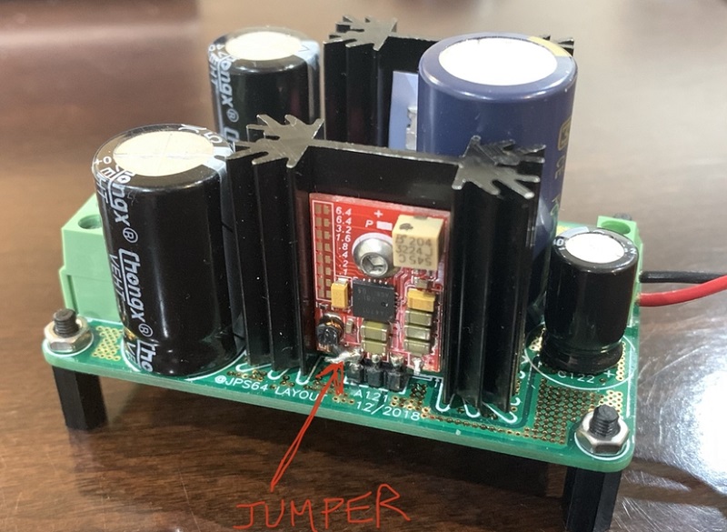

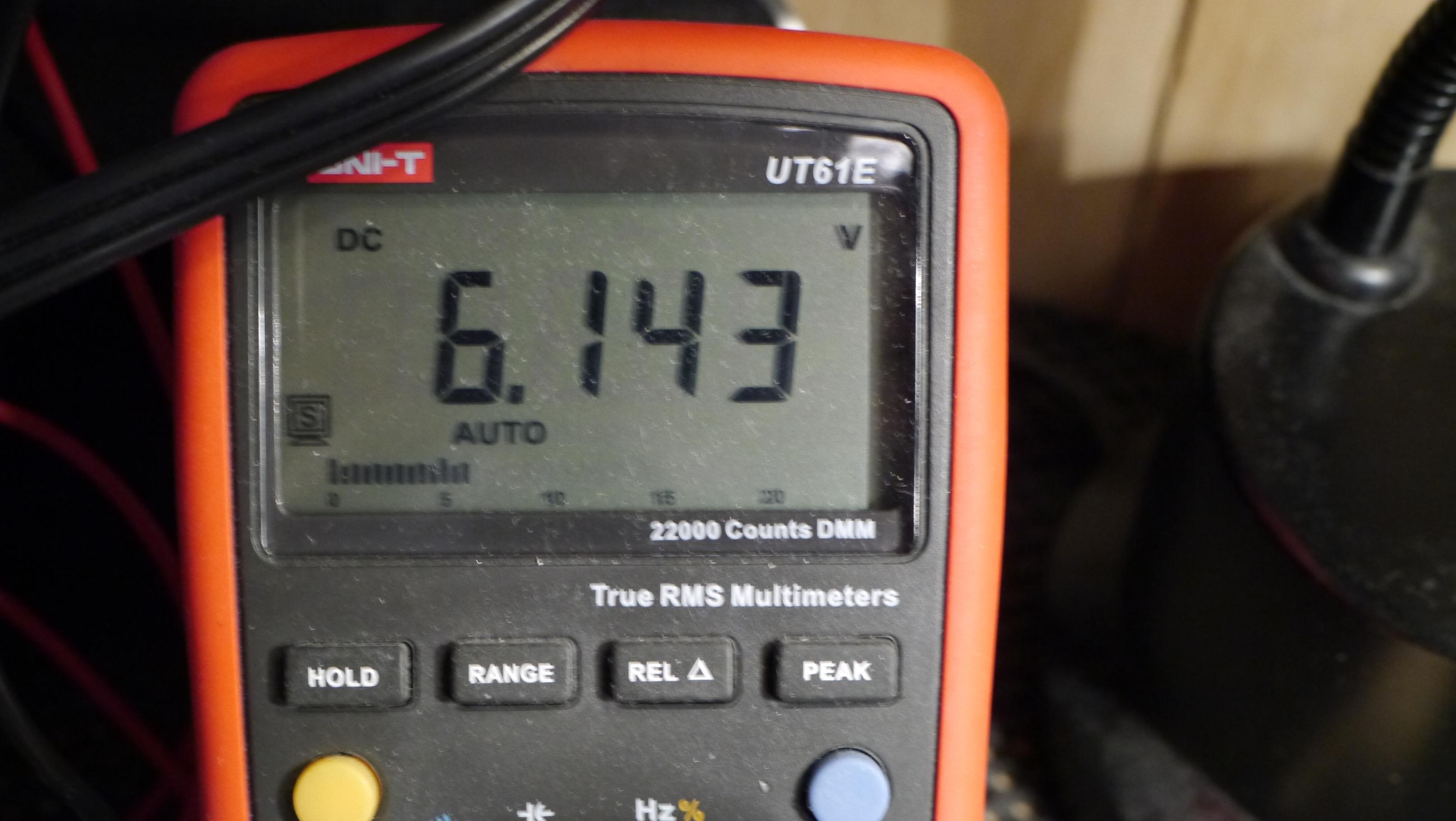

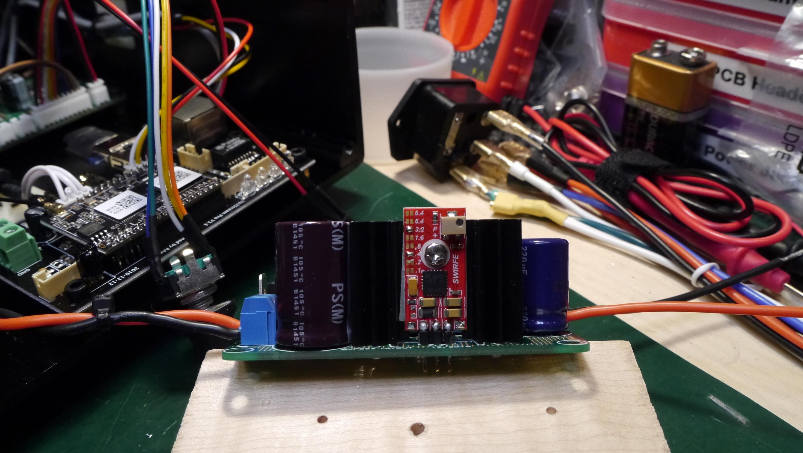

I'm trying to put to use your simple cap-Mx PSU along with a TPS7A74xx LDO board. I've set the output voltage to 5.0VDC on the LDO, and using an upstream SMPS PSU of 12VDC. As can be seen in the photos, I'm getting 6.14 volts instead of 5 volts Is there some other part I need to substitute on the cap-MX board to achieve a 5.0v output?

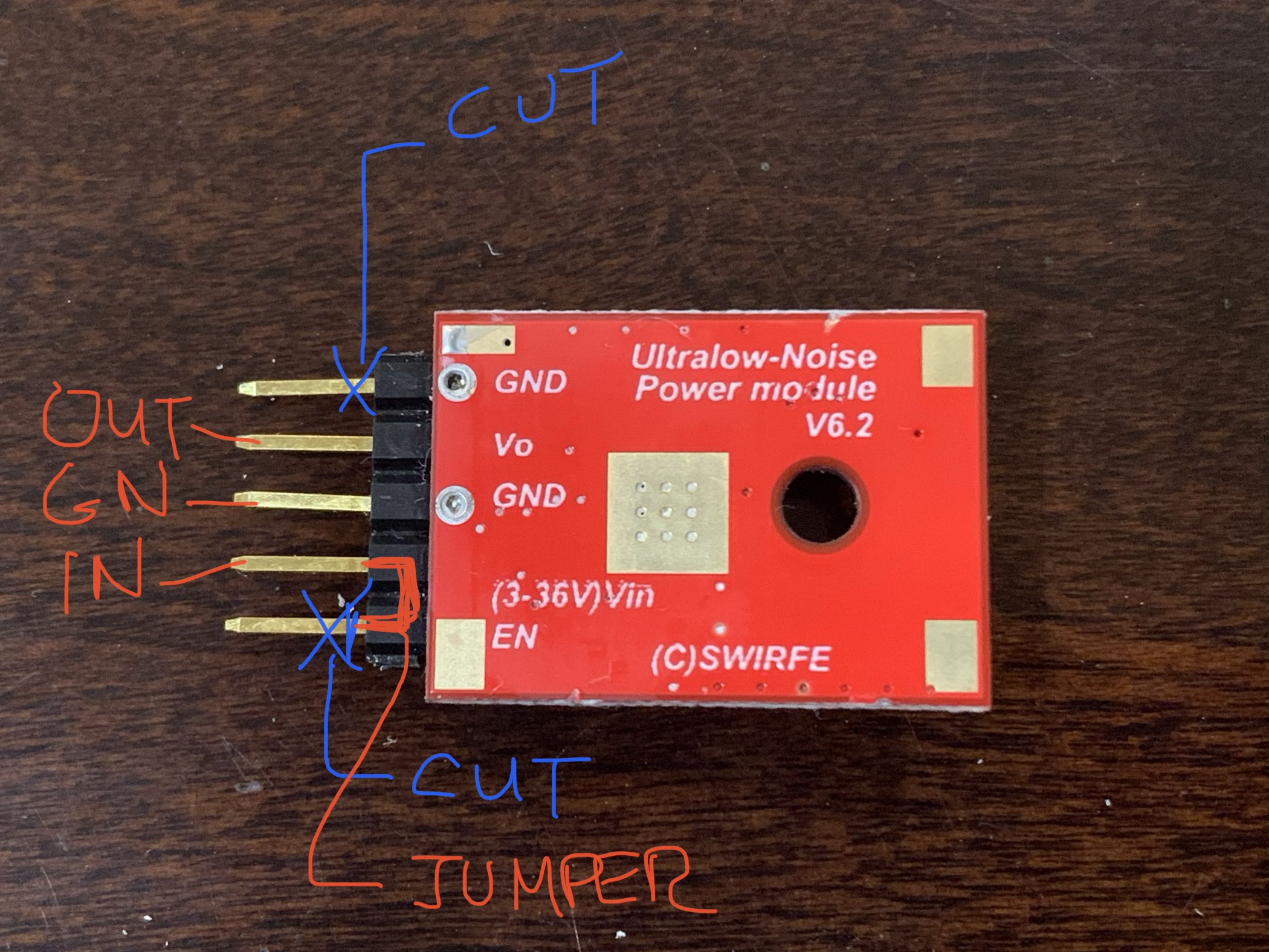

Pin 1 is EN and tied to Pin 2 (INPUT), Pin 3 is GND, Pin 4 is OUTPUT, pin 5 is GND.
Cut pin 1 and 5 to allow use as 78xx regulator. Pin 4 is internally tied to SENSE on the chip. Pin 1 needs to be tied to Pin 2 to enable operation.

Thanks for that. I did read later that EN was for enable. However, even after shorting pin 1 and 2, I was still getting the same 6.14VDC. I'm trying another LDO. My son is desoldering the original as I write this. I had only tacked it in place to test.
How are you setting the voltage? With pot of programming jumpers? The pot can be adjusted to get you any voltage you need by monitoring the output voltage and turning the screw. So not sure how you set it to 5v?
Edit: your image shows the programming pads. But you need to disable the pot as it was set up for the pot. You will have to remove the pot or one of the fixed resistor. I would just use the pot.
How are you setting the voltage? With pot of programming jumpers? The pot can be adjusted to get you any voltage you need by monitoring the output voltage and turning the screw. So not sure how you set it to 5v? I tried setting the 5v by shorting the correct pads. My son tried just using the trim pot and was able to dial-in ~5V. I think we've figured it out. Thanks for your assistance.
