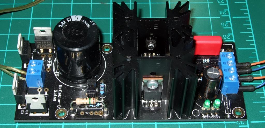

It was a very easy build, it took me 45 minutes to complete and then start testing, and got near target voltages rather easily via the LED swaps.

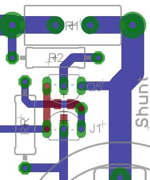

I don't even have a DAC and i want a pair of these! Other than the 2SK117s, are any of the parts hard to source? Since I'm not in a rush I might enjoy getting the parts myself.
There is a modern Toshiba SMD equivalent mentιoned in the guide, also special pads for it (red flats in the pic), and info on what RR value if GR or BL for both TO-92 and SMD. Avoid eBay especially for semis. There are pads for fancy R1 and R6 too. Caddock MP930 and Vishay VAR. Those two parts can cost as much as all the semis and all the nice 50ppm-100pm resistors together though. But don't build with generic passives either. At least at the quality level listed and tested already. :cool:
Joined 2006
Yes, order yourself some Toshiba 2SK880GRs. If you look closely, mine is running one on an adapter board, only because it was previously being tested that way also in a BIB, and I could desolder quickly for another couple I had at different IDSS values. They are difficult to work with, as they are very small, but with some tweezers, no jitters, and a little solder they go on fine. If I can do it, probably most can. I am uncoordinated and most certainly half-blind from mid-life old age :D:p;)

Here is a side shot of my own test build too. Keep in mind that some pad details will be produced as on the first rendering in post one. So to can fit VAR R6, MP930 R1, third LED for 7V pre-reg use, 5mm & 7.5mm pitch C2 etc. Will also have the two extra ventilation holes at the sinks inside pcb floor area.
