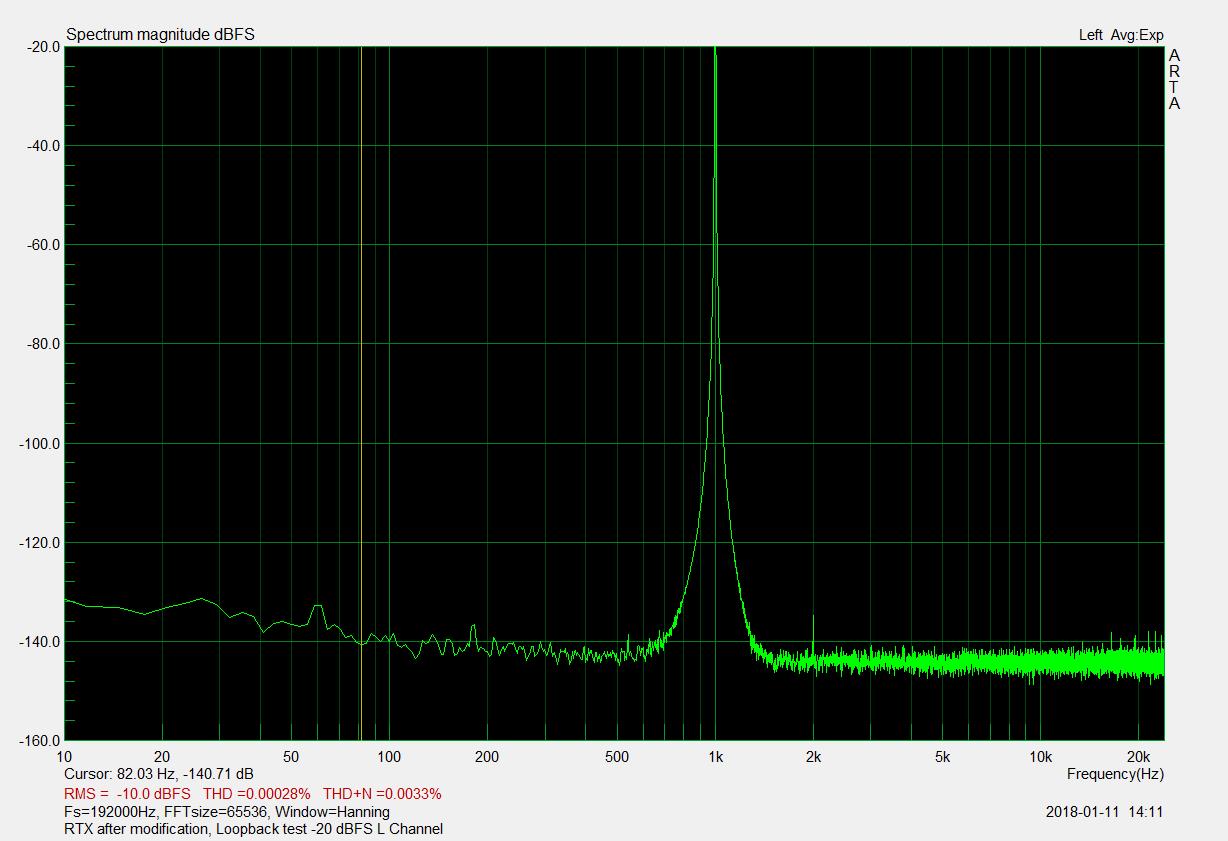

After modification tests

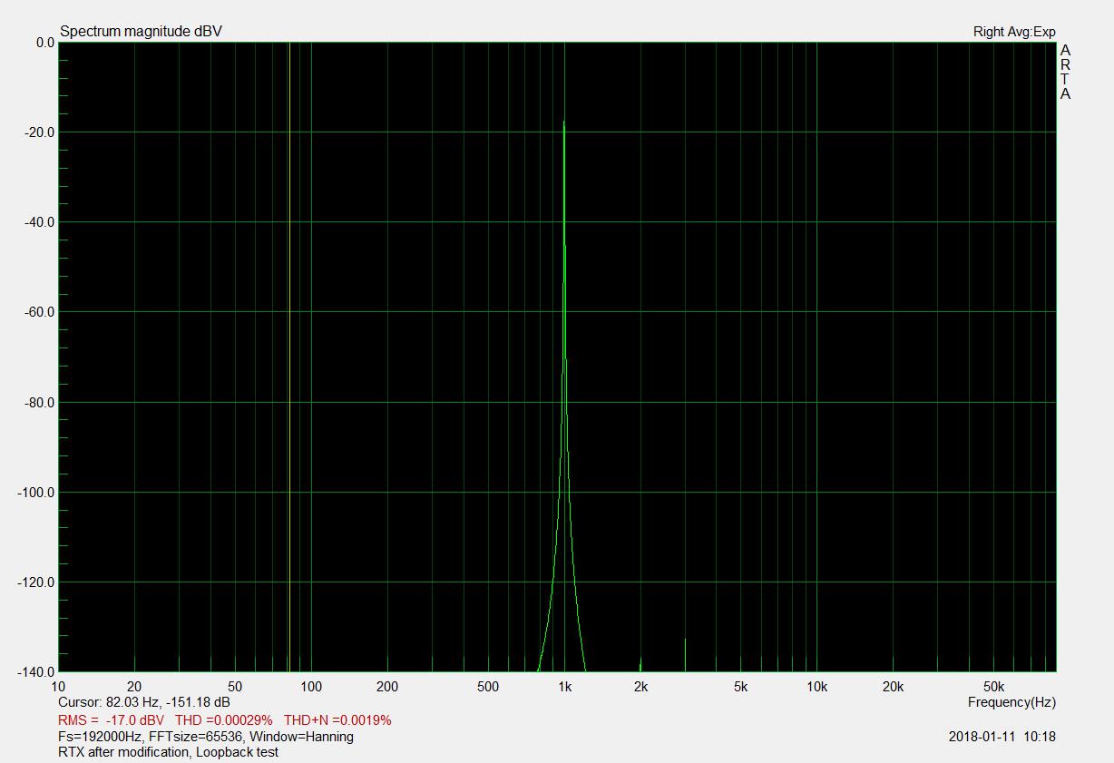

Here are some tests made with the RTX 6001 right now -
The output channel is at 1 V and the receivers set to 10 dBV.
-Chris
-Chris

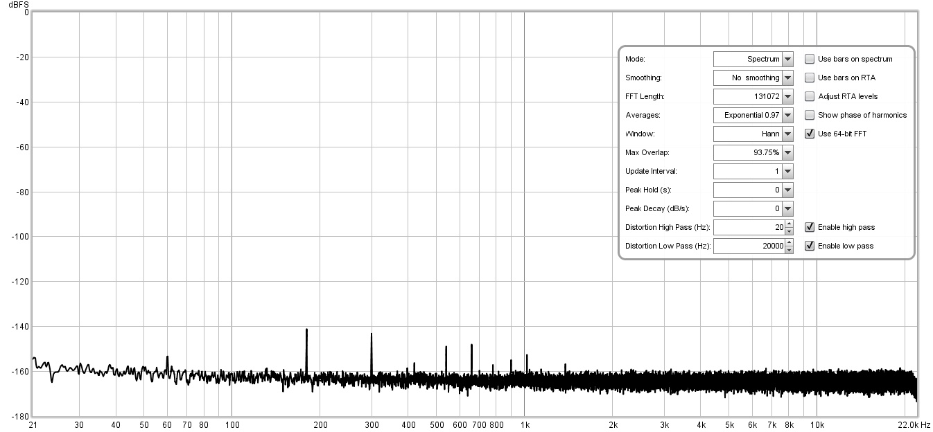

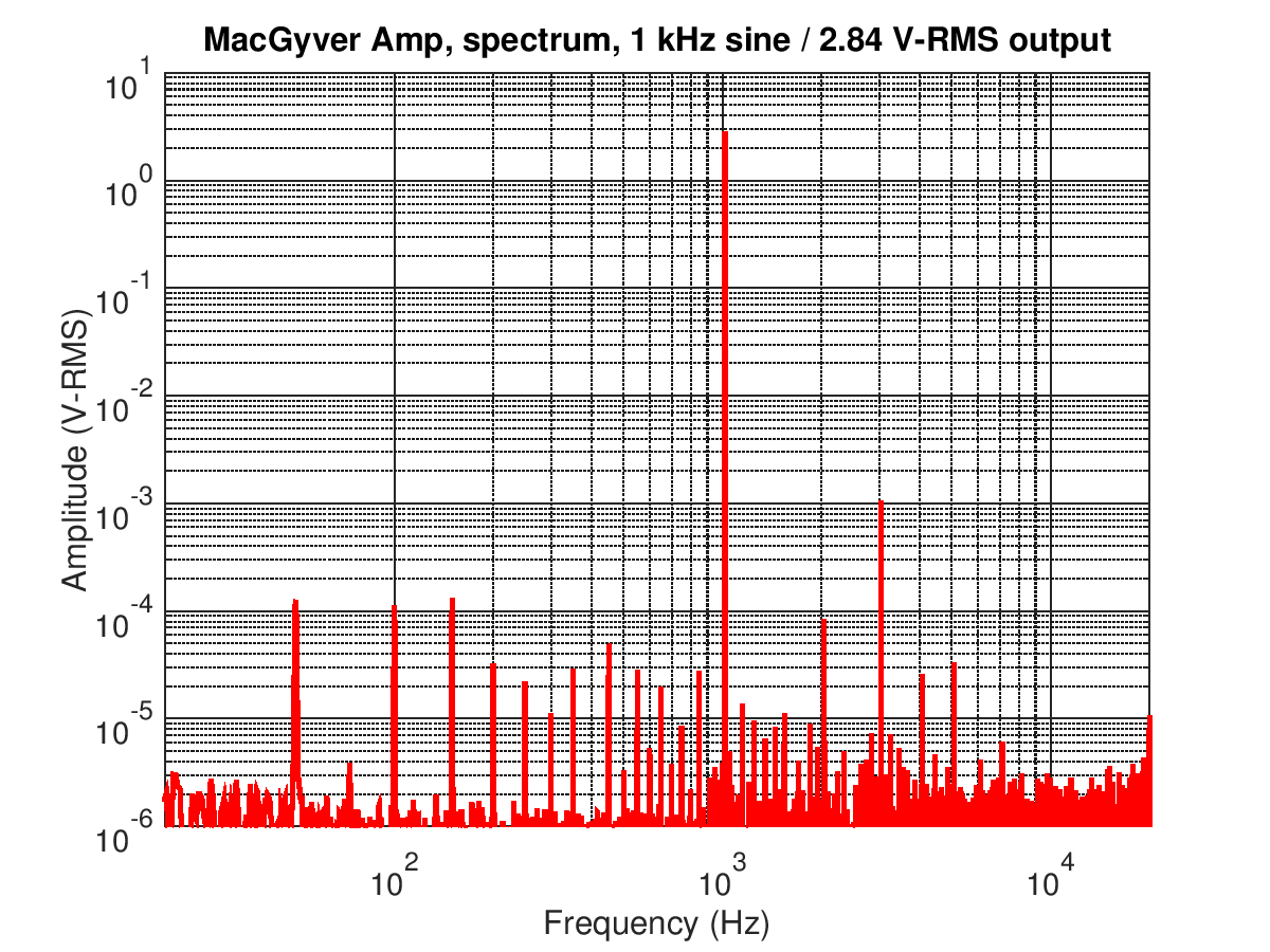

Here's one of my measurements using the RTX on my current tube amp project. I would like the mains related peaks a bit lower (50 Hz, 100 Hz, 150 Hz, etc.). These peaks go much lower if the RTX output is disconnected from the amp, and the amp input is shortened, thus measuring the amp's self noise only. Do I have a ground loop in the test setup?
Do you connect the output of the amplifier differentially to the analyzer input?
And what about the shield of the cable to analyzer input?

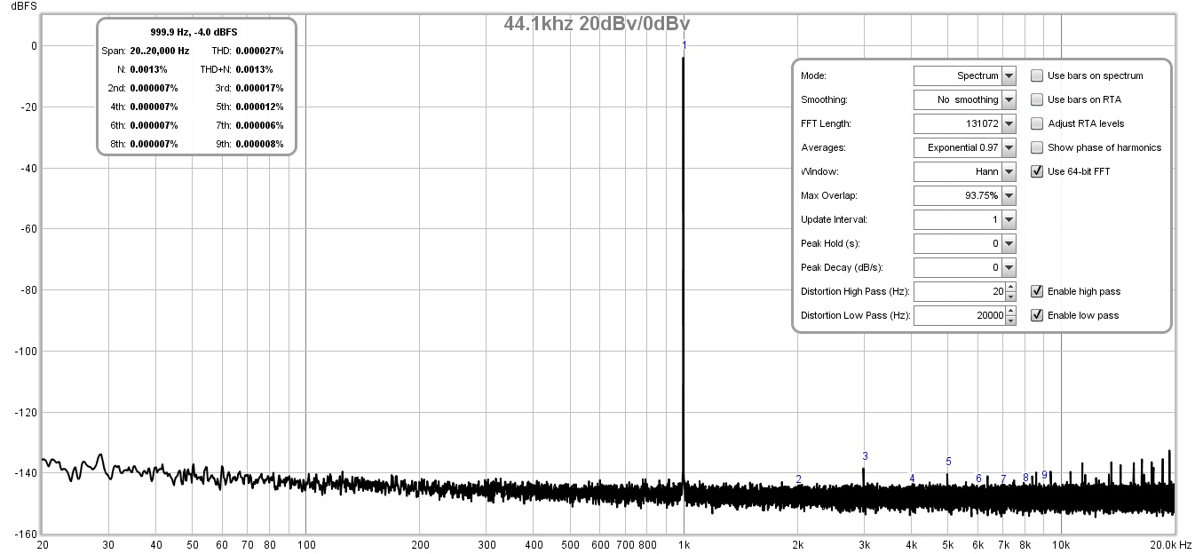

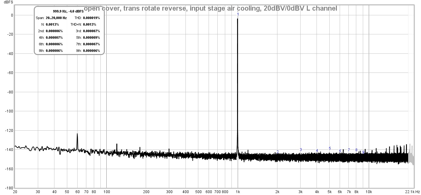

I found RTX6001 can have a pretty decent THD in the loopback measurement, if the transformer is upside down and rotated to make the wire-output facing to the opposite direction of the main PCB. It also reduces the harmonics of 60Hz for the -20/-10/0dBV inputs dramatically. Forced air cooling helps to reduce the 3rd harmonic in the 1K sine THD test and keeps the THD value between 0.000018% and 0.000020%, an extremely stable reading.
That's quite good. Do you have before measurements? Which change made the largest improvement?

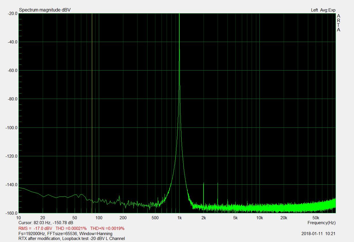

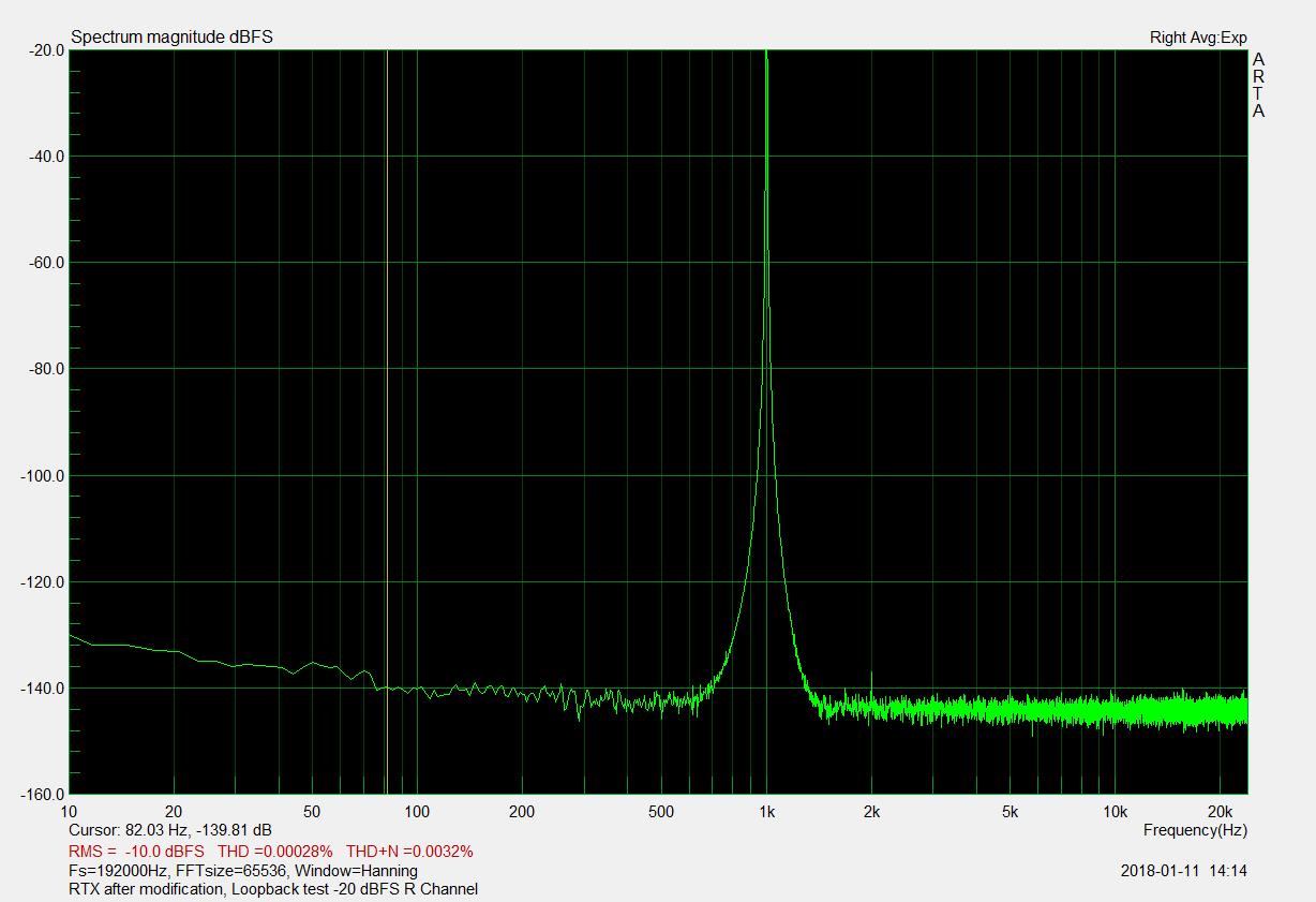

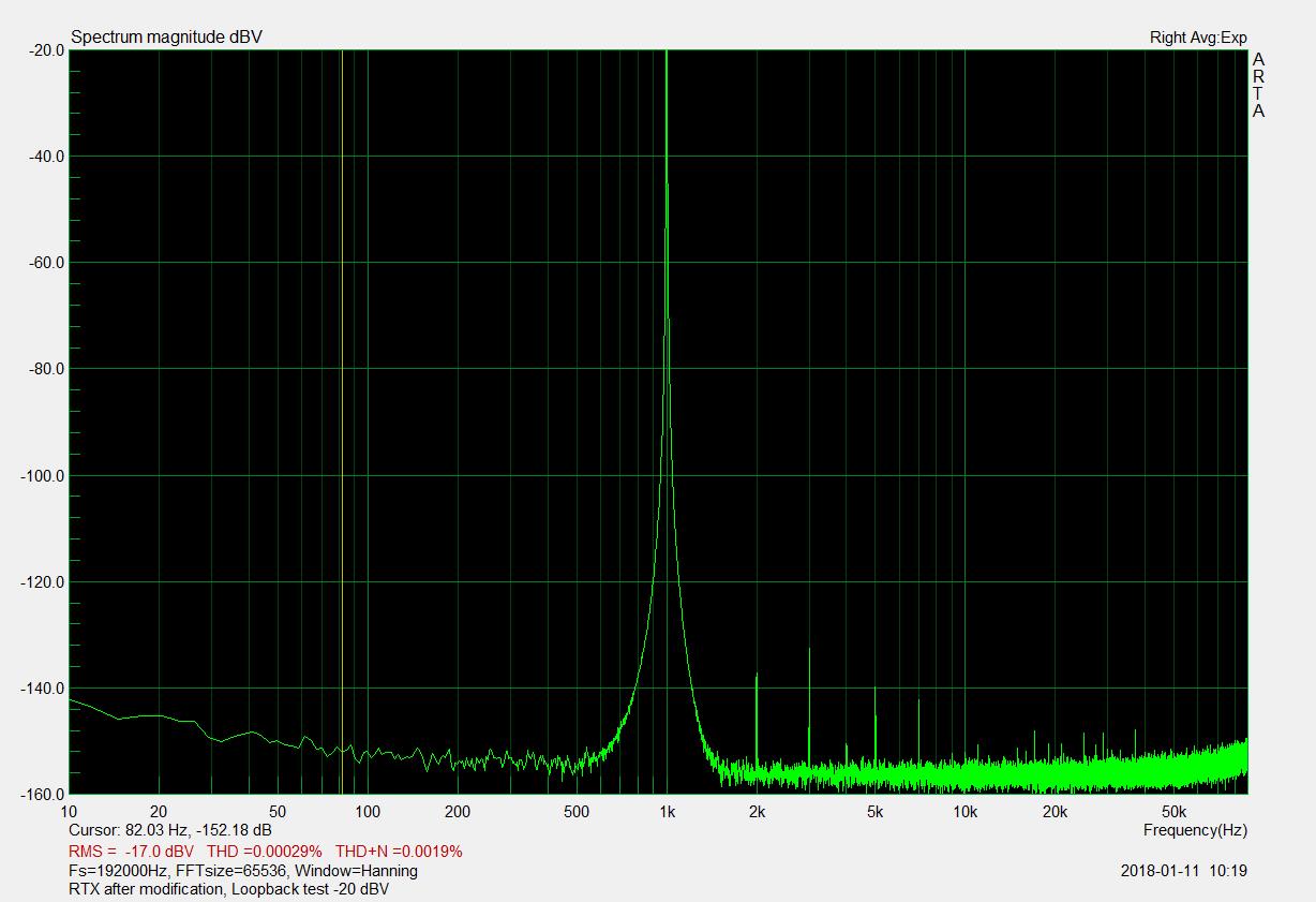

Hi Jens,
I think this is how you wanted it set up, here are the loopback tests. Please let me know if you want anything else, or if it isn't what you expected.
-Chris
-Chris
You should probably try to increase the FFT window size. With a 64k FFT a lot of what's included as harmonics is in reality the noise floor. The second harmonic seems to be around -123 to -126 below the fundamental. The other harmonics are more or less buried in the noise floor.
Yes, I use the XLR output of the RTX ("XLR pos" to amplifier audio input, "XLR neg" to amplifier signal-GND).
I have tried connecting the XLR shield/chassis to the amp chassis, but this made no difference to the mains related peaks.
The amplifier has a ground loop breaker to separate the audio-GND from chassis/safety-earth.
Hi Chris,
I just realized that limitation too. I normally use audioTester, where the maximum FFT size is 1M.
Still, I don't quite understand the numbers shown by ARTA when looking at the spectrum. But I am no expert on ARTA either.

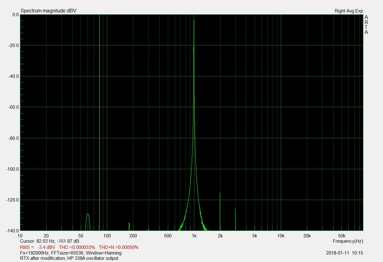

I have a QA190 and a Micsig DP10013. <snip>
Do you have a similar measurement, after the modification?
Interesting,
Are harmonics really there? I would suspect that they are.
Why did they go away using the differential probe? Is there something going in the voltage divider between the probe output impedance and the analyzer input impedance?
I like the idea of a 10:1 or 100:1 probe to use testing higher voltages.
DT
Hi DT,
The differential probe should have an output impedance of 50R. It will be fine with the RTX inputs at these frequencies.
I tested another signal source before modification and got the same display. After the mod the FFT didn't have all that stuff.
-Chris
-Chris

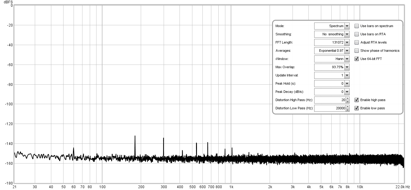

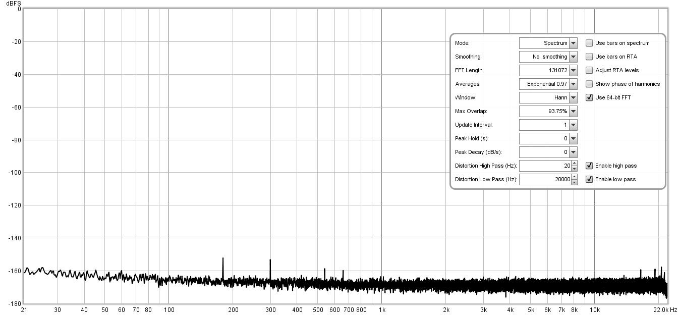

Attached are the before measurements.
Each change made an improvement in some aspects, but not for all aspects.
Sometimes it's a deterioration in some aspects.
The best setup for now is to make the transformer upside-down and rotate it a bit, and slide 2~3 sheets SPTE steels covered with aluminum foil, into the top cover of RTX6001.
I also attached the measurement with top cover opened, and using my hairdryer to cool down my unit. It can be seen that the 60Hz peak is quite strong without top cover installed, but the THD is very low and stable with the cooling air.
BTW, any modification may void the warranty. If you also want to try the above-mentioned setup, it's at your own risk.

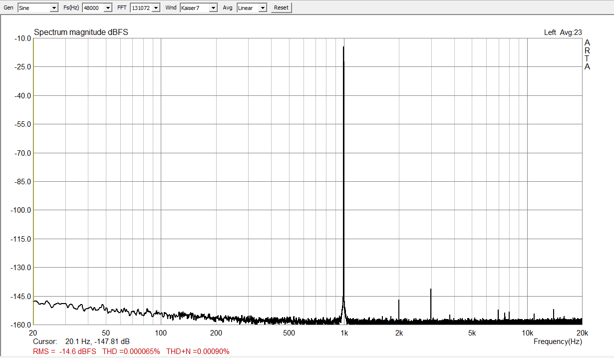

Dear Chris,
There is something fishy with your spectra.. I think You are using non-appropriate windowing. For this you get that broadening. Try Kaiser 7 window, linear averaging.
64 bit FFT.
All these also get into the numbers..
Ciao, George
64 bit FFT.
Ciao, George
