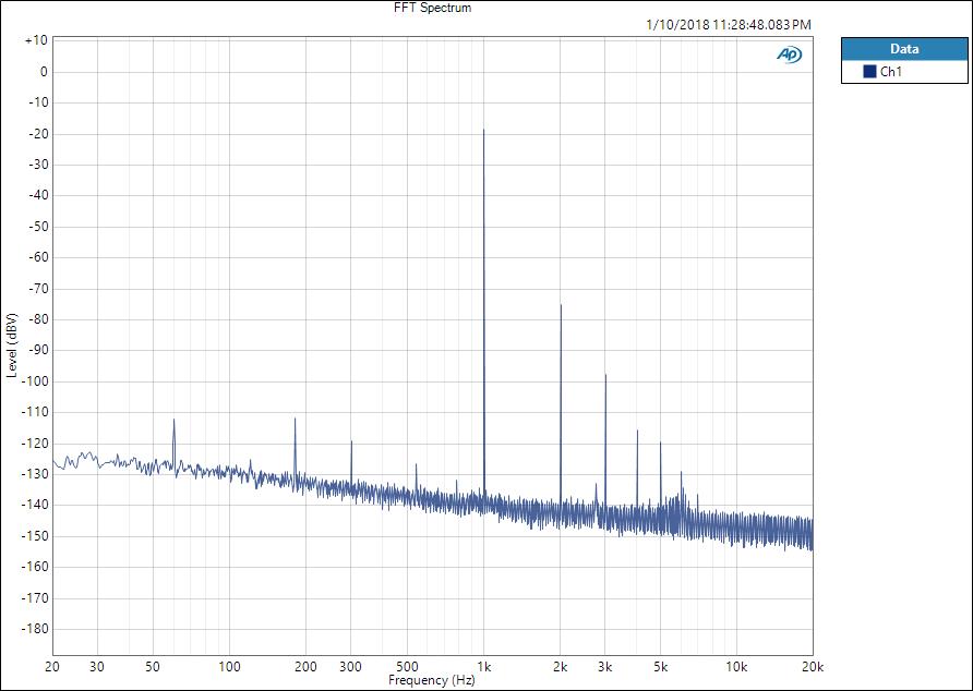

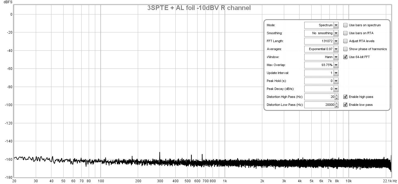

This is the QA190 attached to the RTX measuring a Hypex NC400
This is the same without the diff probe before the RTX was fixed
The unit performs well. On some things like the Hypex amp, I'd like to see a cleaner DAC, but it's good enough. I'm hoping John gets the power vs distortion sweeps added to REW soon.

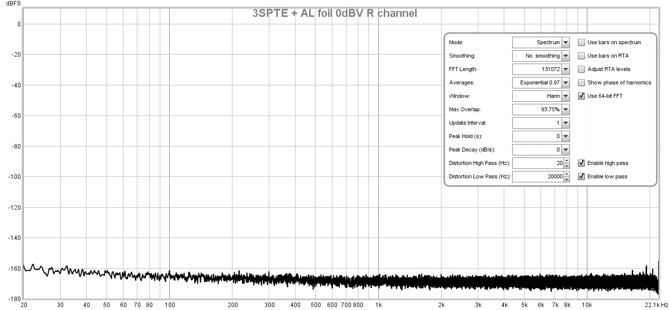

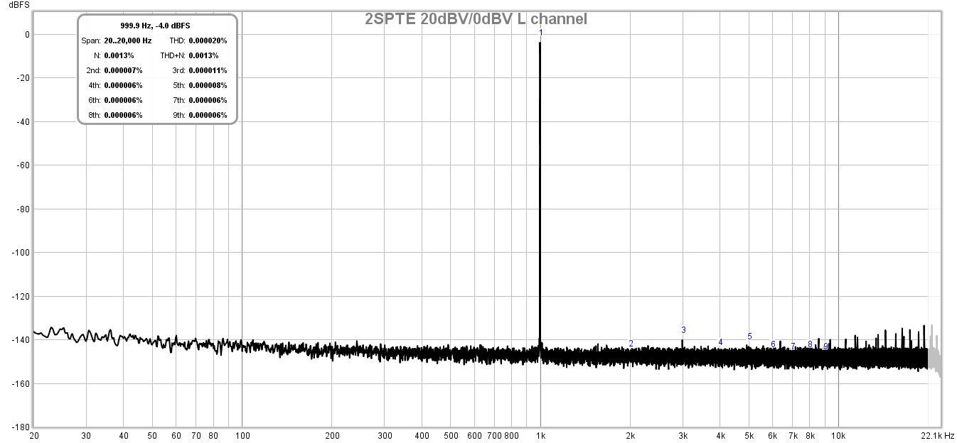

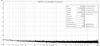

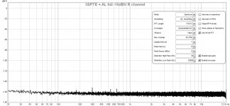

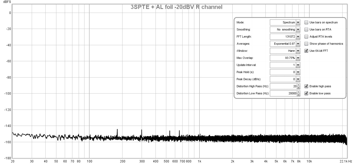

I found RTX6001 can have a pretty decent THD in the loopback measurement, if the transformer is upside down and rotated to make the wire-output facing to the opposite direction of the main PCB. It also reduces the harmonics of 60Hz for the -20/-10/0dBV inputs dramatically. Forced air cooling helps to reduce the 3rd harmonic in the 1K sine THD test and keeps the THD value between 0.000018% and 0.000020%, an extremely stable reading.
