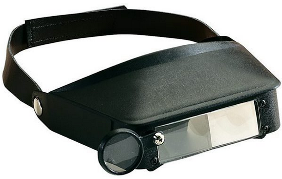

I normally use this for this kind of work.
It's got two selectable magnifications plus the round lens. I rarely use the round lens though.
If space permits, I prefer to use my Mantis Vision microscope. But for this, where the PCB is mounted in the chassis, the limited space makes the headband magnifier easier to use. Even i Denmark they cost less than the equivalent of USD 10.

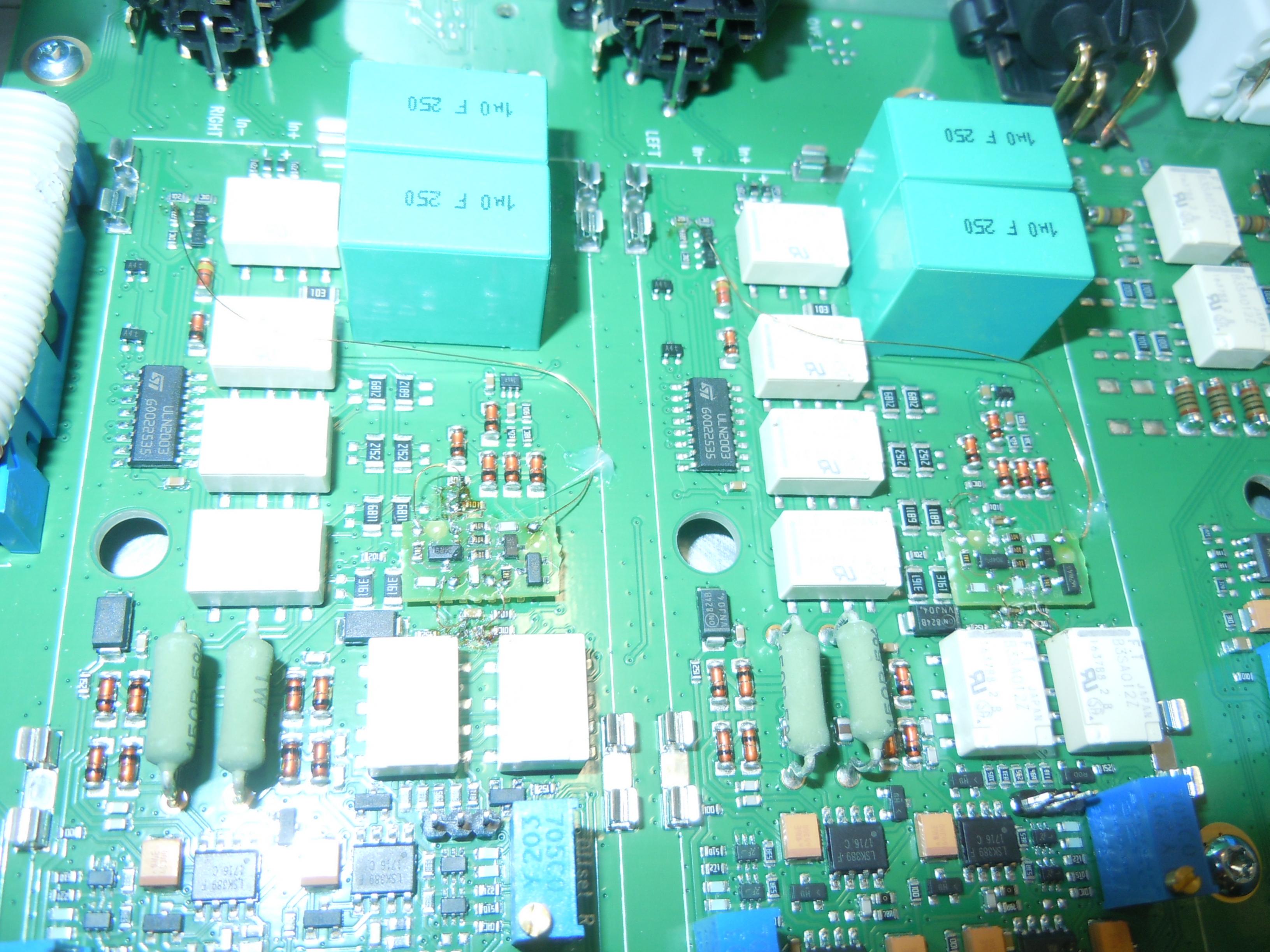

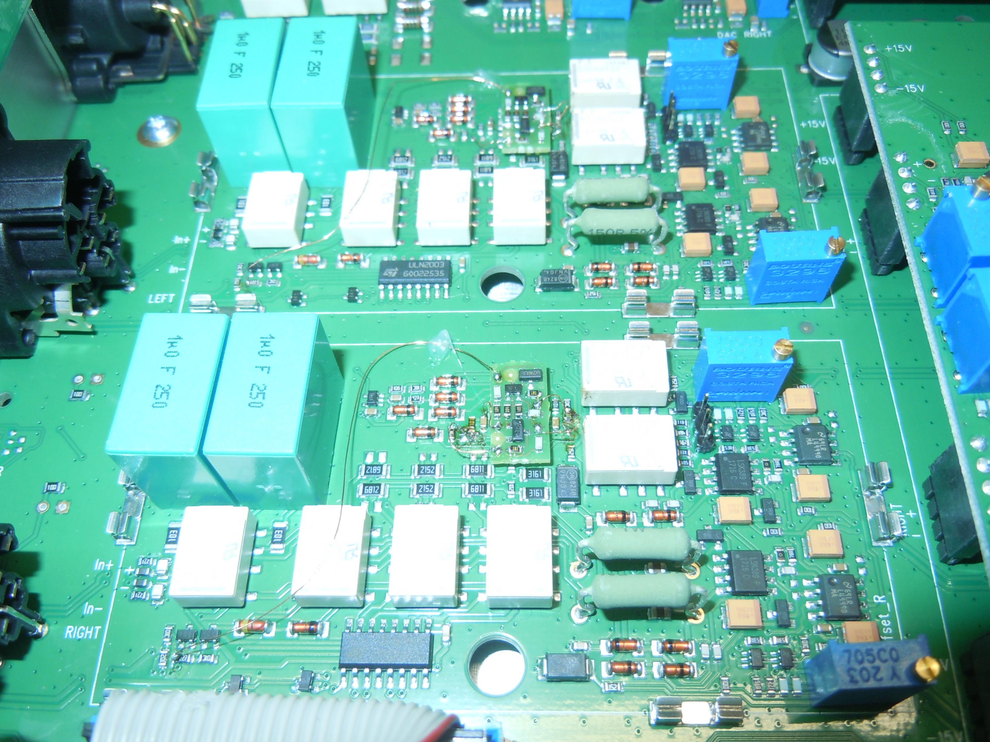

So, I installed the modification to the best of my abilities. It looks properly installed, but doesn't work properly. No smoke that I can see, but the peak light will come on in the -20dB position of the input attenuator. I was really hoping to avoid sending it back in due to the trouble and expense of getting it here in the first place. I had the most trouble with lead-free solder, so I switched to 63/37 normal solder. The hookup wire was next to invisible, so I resorted to soldering the tiny bright spot (wire end tinned) to the location and inspected the work with a magnifying glass. Everything looks okay, but it obviously isn't.
Are those resistors 603 size by chance? I can work with 805 and up, but those are just a bit too small. I did remove them okay, no dramatics there. I was using a small tip on the iron, which is why the lead-free solder was giving me a hard time.
The PCBs are attached to the chips (TL084) with a dab of silicone, and the same for the long wires. Tape tends to come off in time. A sharp blade will release the PCB and wires if the need arises.
One thing I had zero problem with where the instructions. Everything was very clear and well laid out. Someone did a good job on that. Now to find those goggles!
-Chris (blind old technician)
I will keep my eyes open for one of those. I really need it these days. If I can find them online, I'll buy a set right now.

Chris,
Have a look at Lee Valley. I got one of the above magnifiers from them. It's not optical grade for sure, but it does help. If you have one close by you can try before you buy 🙂 My only issue is that it's a bit awkward pulling it over my glasses.
Steve.

Hi Jens,
Okay, I found two leads had detached from the pads. I used hemostats to hold the wire and they crimped them. The wires broke right at the crimps. The others had fallen off before I got them soldered down.
I also found two bridged connections. Having tired eyes didn't help, but a fresh look today and some suspicion lead me to the problems. Removed all the solder and had a fresh go. So those were the final two issues.
Now I will clean off the flux (looks ugly in the pictures). Then test it again before buttoning it up again. I used the flux to keep the solder on the pads. Without it the solder was perfectly happy to string out across the board following the tip.
These pictures tell the entire gory tale as they are before shots.
Thanks Jens, the problem was where it had to be. You made me look earlier in the day while I was still almost sharp. 🙂
So this 6001 is all working properly both in loopback tests and your tests. I did notice that the protection seems to be insensitive to the negative polarities. Both channels are the same that way.
-Chris

The protection should work for both polarities. Otherwise there is something wrong.
The pictures area bit blurry, but please check the solder point (on the mod PCB) closest to the attenuator resistors (the 1206 resistors on the Main Board) and how it is connected to the Main Board.
