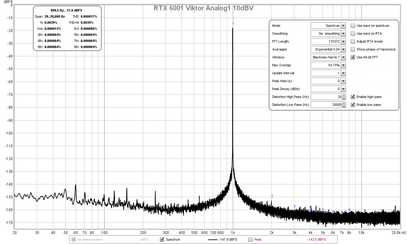

Its my role (yet again) to ask the dumb question: what software are you using here? Its screen shots makes it appear much more informative than either ARTA or Audio Tester...not that I am much versed in either.
REW
The software is called Room EQ Wizard (REW) and you can find it here.Its my role (yet again) to ask the dumb question: what software are you using here? Its screen shots makes it appear much more informative than either ARTA or Audio Tester...not that I am much versed in either.
I'm using it here exactly for the reason you mention: (almost) all settings are visible in the screen shots, making it useful for RTX6001 owners to compare experiences without having to ask to many questions🙂
At this point it seems more important to be able to compare our experiences on a single (free) software platform, rather than to discuss the benefits/defects of different softwares.
Just my 2c.

BTW, attached is a measurement of a single-ended Viktor 1k oscillator using the RTX. The Viktor is crippled with a 30V smps (battery based DC-DC converter) when it needs 35-36V, so it's not giving it's full performance but the limiting factor here is the ADC I believe. (When pairing with a Hall notch filter with 4x9V battery, my Viktor was verified to have an H2 of <-150dB before).
