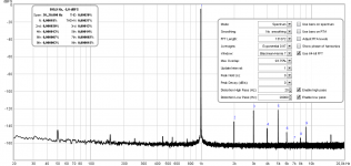

Actually, down to 0.00006% with output at -25, amp at 20dbv, and input at 1dbv.
Try 20dBV/10dBV @-15dBFS output, the THD can go further down (0.00003% in my case, -130dB)

I made a quick test with AudioTester V3, RTX at my default 0dB/0dB setting, got -122dB THD @-15dBFS.
At 20dBV/10dBV setting, reached -130dB THD (output @-10dBFS).

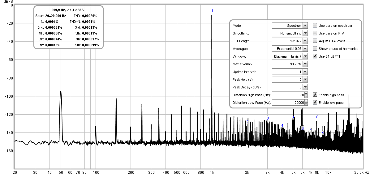

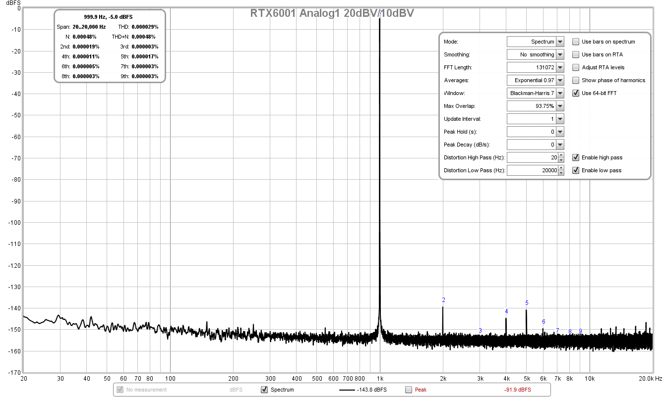

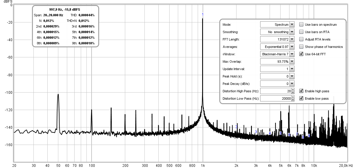

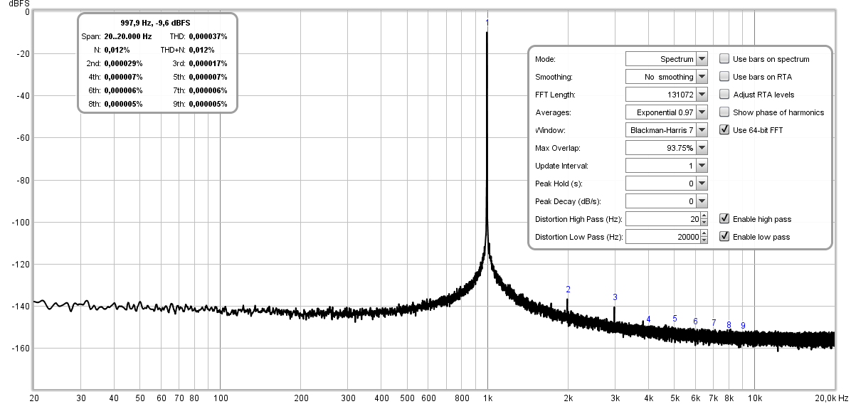

balanced vs. single ended
I did a few measurements to compare the use of balanced and single ended interconnections between the RTX and Victor generators, and the RTX detector. The measurements were taken first with balanced interconnects and then with single ended, without changing anything else.
The first two are using the RTX generator (i.e. loop-back) and the second two with the Victor.
Balanced is more pleasing to the eye, even if the actual THD and THD+N measures do not change dramatically.
Nevertheless, I seem to have quite a lot of common mode junk around here....
