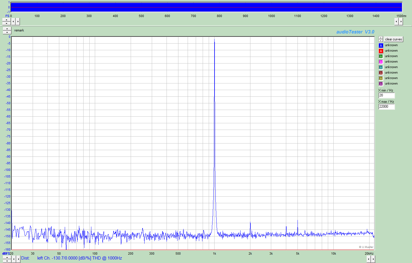

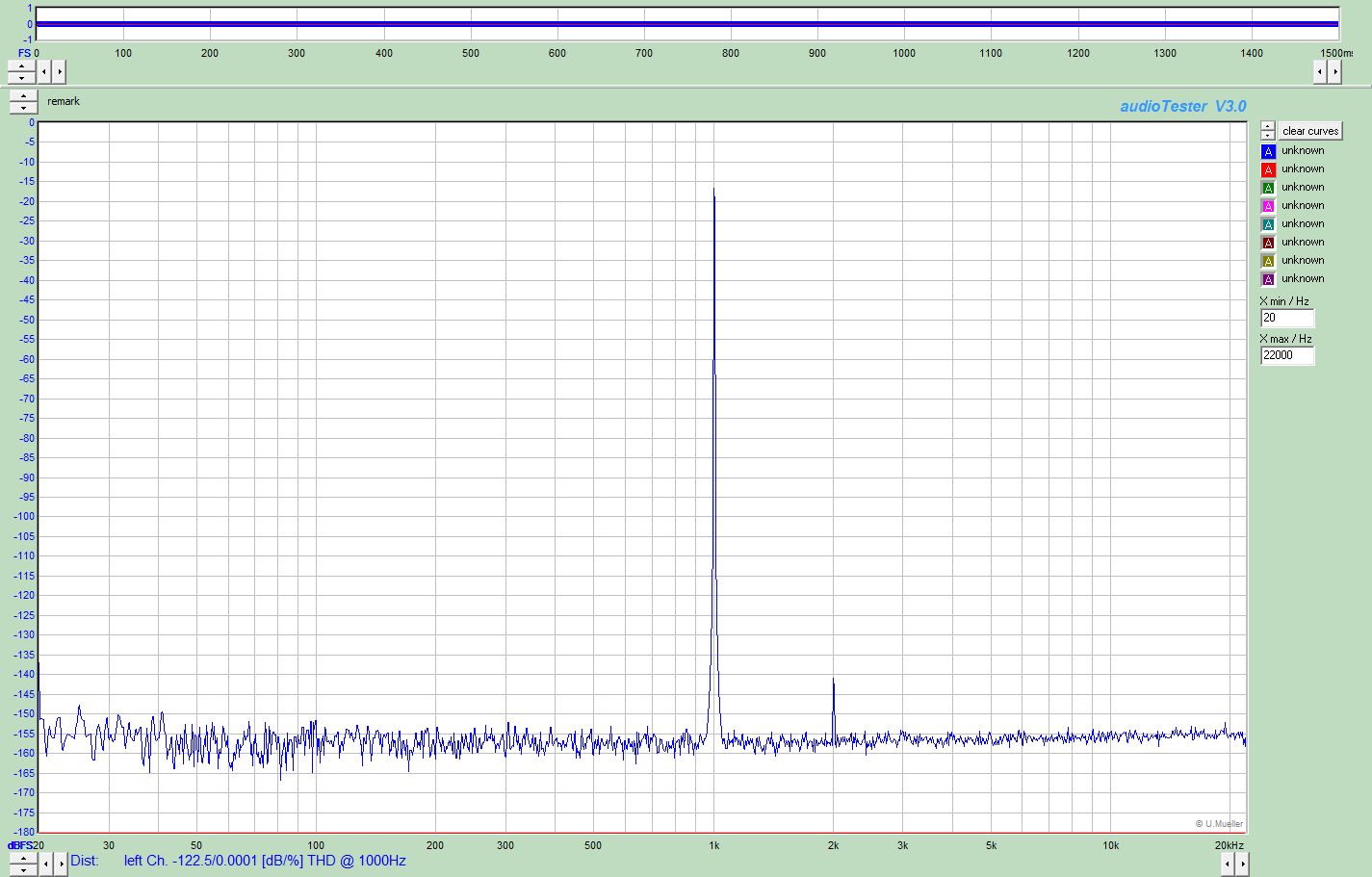

I made a quick test with AudioTester V3, RTX at my default 0dB/0dB setting, got -122dB THD @-15dBFS.
At 20dBV/10dBV setting, reached -130dB THD (output @-10dBFS).

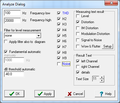

Can you post the settings clearly including Audio Tester Analyze menu values/Input setting/output setting on the audio
I have been struggling with some of the setups myself. I found each one of the setup values affect the Distortion S/N ratio values. Confusing for some one new to the FFT software.

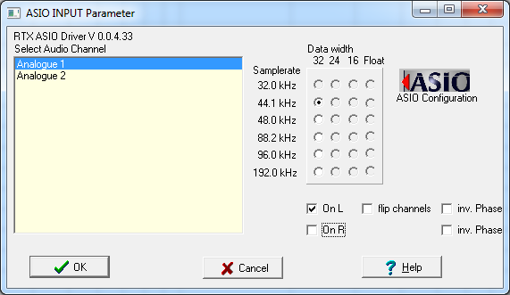

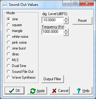

I have to admit that THD+N measurements from Audio Tester is very tricky, and I never manage to get it working consistently (not just with RTX, but with my other sound cards also), which is why I prefer ARTA or REW, even though I have paid a license for Audio Tester.
The THD measurement from Audio Tester is consistent with other software though. Attached are the settings I used for the measurement at post #613.
