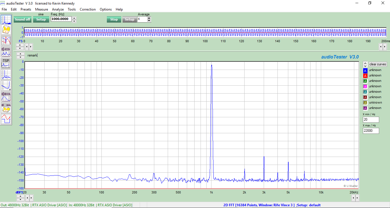

It's up and running, seems to work quite well. Performance in all areas is very good, and in some ways exemplary.

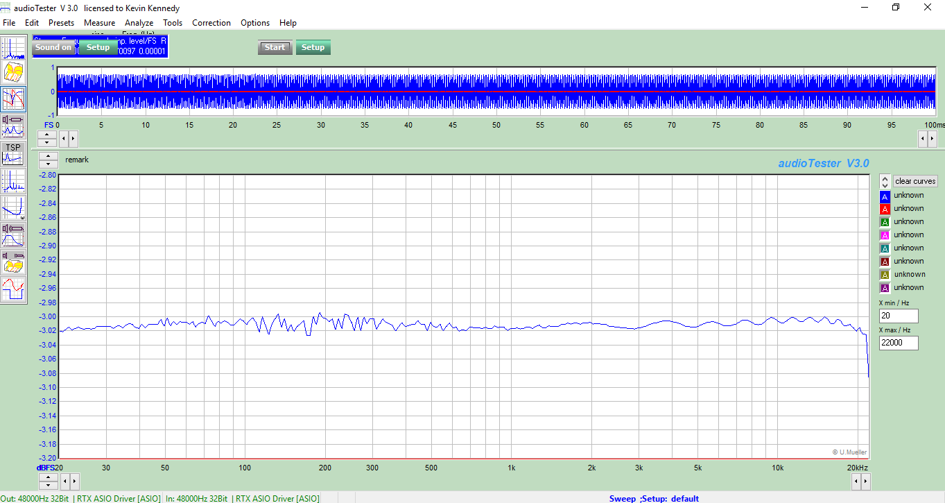

The frequency response is damned flat, about as good as I have ever seen. (Audio Precision territory)
Noise floor is low, residuals are probably close to the limits of the ADC.. Performance holds up well to the -3dBFS region (about -118dBFS at the third harmonic which is the worst case on mine)
The generator is exceptionally clean.
There is a little cross-talk between the right channel out and left channel in that is not affected by the attenuator, but in practice it is so far down I doubt it is a problem. (-87dB relative to the fundamental on the driven channel)
The calibration seems to be quite accurate according to my now out of calibration Keithley 2002 (it hasn't been recalibrated since the calibration expired in 2008) measured 1.00122Vrms out at the 0dBFS setting at 1kHz.
First graph is linearity at -3dBFS output and inputs set to 0dBV range. (Averaging 8)
Second graph is the frequency response at -3dBFS, 0dBV selected range on output and input, and DC coupling. (Wow, it's really good, like AP territory, 256 points)
Third is cross talk between right output and left input. (averaging 8)

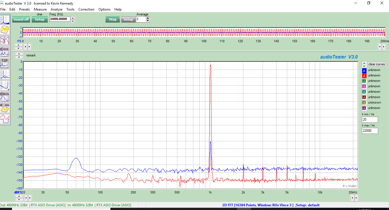

cross talk?

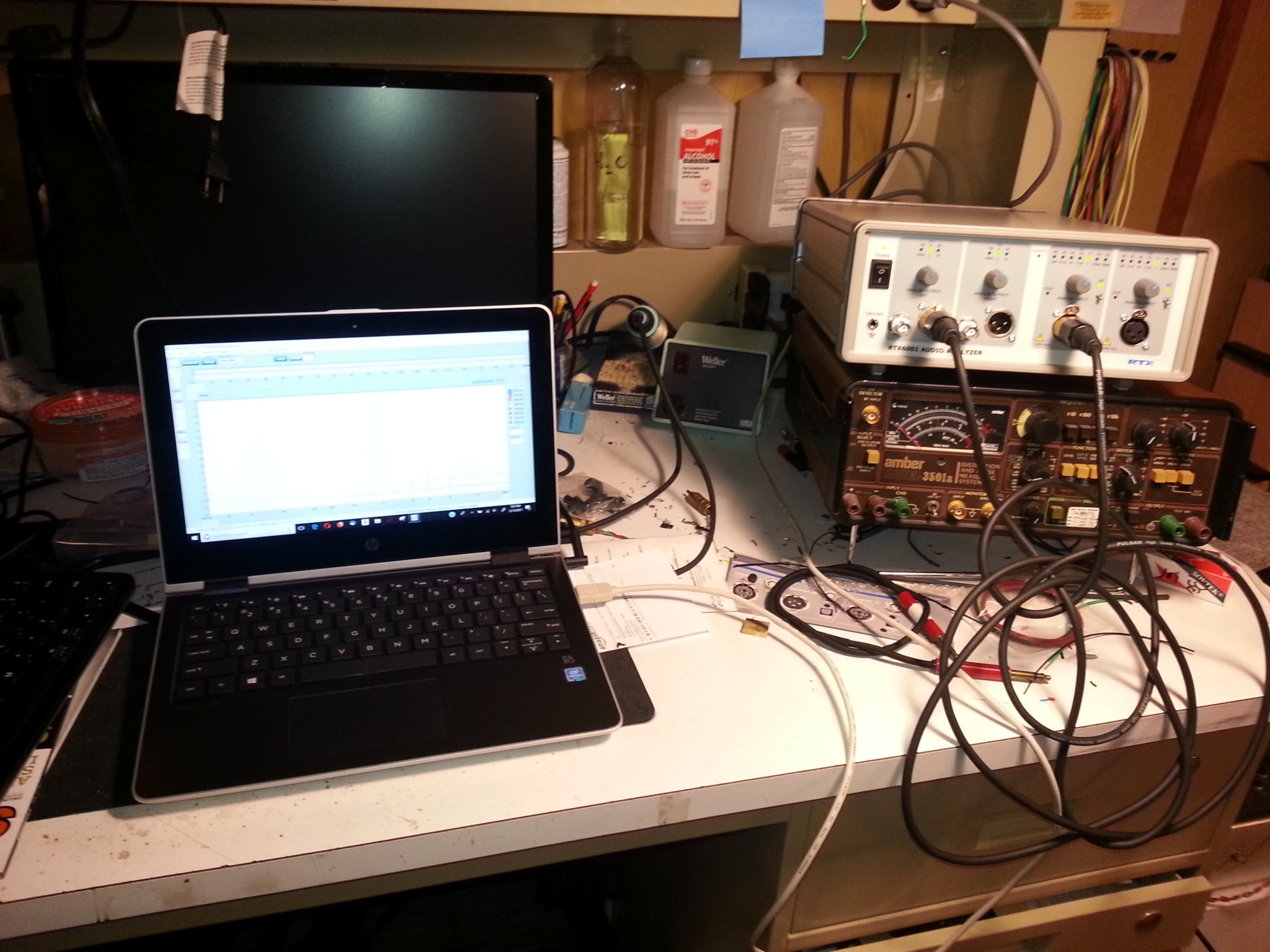

Early days so need to analyse further but an initial observation is that I'm seeing cross talk between the right out and left in. It is attenuator sensitive on the left in (and to some extent attenuator on right out) so suggests coupling is mainly before the input attenuator? Right in seems to be completely unaffected hence why I'm suspicious. Note that this is with nothing connected to the unit and the outputs left floating but that seems a reasonable test of the unit's stand alone performance. Saw one other comment that touched on this point. Any thoughts anyone?
Above was with unit connected to desk top. Have now set it up on lap top (running on battery) and the above phenomena isn't there. Weird and needs more investigation but strongly indicates the problem is on my side.

Thanks for your input. Turns out problem isn't there when I run it on my laptop so pretty conclusive that it's my desk top PC set up. desktop PC is getting old but is reasonable spec even for its age but must be under suspicion as the phenomena isn't being reported by others who are looking into the RTX's performance in considerable detail.
There is some amount of crosstalk between the right output and the left input, due to the proximity. The worst case is when the inputs are left floating, since the high impedance attenuator will pick up some signal from the generator section.
With a low impedance source connected to the input, the crosstalk will be reduced.
The Main Board has been prepared for mounting shields over the input sections, but I didn't feel that they were necessary, so no shields have been fitted.
