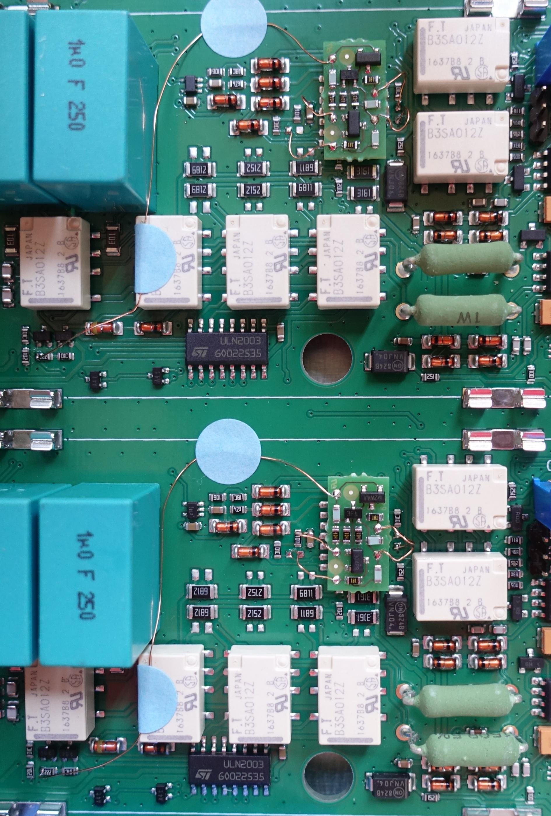

The first set of fix PCB that RTX sent me was loss in transit, but their support is great and they sent me a second set, which finally arrived yesterday. I'm impressed that they even prepare all the required wires with spares.
So I followed the instruction published by JensH and get the mod done today, it passed the test mentioned in post #686 and everything is working as expected. Now I'm tempted to try the transformer rotation mod of PaulBC.

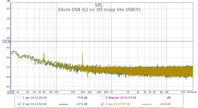

Sounds dumb, but I did not change the power line to the right voltage.[emoji849] Sounds amazingly neutral on first listening. Well damped. Using the recommended USB cable, there is totally no trace of sonic signature associated with longer USB cables I have tried with other devices.
Switching to my usual USB cable, the lower frequencies and the dynamics seemed be have a more weight into the music.
So I would be interested to see if measurements will show differences.
So are you saying that you connected it to a 110 V line voltage, but with the unit set to 230 V?
I have actually not tried it. I could imagine that it will work to some extent, but you may get an increased hum level.
Doing it the other way around will probably blow a fuse or two.
I wouldn't expect the length and type of cable to make any difference at all, as long as data transmission is error free.
