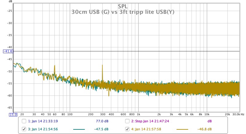

The little peak at 60Hz is the difference, I cannot understand where the larger peak at 300Hz is coming from, but I will play around and find out. Noise level seem to be based on one scaling in REW which is at 87db I think. I am still trying to figure out what the scaling changed when I saved the RTA curve.

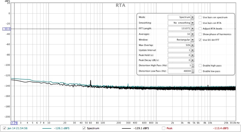

Not repeatable today. The 60Hz harmonic is there on both cables. FFT length is 131072. Smaller FFT length seems to raise the noise floor, is this expected? Rectangular window seems to lower the noise floor a bit. IMG_4971.JPG
The sound is amazingly clean and precise just using the unbalanced output. I wonder how it will work using fully balanced interface. The Tripp Lite cable seemed to give a lower noise level when running loop back harmonics tests in REW, so I decided to stick with this cable for now.
Not repeatable today. The 60Hz harmonic is there on both cables. FFT length is 131072. Smaller FFT length seems to raise the noise floor, is this expected?View attachment 656975
Yes, I'd expect everything to be like this.
The USB interface is galvanically isolated at the RTX, so it can't form a ground loop picking up hum.
Shorter FFT means wider frequency bins per FFT point, so each bin captures more noise.
