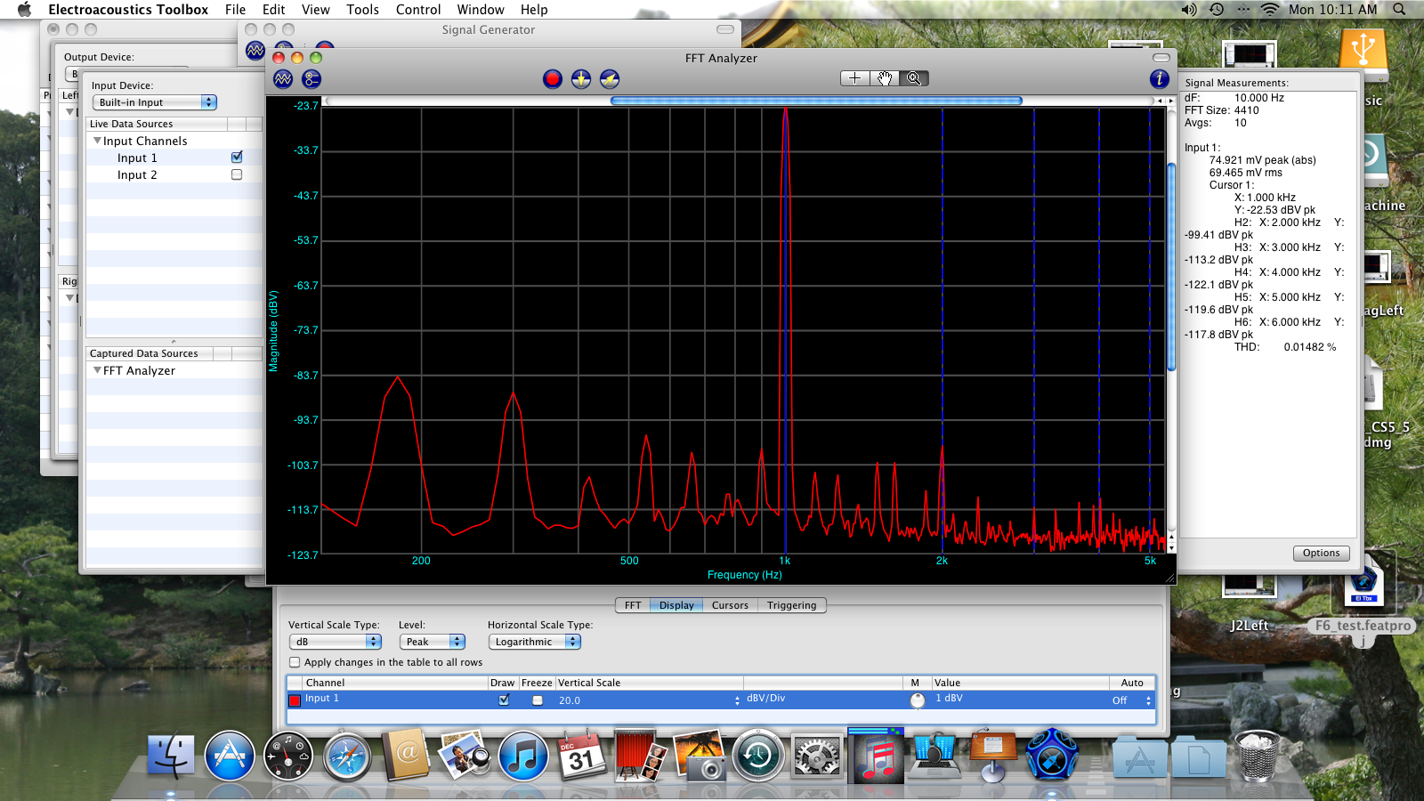

Generg has been very patient with me, showing me the ropes of FFT scope software and setup. This may not be perfect, but here we show an example of F6 with a Cinemag transformer. It shows a smaller db level of THD for H2, or second harmonic. So this means more second harmonic distortion.
This is a 1K signal generated to provide 1W @ 2.83V across 8R output loading resistor. So this is what my firstwatt for F6 looks like.
The other transformers and channels are pretty similar. You can see some amount of 60Hz harmonic as well (hum), although I can't hear with my head to a 98db speaker. I will post more later.
