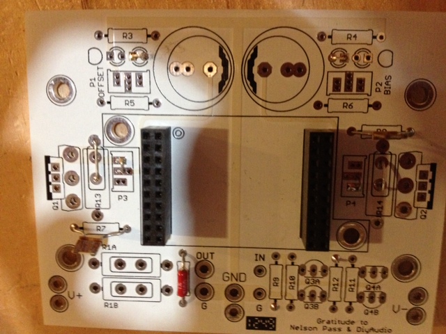

I have built some boards that are almost complete that represent the "Unbuffered F6".
The main goal here is to start really evaluating listening of the transformers, without the ability to tweak anything else. I hope to have the whole thing wired into a listenable fashion in a few days. It's a busy time of year as we all know!

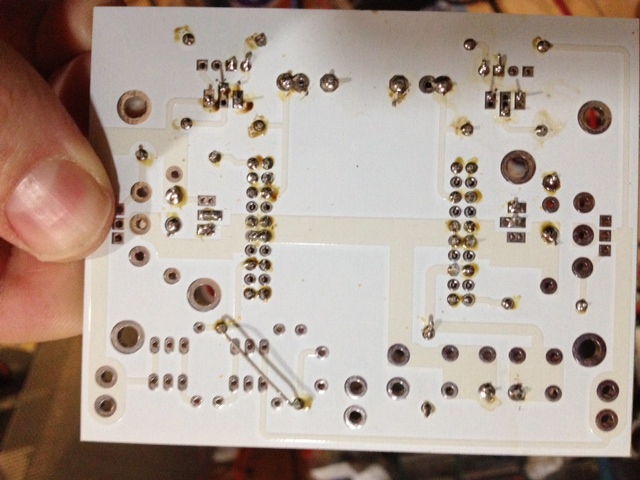

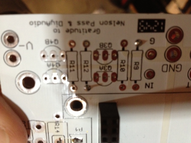

Here is some pictures showing my implementation of the Unbuffered F6.
This shows all available jumpers, except now the Toshiba JFETs 2SK and 2SJ no longer need the source resistor spot jumpered.
To be specific, pots are jumpered to the middle pin towards the source resistor, the source resistor itself is jumpered, one led is jumpered, and the input is jumpered all the way to the input of the transformer, which is on the remote end of R11,12.

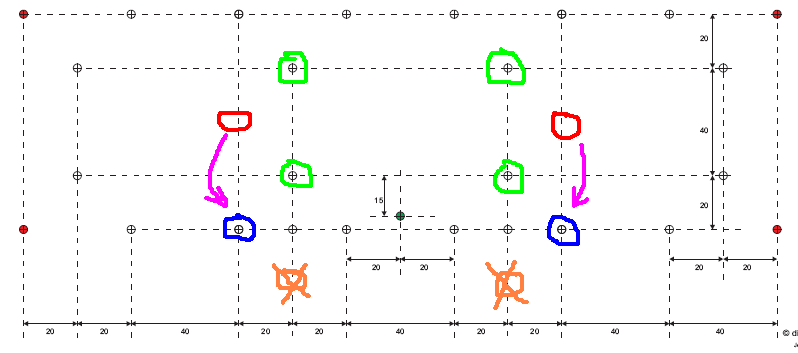

Here is the proposed mouting for Universal Specification if you have one of the store chassis.
The FETs would go into red or blue postitions. If its in the blue , you can mount one set of standoffs in the green area direct to chassis.
Since the mounting on the blue taps will leave the board very close to the bottom of the chassis - I cannot guarantee that it fit there. We just made it under the limits of the proposed area.
If anyone already has these chassis, let me know - I can send you physical print out to measure against the actual chassis.

I have the 4U "Deluxe" chassis on hand (the pre-drilled version), for my in progress F5 build. I'd be happy to check things out if you'd like.
If its like F5T boards, it will fit fine. Still advise mounting fets to ink before soldering to board. This makes certain that coupling to sink is optimal.
Do you have a fax machine? Else I am going to see about PDF conversion.
Yes, PM sent.
So some good news.
6Speed has helped me with the layout in an actual diyAudioStore chassis.
We shaved a few mm off the bottom to get it to clear without issue. I may see if we can do a little more, so the board so will have a little more clearance.
