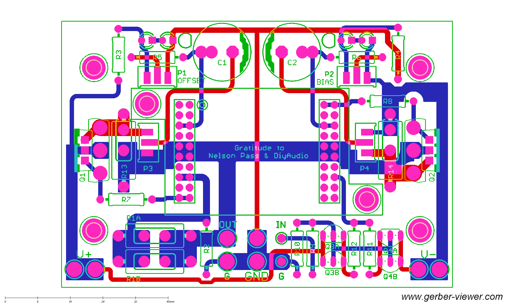

The boards will be a bit smaller than some of the prototype pictures to work better with the diyaudiostore amp chassis (at least the big one). 6 speed has been doing scaled model printouts cutout and fit to the chassis.
Did some more listening to the F6. - The Figure 13 - buffered setup, without any zen pots, or any degeneration. Trying to keep it simple for now. Give me too many variables to control - and I go mad science and cannot be sure of anything.
Funny how it sounds so controlled and meaty when hooked up to my Fostex FF125WK - these are now my test bench speakers. They sounds really good with this amp, but only when I really crank it up. Excellent soundstage. I really dont like these fostex for a small speaker in bass reflex box. I like the CHR-70's the best in my collection of small full rangers.
Hooked up to lowthers in main system - now this is what I remember hearing from the real J2 I heard - a bit liquid and smooth.
Even my wife says it's a tamer amplifier than others. But I don't find it too laid back.
I am trying to get distortion spectra on the amp with some help from Generg.
