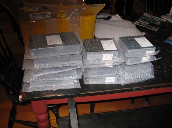

Shipping Status
Here are the boards....
I shipped out about 34 packages this morning. Hope to have the rest out by this Wednesday.
