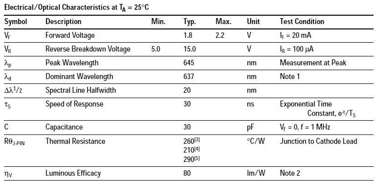

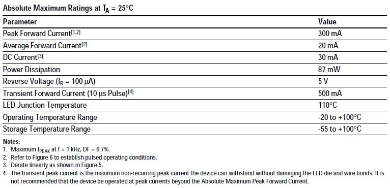

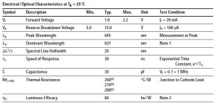

Plain 3mm 1.8Vf leds are perfectly OK.
Worked fine for me! $.02 each
For the LED's if 7mA is a little on the max of what we need, maybe the other suggestion i did earlier are a better choice from Mouser; 593-VAOL-3HCE4 has a typical Vf of 1.8v at 20mA.
Then we will have a better margin at the mA.
or just plain LED's from around the corner
