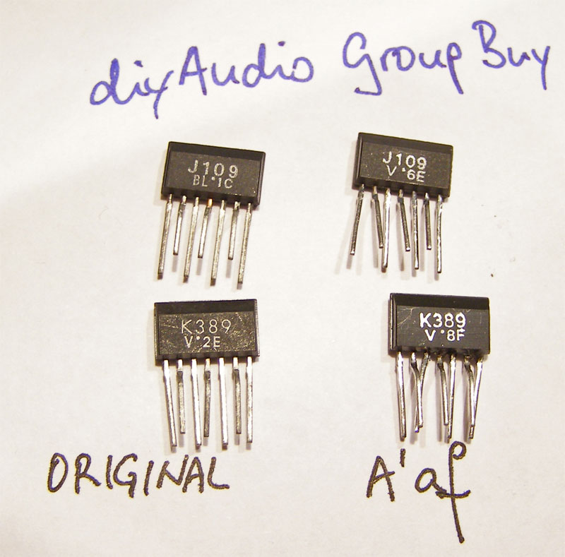

So I finally got my “FETs”. The package reads “no commercial value”, which is just about the most accurate way to describe its content I can think of.
Anyway, my measurements confirm others’ suspicions that these are most likely bipolar NPN transistors. The characteristics and pin-outs of these NPN transistors are consistent with 2SC3381.
The picture below shows the appearance of original FETs from my private stash and those I got from A’af earlier today. They may appear similar to a disinterested observer but there are telltale signs of foul play that have been already noted by others, namely: cropped leads of different length coated with solder, wrong font style and smudged and misaligned print. I also find it interesting that all parts have the same batch code (8F for K389 and 6E for J109), which is not entirely impossible but rare in such large purchases of identical items.
Since these are not fake FETs in the narrow sense but electrically completely different parts, I agree with Gerd (GKU) that these are most likely some handmade garage-shop devices made with the intention to sell as original product. They may have been even custom-made for this specific group buy (which could also explain why we had to choose between BL and V grades).
I expect a full refund from A’af a.s.a.p. on the basis of his personal guarantee, regardless of the outcome of his negotiations with the supplier:
