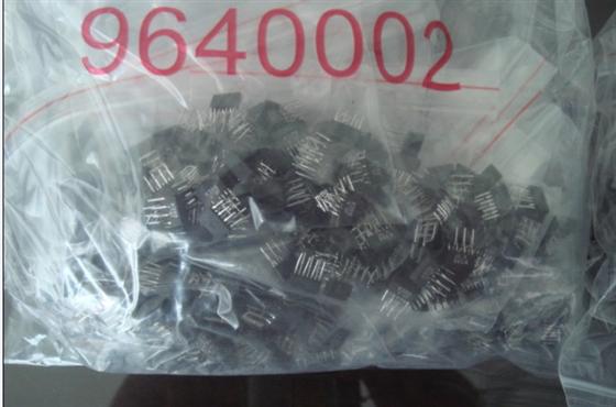

I didn't get in on this GB, but looking at the bagged pics in post 262, the devices in the bags appear to look better in terms of the leads, etc. than the devices received and pictured in later portions of this thread. It might just be my eyes though. Not accusing anyone of anything, just an observation when I went back thru the thread.
Of course what they look like and what they perform like are two different things...

The devices in the pic are sure not the same as whar people have received, just look at the legs.

The legs on this one looks like the ones I got..
I mean the front legs are more forward than the original 2SK389 that I have.

I did ask myself wether this bag of devices could be different from the parts that have been actually shipped out and of course I did look at the legs first but came to the conclusion that the picture is not detailed enough to judge this.
