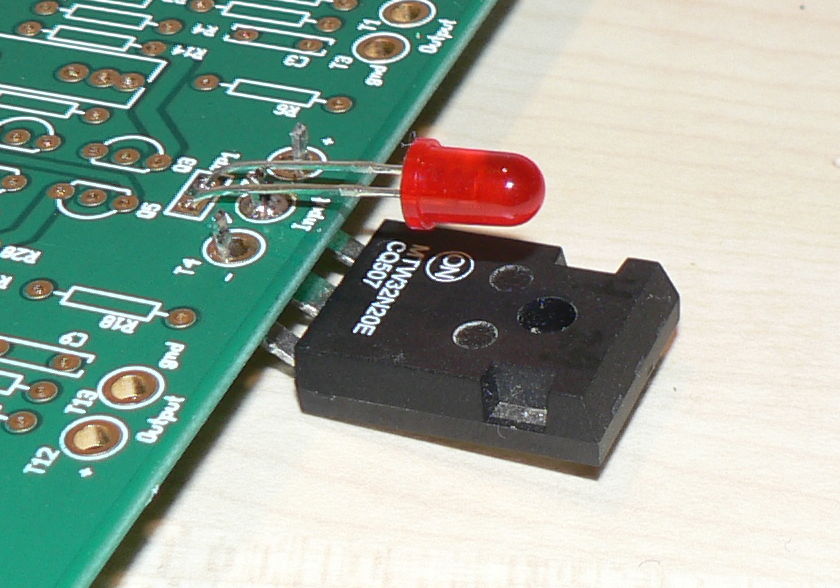

hi cviller,
i virtually stuffed the boards, but was not able to fix the termistors right next to the middlepin of the output transistors. Do you suggest to fix both from the downside?
nice work, thanx
stefan
Thanks for doing a test stuffing!
I'm not completely sure what the problem is. Are the thermistor legs touching the mosfet legs? Or is it only a problem of getting the alignment spot on?
pblossom said:
cviller:
I noticed that you had <Aaron Blossom> as paid. Please note that <Aaron Blossom> and pblossom (as on the Wiki) are one and the same.
I mark paypal names in <> if I'm unsure about the diyname. Now I know! 😉
I´m sure it will also fit this way. But with the termisor "behind" the transistor it is more suitable for "right angle" mounting to the aluminium block. FOr mounting the board parallel with the transie stuffed from the bottom of the board, the termistor has to "cross" the transistor legs somehow. But no sweat. Maybe i´m on the wrong way there and "just "near-to-the-transistor-mounting is perfect.
s.
I thought about doing it like attached, but you might want to insulate the legs of the thermistor...
Btw, the board is wrong, the transistor is wrong and the diode is not a thermistor... 😀

labjr said:
Didn't Nelson suggest gluing the thermistor to the MOSFET?
I haven't read the whole thread. He might have suggested that - i doubt ringing is a problem in this regulation... 😀

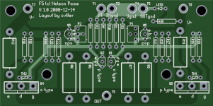

I have uploaded a new layout - I still plan on ordering tonight, unless someone points out a blocking issue with my layout.
labjr said:
No rush. I'd rather have it done right than have to redo it because something got overlooked.
Good point.
My flow from schematics to pcb have over the years proven to be very stable, in fact I have not tried to have an error in pcb which was not already in schematics. If anyone has the time to double check my schematics against the original I would appreciate it.
