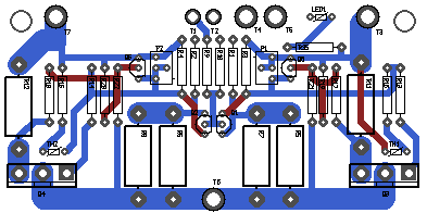

cviller said:I have just discovered that Peter Daniel has chosen to also make F5 boards. His boards are much smaller than mine, which some people prefer.
heat dissipation is better (IMHO).

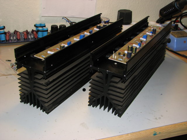

It is not a particularly good idea to prefer small boards, with the powerfets crammed together, for Class A amps. It is difficult enough to get rid of the heat allready. Ideally the heat should be spread as much as possible on the heatsink. Usually Passlabs use more or less the whole length of the heatsink for that purpose. But you will realise that on a summers evening when the party has been going for a few hours
BTW regarding the PSU-board, it would be convenient if the input and output are layed out for 5mm pcb screwterminals. Not sure if they are, but it doesnt really look like it.

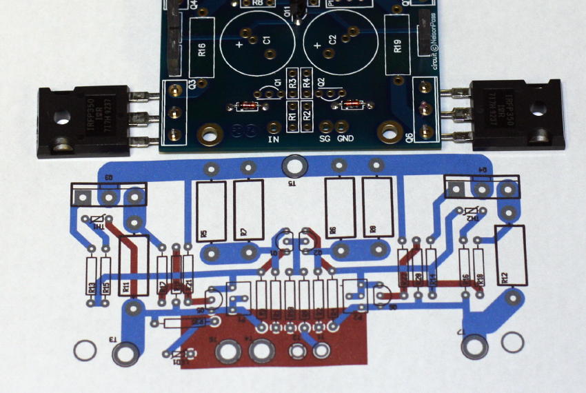

cviller said:...and heat dissipation is better (IMHO).
If you mean that it's better with my boards, than you would be correct 😉
BTW, Q5/Q6, are they oriented correctly in your layout?
NIcely spotted! 😉

Thanks for claryfing, as that would be an obvious omission and I had a feeling something else must be at play. Good luck with a group buy, nicely done layout. The single sided one was also nice, with more purity if you ask me 😉
Normally, I wouldn't start the other group buy, the main reason was continuation of previous series of small footprint boards: A30, F3, F4 and now this.
I hear, some people just collect them😉
Payment sent for 4 x F5 amp boards ( two stereo sets) and 2 x PSU boards.
Thanks alot for doing this!
Interesting point about the layouts single vs double - you are right the double layered is not as pretty, but I think it is mainly due to the big lump of gnd copper I placed over the inputs. If that is removed it looks a little nicer. 😀

Here is a practical example of a perfect layout for eg the F4 (cvillers actually)
Oh and Peter, do try to keep them powerfet legs as short as possible😀

steenoe said:Oh and Peter, do try to keep them powerfet legs as short as possible😀
That was for demonstration purpose only, I normally do😀
Cool sinks steen! How will you mount them to get enough air flow?

cviller said:Cool sinks steen! How will you mount them to get enough air flow?
Signing of for tonight.![]()
The F4 ended up in this one. I will cut the black horisontal sinks on the other pic in half, and mount them vertically. I have 5 or 6 pcs so they will make a nice little amp case for a F5😉
