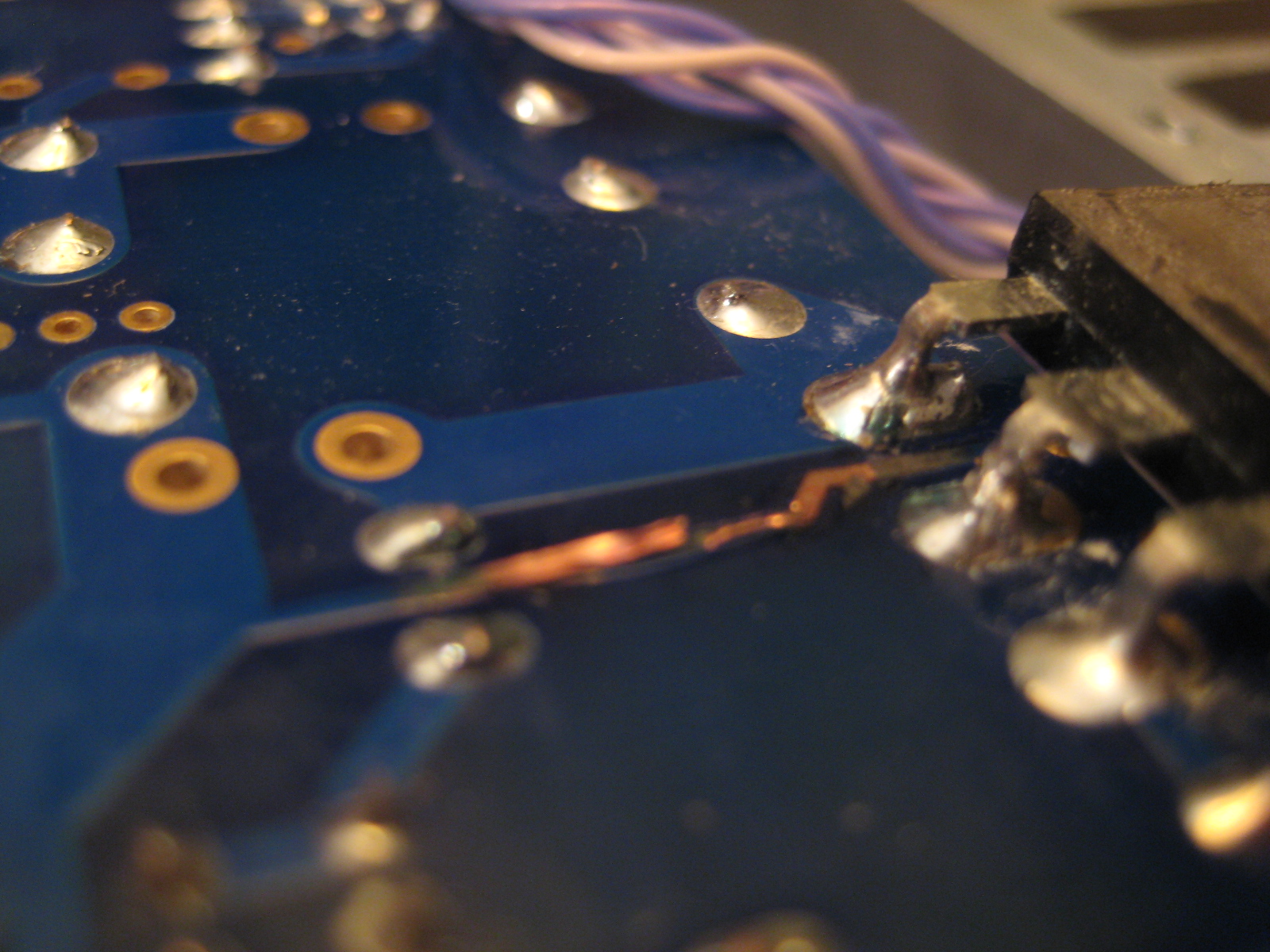

:crying: Question: would this happen if one of the thermistor legs were to have shorted out on the middle leg of the main transistor? (it was close and it made an arcing sound)
I can repair it, but i don't want it to happen again

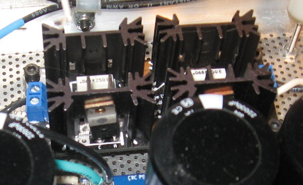

Tea-Bag,

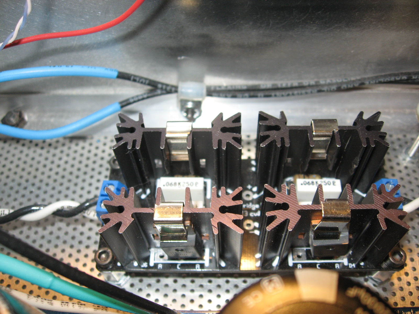

You'll find that those boards make for a Dead quiet power supply! Use the snubber option and Ultra fast diodes you'll virtually eliminate any "ringing".
Make sure to use some type of mounting device (bolt or clip) to secure the diode to the Heat sink or you'll hear about it from Christian!!!😛
