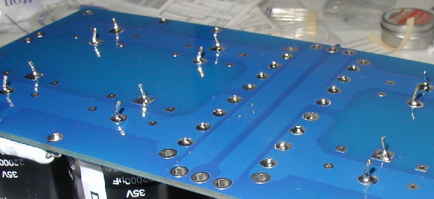

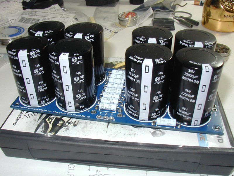

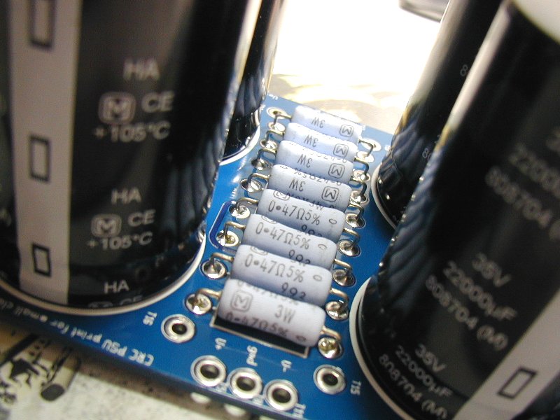

I just cannot resist, here is some (excuse the term) solder porn. 😀
