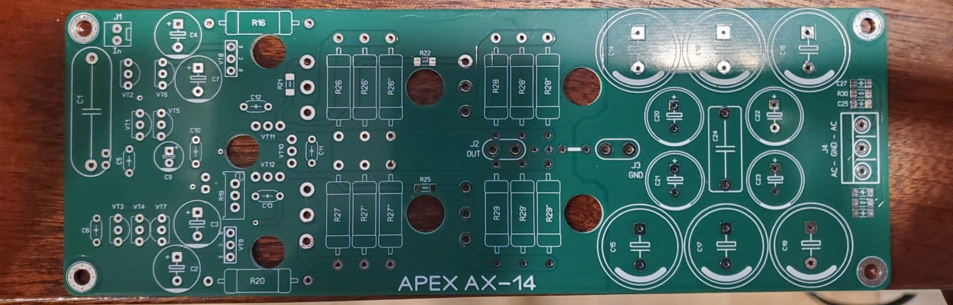

I prefer all my amps have DC rail fuses but clips were not added to this particular board which also contains rectifier and caps.
It would be messy to try to modify and add DC rail fuses - I'll try for low amperage(that is possible) fuses on secondary windings.
Yes, I have soft start and DC protect on my amps, thanks!

I would fuse just the 50Hz/60Hz AC power transformer primary with an adequately rated fuse rather than fuse the DC rails for safety purposes. Here's why: Take, say, a standard 3AG sized glass fuse. If it gets overloaded with AC, the element inside melts, and the plasma that forms inside the fuse and its holder extinguishes on the next zero crossing of the AC power. With DC, the current never goes to zero, and the plasma can keep burning, causing overheating and possibly a fire. That's why fusing the AC side is safer. Of course, if the DC voltage is low and power is low, then a fuse in the DC rail could work. In a high powered application, though, no.
Fuses have voltage ratings, and they are different for AC and DC. Ceramic- or sand-filled fuses are needed for higher voltages and currents. Some fuse datasheets even have graphs of current-breaking ability against voltage. The common 20mm glass cartridge fuse isn't always appropriate, but usually it is OK, and ceramic versions are available - for instance the datasheet for Littelfuse 487 series (ceramic 20x5mm) gives a max breaking current of 300A at 420Vdc.
