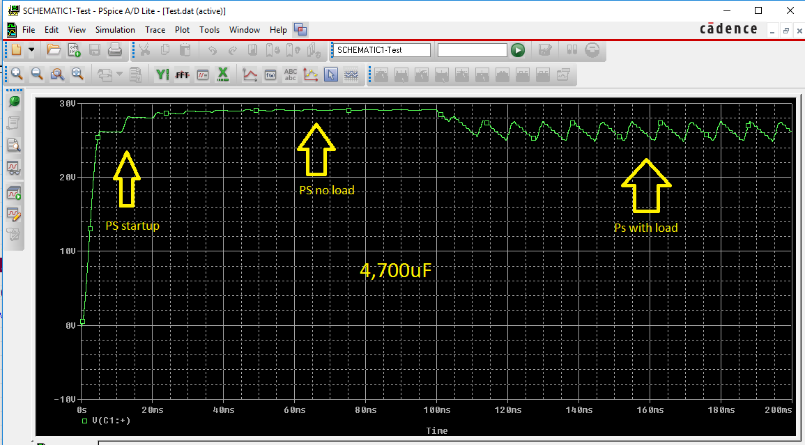

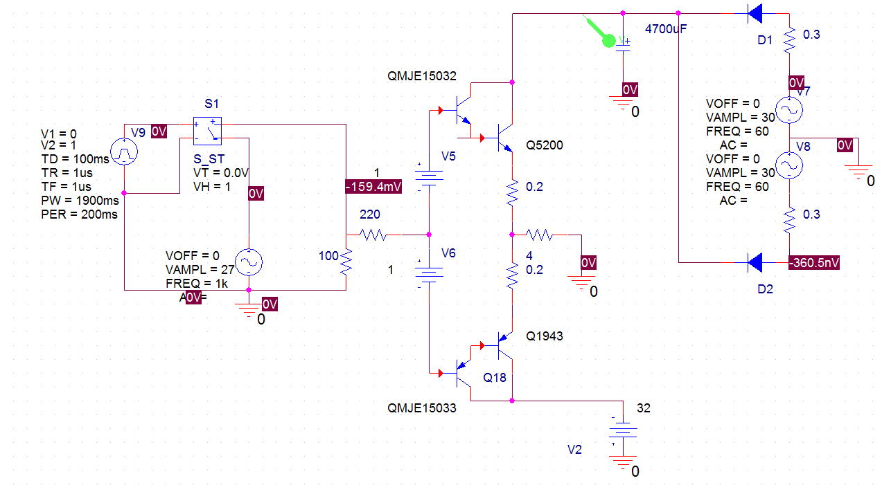

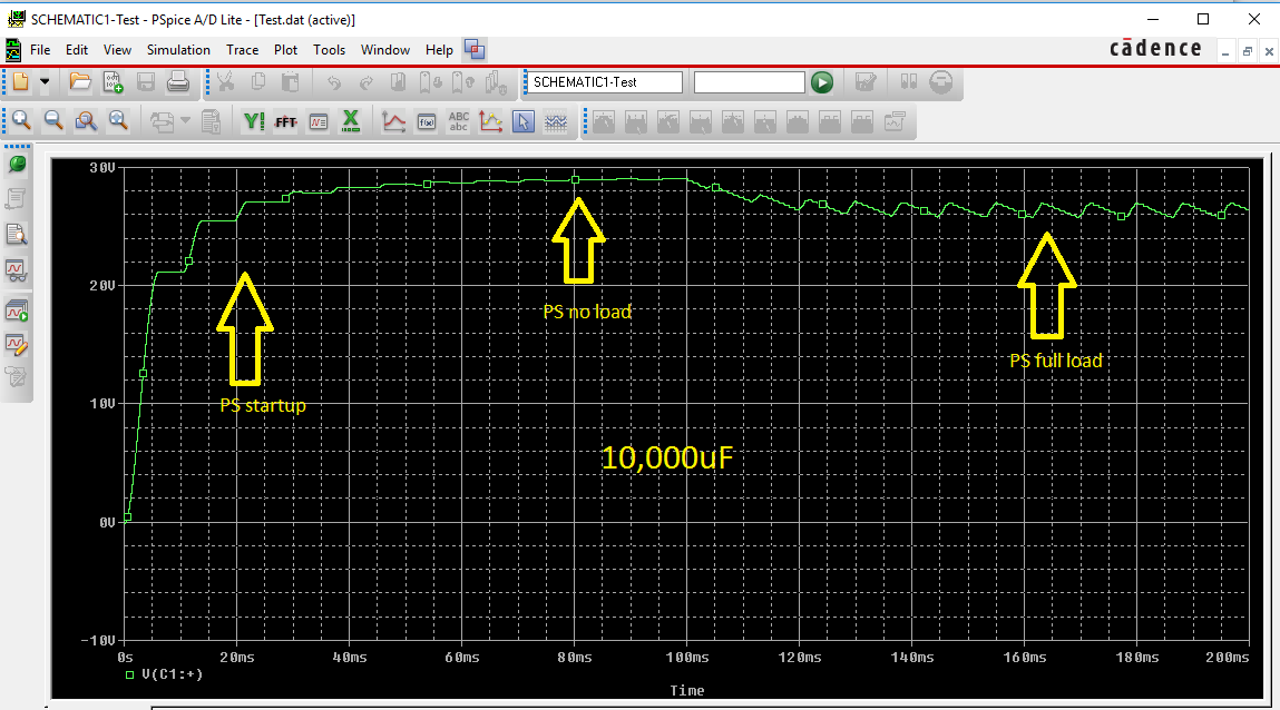

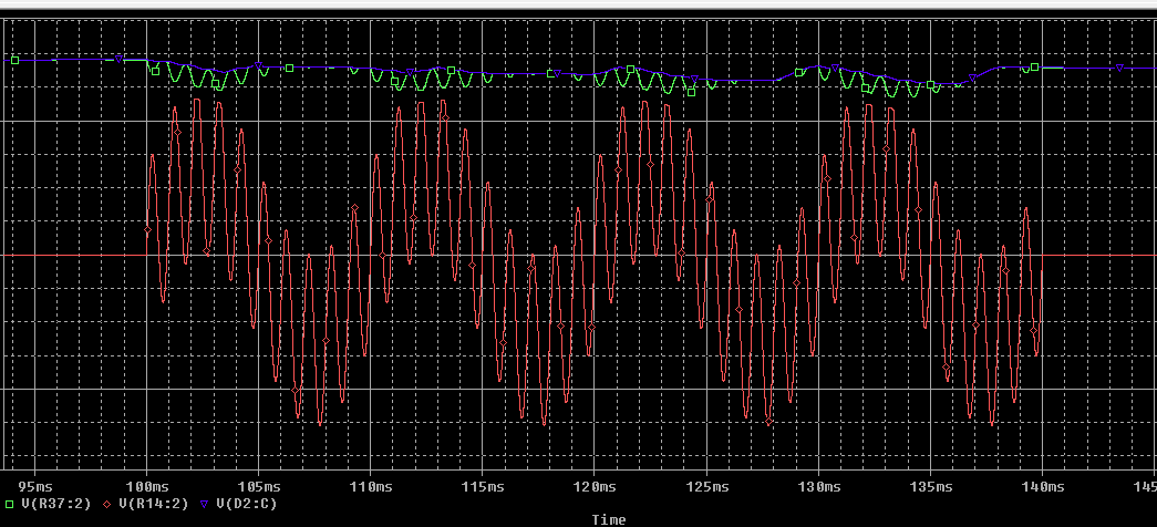

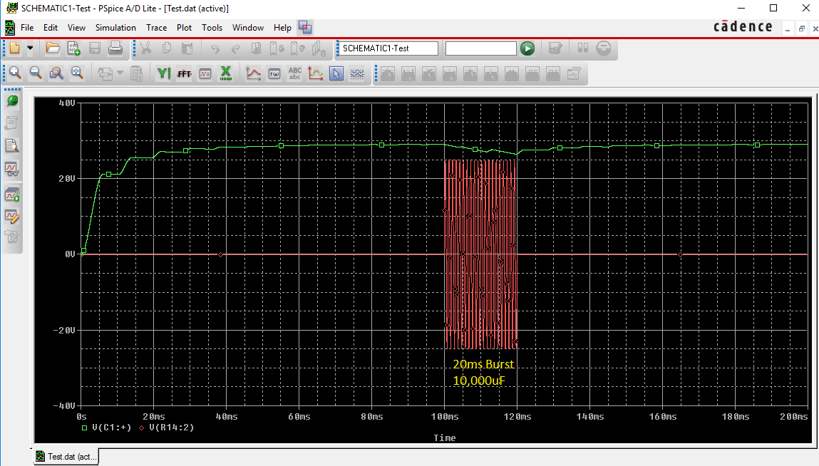

Just to illustrate 2 scenarios with 4,700uF and 10,000uF with 4ohm load (speaker impedance matters) and transformer with 0.3ohm coil resistance (I just simulate the positve rail).
You get around 1V more usable from the power supply with 10,000uF. Going beyond 10,000uF will not make much difference regarding ripple.
This is for continuous operation. I'll simulate the burst.

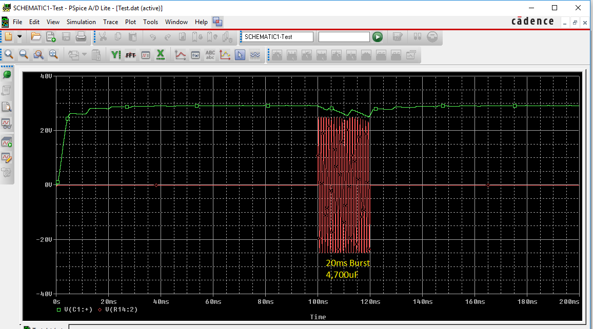

In this example, with 20ms burst, 4,700uF output sine wave peak clips, but with 10,000uF it is still ok.
4,700uF can hold up to 10ms burst.
In RED the output sine wave and in green the positive PS rail.
In real music, we need longer bursts (>100ms) so, I don't think it's worth to add much more than 4,700uF or 10,000uF for 4ohm per channel to get this extra dynamic power - I'd satistfy myself with continuous power and with 1 to 2V peak to peak ripple as we get with these capacitances.

Sure, okay. Now what is the difference in power, and at what power level?
Like I said, in real music if you are that close, you are probably clipping. Given the speaker distortion, momentary clipping is probably not noticable if the amplifier is designed well. Much concern over something that doesn't matter in a practical sense. If you run that close, you need a larger amplifier.
Very little and with very short burst. Not worth - I agree with you.
This was just to illustrate what I wrote before.
As I shown, you get only 1V more going from 4,700uF (83W) to 10,000uF (89W),
83 to 89W = 0.6dB.

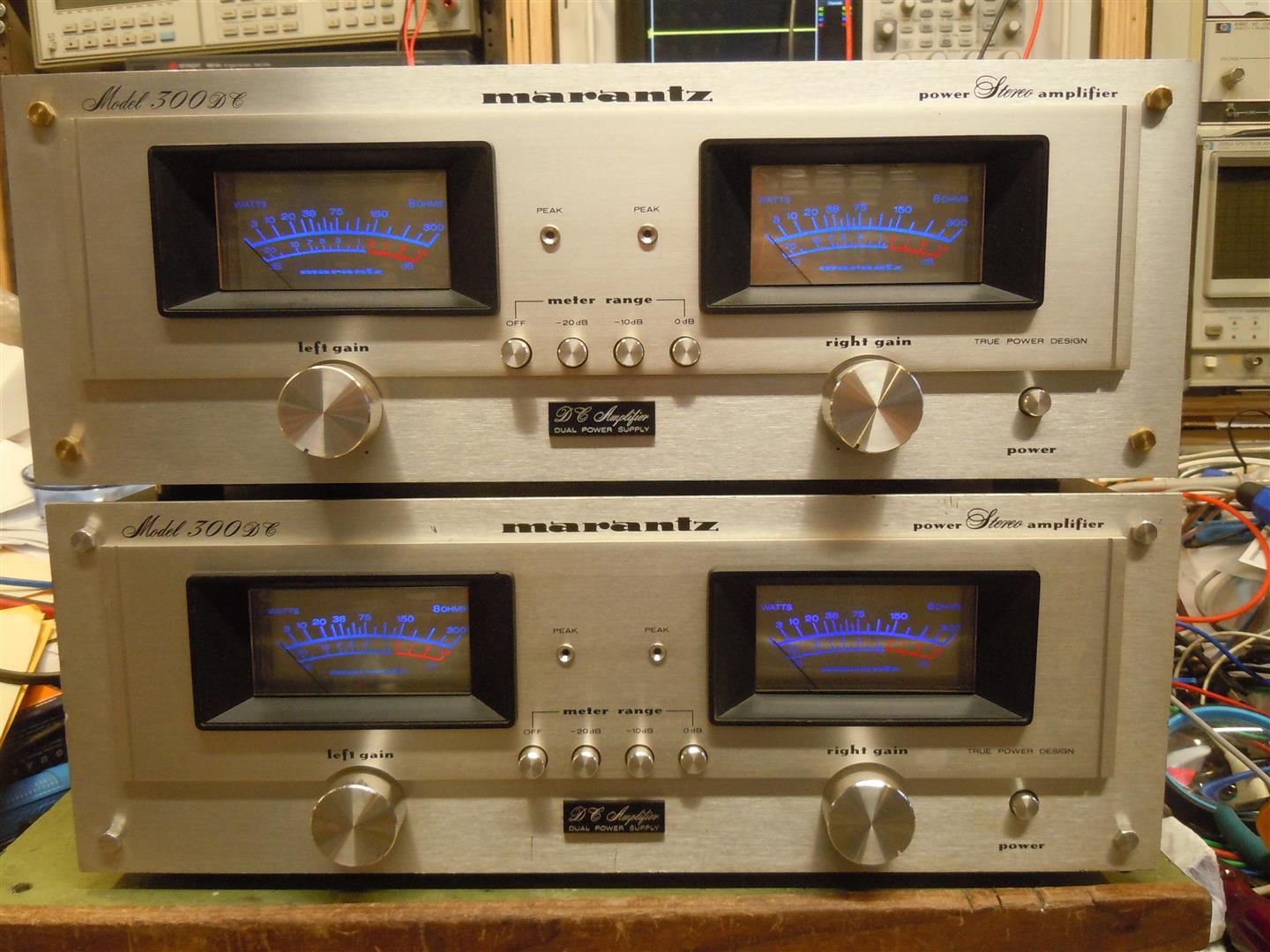

Is this one you have?
There is a guy selling used here by US$3,500,00 with the pre-amp.
A lot of money!
A lot of money!
Hi Ron,
Yes, but that one is hideous! Notice how the red scale in the meter isn't illuminated at all? It hurts to look at it, I used to sell them way back. That's a 3250B preamp on top, I have a 3650 and an SC-9 preamp.
From the looks of it, it has been very poorly serviced. I wouldn't buy it!

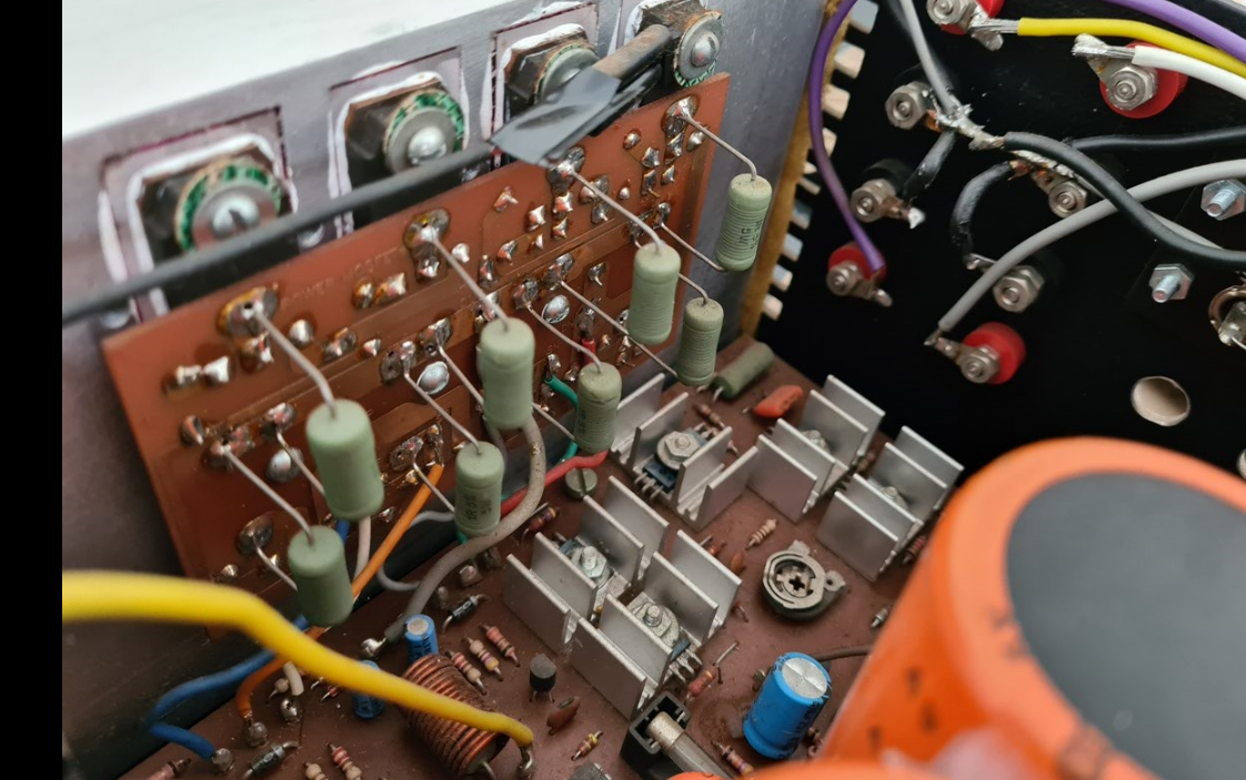

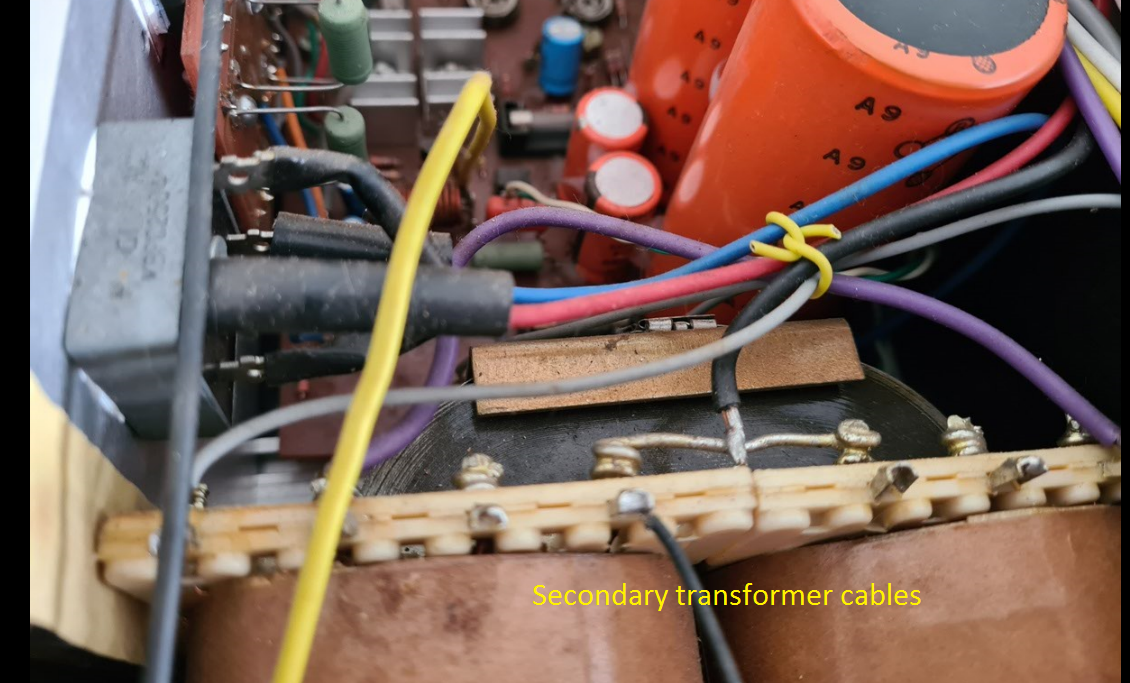

I made some changes that lower noise and remove the "edgy" sound. The solid brass bolts on the front are used when I modify one if the client wishes.
These are two of mine. I should take a picture that better shows how they look. The bright bench lights wash the picture out.

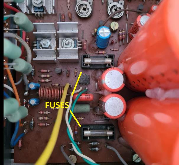

Hi. Fuses are good thing for safety of your amplifier, but a few things needs some attention. So , fuses on each rail, after main capacitors, in a way of plus and minus to each channel to amplifier boards, lets say so. What happens,if output transistors fail shorted, and just one fuse blows? Negative rail will appear on positive and so , damaging amplifier more. So a diodes to ground must be used to blow second fuse too. Anode to gnd fot positive rail, cathode to gnd for negative rail.
Another thing , which i dislike even more, is resistance of fuses. Recently had to make a kinda of power bank of 50pcs li-on cells ,entire bank measured less than 1mR in total. Put them in box and added a automotive fuse , mounted with screes, 40ampere , and that fuse and some massive wires added 8 milliohms to powe bank resistance! Btw , wires were 10mm2 . So value about 100milliohms for smaller fuses like 4 or 6A looks rvery ealistic, and may cause some problems too, if fuse is in-between two capacitors ( amplifier boards needs to have it's own local decoupling capacitors too! ) . So it's a bit risky to have fuses on each rail. Placing fuses in secondary winding patch is even more problematic, fuses either must be slow , or high ampere rating, because of massive current drawn , during turn on.

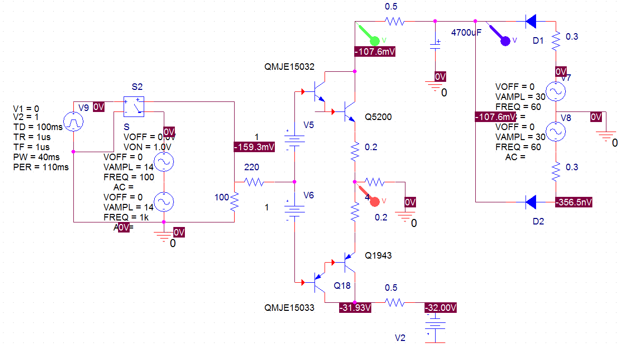

A superb demo Ron. I was wondering if you could on, the SPICE simulator, introduce an 0R5 Ohm resistor on each side from the main smoothing capacitor to the amplifier? These would represent the resistance of the power feed wires to the board (maybe inadequate gauge?) and the resistance of a fuse and its connectors please? I would be interested to see how large the instantaneous voltage drop will be and also if Intermodulation Distortion increases... using say a large 100hz signal and a much higher frequency simultaneously....I guess I'm trying to justify the engineering I put into making an amplifier as "solid" as I can. It would be nice to know if huge copper bus bars that are used in some amps are just a ridiculous overkill

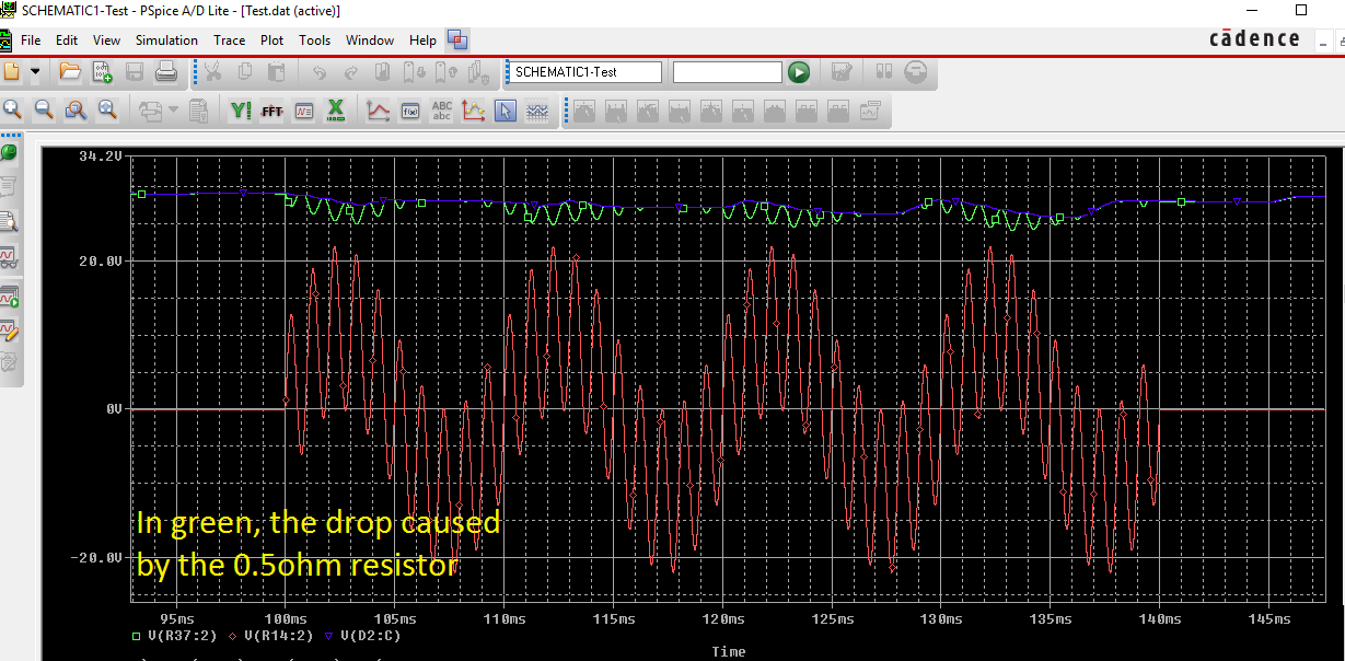

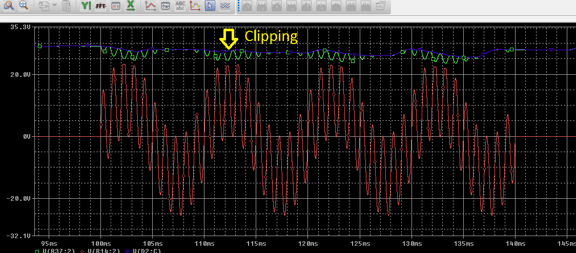

If we introduce 0.5ohm after the capacitors as a way of emulating fuses, cables and connections, you loose considerable power.
A good construction and selection of fuses would not reach 0.5ohm. You have to build with much less total resistance.
Even though you loose power, as long as the output doesn't get close to the rail voltage, there will be no distortion caused by this resistance.
You can decide to increase voltage and be more relaxed with resistances (less efficiency) or you make the resistances smaller (more efficiency).
But, as an exercise, let's see the results with this scenario with 2 sine waves 100Hz +1kHz superposed.

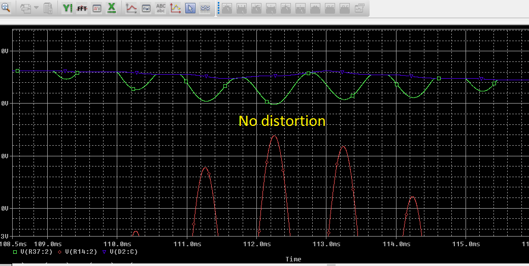

In this example, using 4,700uF plus 0.5ohm, you drop from 83W maximum to around 59W without distortion.
Max power 59W - no distortion.
If pushing power a little bit to 64W, you get wave clipped.

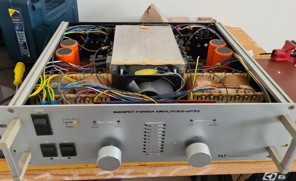

About real world, here's an amplifier I built in the middle of 90's and still works fine, although I don't use it - too much power for me now that I'm older.
It delivers around 400W per channel @ 4ohms and can be operated continuously with sine wave for hours - this was the intention at that time.
There are no huge cooper bars, I just used regular cables and fuses just to support what needs to be supported ("good enough").
4 pairs Hitachi 2SK1056 / 2SJ162 per channel.
